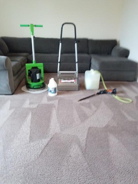

I would have used either VacAway Commercial Magic with Detonator (Peroxide) or DS2 and Punch on a job like that with a fiber pad on Phoenix first to scrub or my Whittaker Trio then a Microfiber Bonnet to extract
But Mark uses Saigers 2x with Oxy with a Microfiber Bonnet to scrub and then Cotton Bonnet to extract
LESS water MORE agitation !!!
