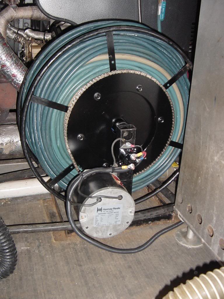

I did this with my solution and vac hose reels. Parts from Hanny Reels and local farm store. MotorizedHoseReel004_zps4a4c7ef4.jpg HoseReel003-1_zps025e6438.jpg

Three years ago I paid $310 for the 2 sprockets and motor from Hannay. A 12volt solenoid, wire, & chain from farm store and foot switch from Grainger was probably $75. I just welded a couple pieces of metal with slotted holesfor chain adjustment across the a-frame of the vac reel. For the solution reel I purchased a used motorized Hannay 1526-17-18 , used the parts I needed and resold the unused reel on ebay.
