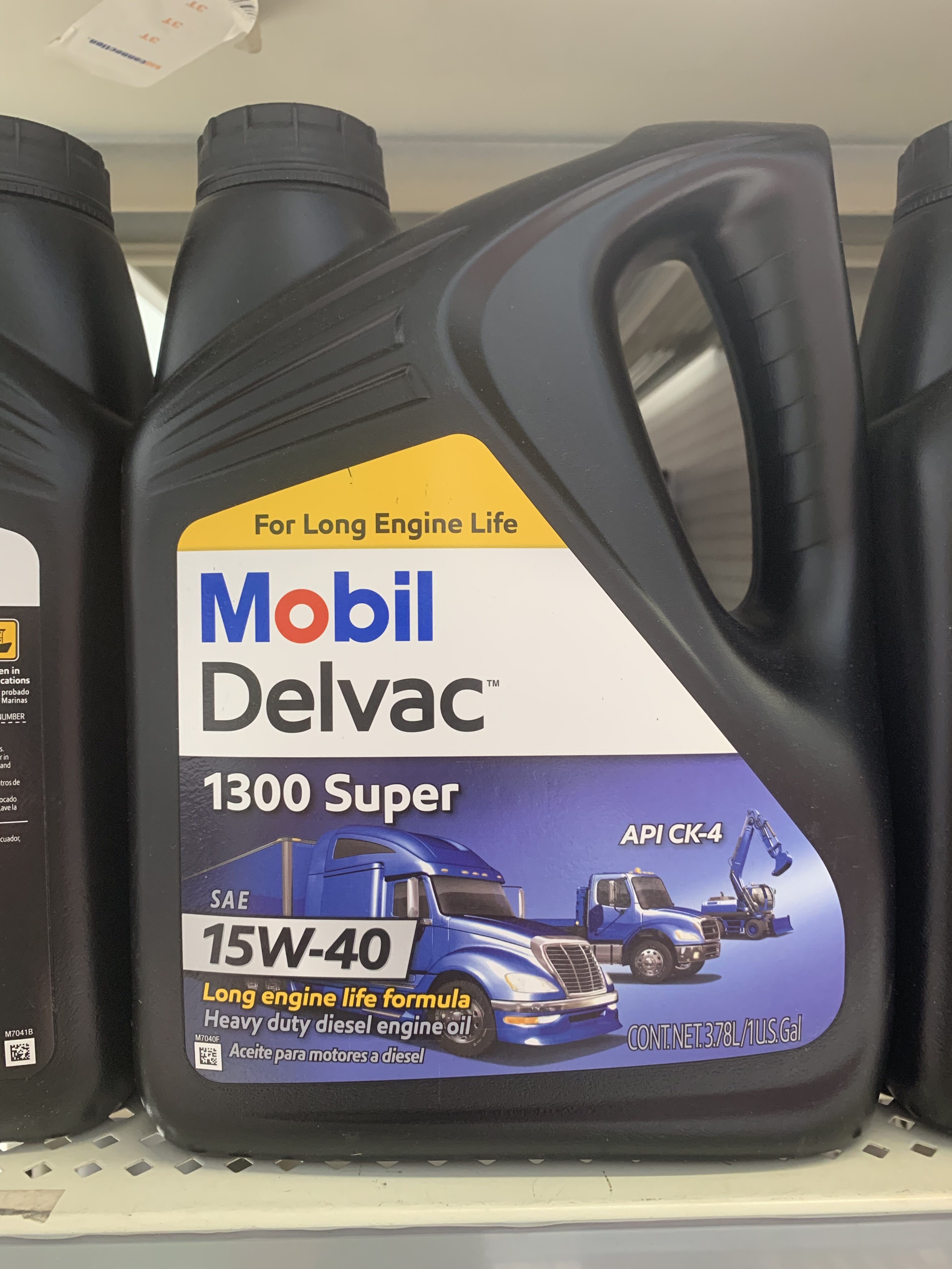

Is this good for 370 water pump

That's motor oil for a diesel engine...

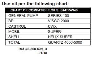

I believe the manual for a 370 recommends 30 weight oil. You should make sure(check the manual), pumps are not cheap!

I bet the manual says 15w40 just like mine did on my Titan. I used 15w40 for over 500 hrs with no problem
