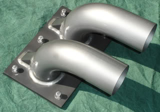

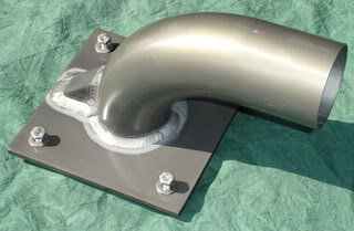

Adding a second 2" port is a PITA, I would just replace my stock 2" with a 2.5" and be done with it. Something like this is universal, 2.5 slips over the outside, and 2" will slip inside, and it howls for airflow as RW pointed out.
or the double:

I think I just came a little.
