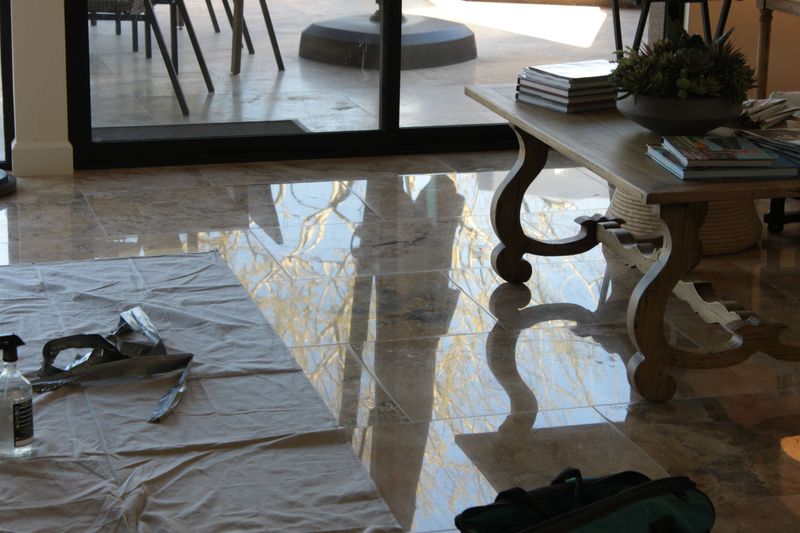

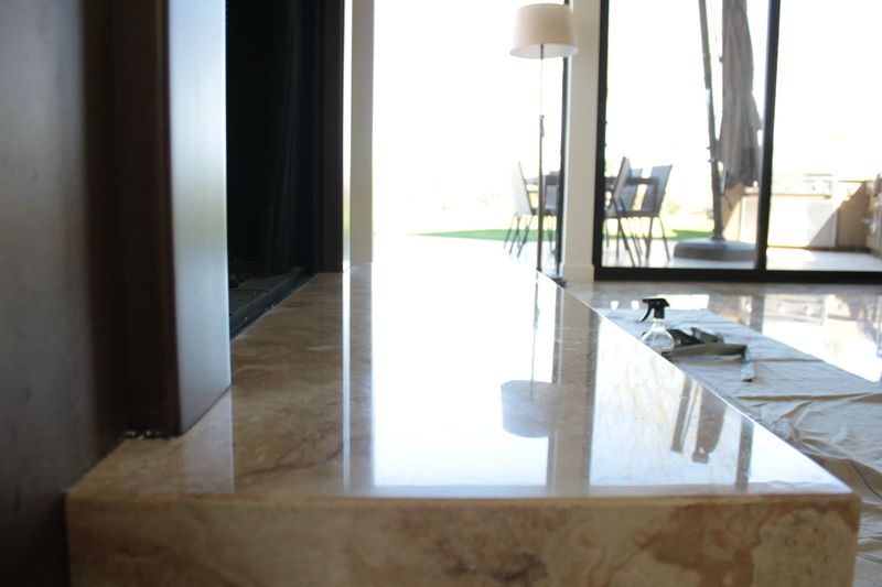

Did this fireplace hearth a couple days ago. My guys are refinishing 3500 feet of travertine in this house, interior and exterior. They told me to go away and leave them alone, but I was able to get this done before being run off.

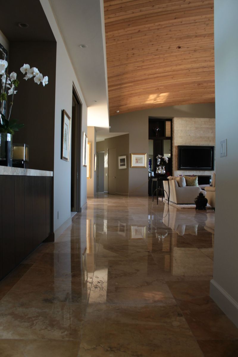

Here's a couple of the floor after it was done. Sorry for the bad lighting.
Feb 5, 2013
527
cameron demille
400-3500 then MB12.
I usually only do the two step polish on limestone or pain in the ass marbles.
