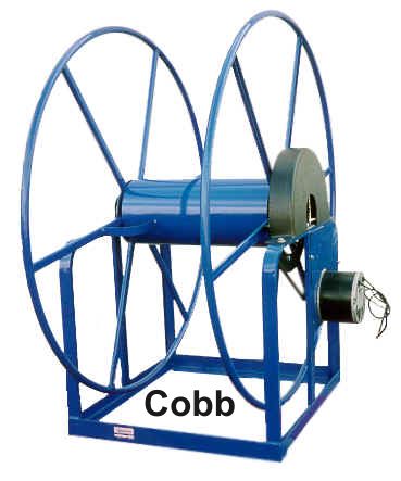

Mine was made for the previous owner for $1,200.00. When I bought his shaft drive unit (A basket case In boxes and pieces taken out of the truck, Now in it's 4th truck.) I gave him $600.00 for all... Mine is controlled by a pressure switch which is long enough to reach the ground in front of the unit so I can step on it and keep my hands free. Sort of copied after the Bane clene reel.

This is the chain drive model that we've used:
You can add one or two solution reels to the left side.

I was wondering if there is something to add to my current reel
Jim Martin
10,877
Jim Martin
sprocket,... 12 volt d/c motor.... a relay and your choice of a belt or a chain and
a handful of common since and you can add to and build it yourself.........
