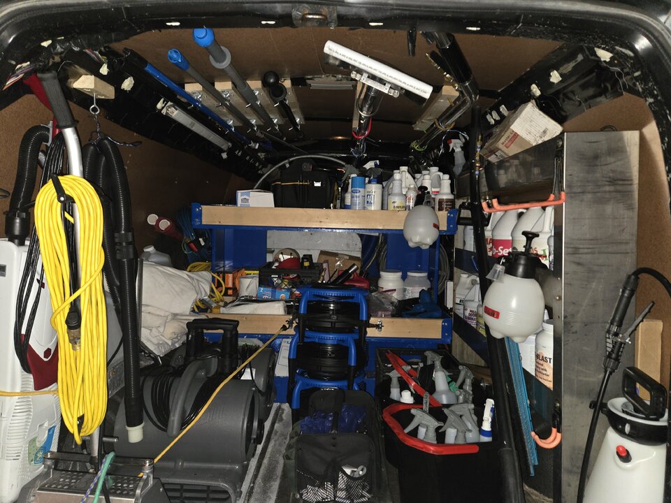

I should've already done something, but up until now I figured I was going to shut down my machine. But the idea of not using it for 5+ months is not a happy thing.

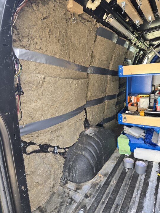

Spray foam requires 75 degrees for the foam to properly expand and insulate, and I need that temp with the doors open. So that's out. I'm thinking of using double faced 1.5" to 2" roll insulation and adhering it with 3m spray adhesive 90 cans. Anyone done something similar to this with their vans?
The floor has bed liner on it. But I'll probably lay roll insulation down underneath and around everything near the power pack and plumbing to reduce cold from the floor...

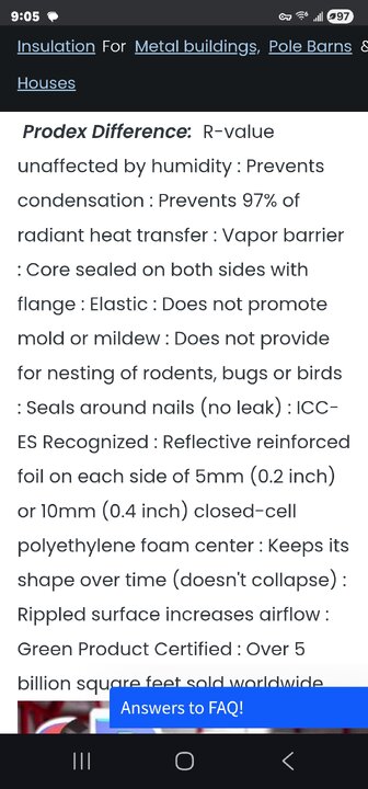

Reflectix bubble insulation is thin and claims a high R value, but part of me feels that something close to 2" thick will do better than some shiny bubble wrap.

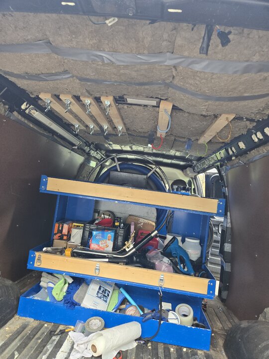

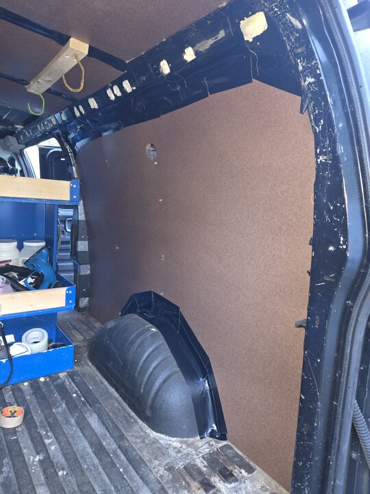

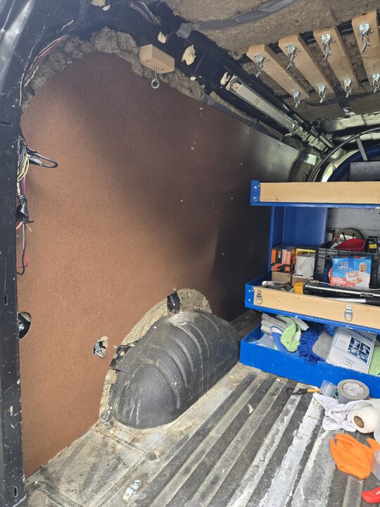

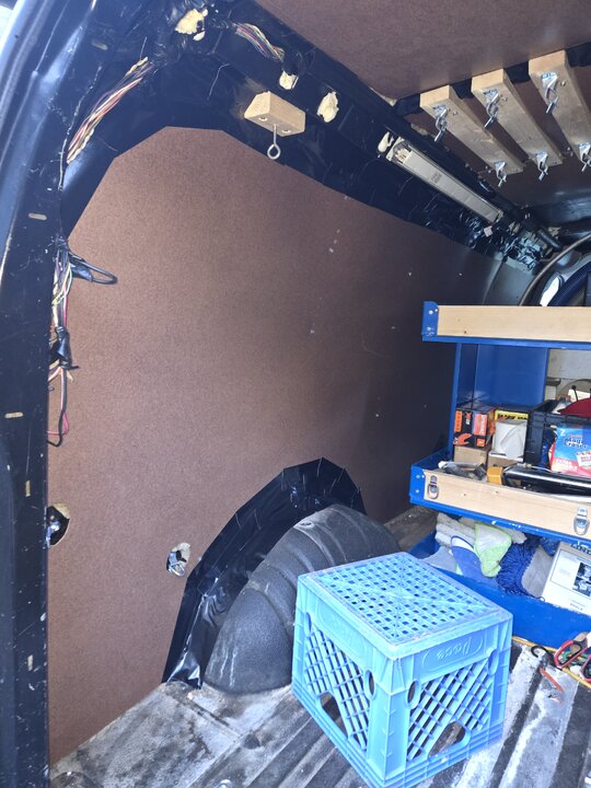

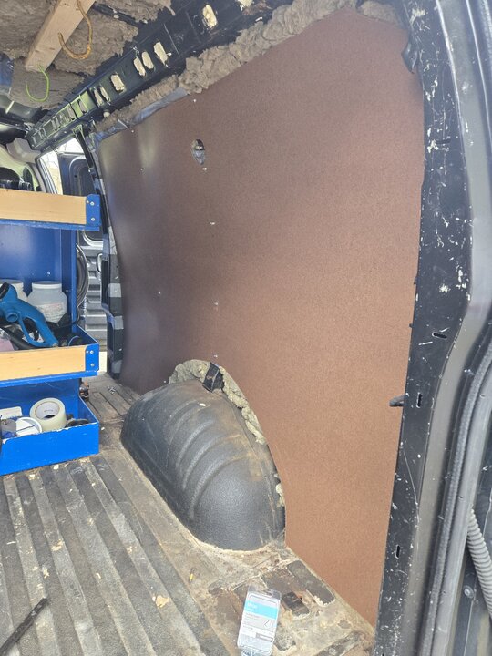

I'm going with rockwool batt insulation covered with masonite screwed into the sheet metal ribs. I think it will look nice, and it is a great insulator. The rockwool is less susceptible to moisture problems than fiberglass. I'll seal all the sheet metal ribs or whatever they are called with expanding foam, and test the roof ones first to ensure they dont push the exterior sheet metal outwards and make it look weird.

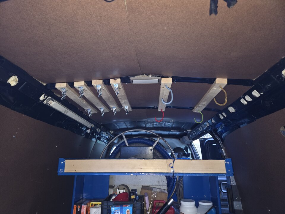

This took me all weekend. Everything takes a long time. There are 2 more sections to do over the waste tank, and I will do this to parts of the doors too. I think it came out good enough. Thanks for saying something about how awful the insulation would look Woody. Thinking about covering it from the beginning helped it all come together. This thing will be toasty warm!
