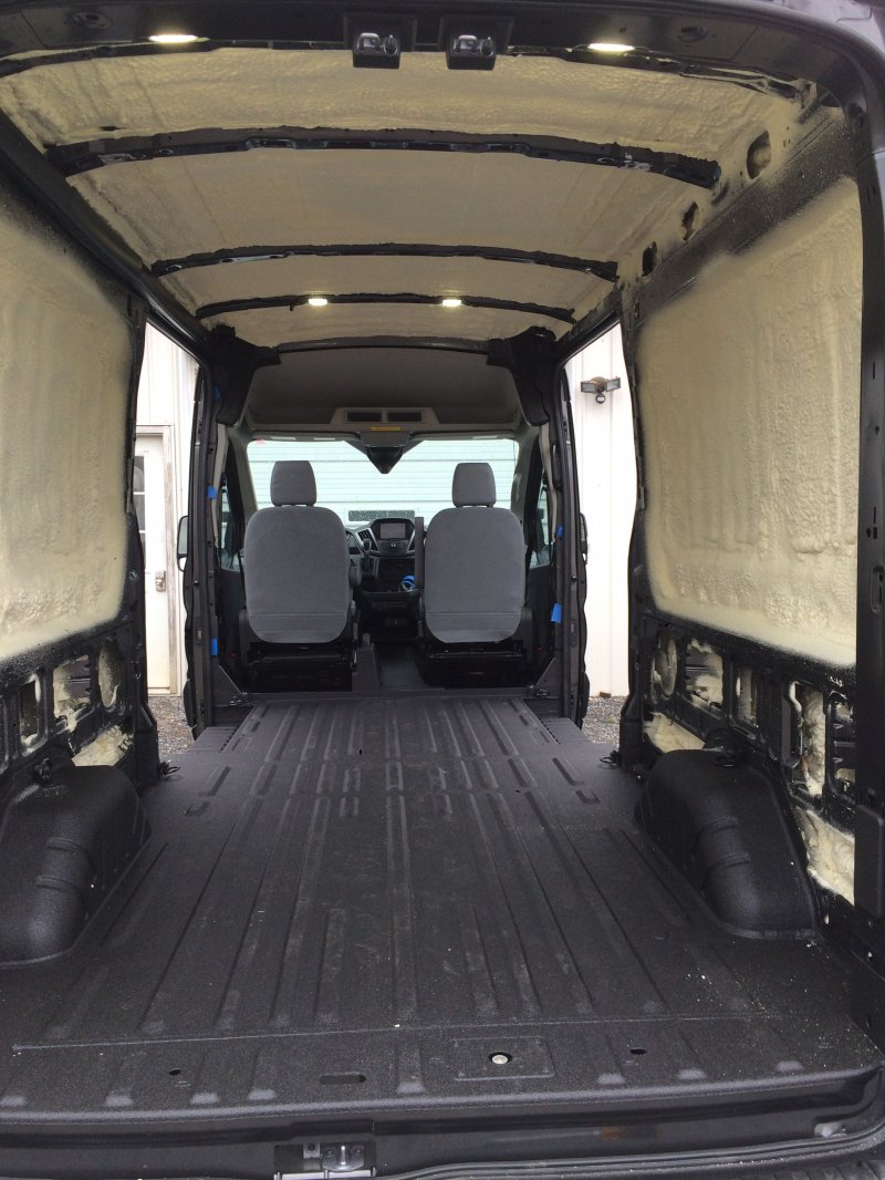

Rhino line the whole thing???????Anybody have any advice on floor insulation?

It will be getting rhino lined or Linexed but I also knowthe floor of the van can get pretty cold when its -10 out. I'd rather take care of it now then wish I had down the road.Rhino line the whole thing???????
I think I would do it the other way, Rhino line, then install the plywood. The Rhino liner is to protect the steel floor from chemical spills. The plywood is to help insulate it.I agree with Lee, plywood then Rino.

I had the floor of my van linexed and then put a VanRug down.it was the best thing I could have done. It's soft so when u go in its soft on the knees and cleans up with a steam cleaning. Also seems to aid in keeping t he van warmer Durning the colder months.It will be getting rhino lined or Linexed but I also knowthe floor of the van can get pretty cold when its -10 out. I'd rather take care of it now then wish I had down the road.
We normally put plywood and then coat it. A barrier between the the seats and coat 2 foot up the walls and out each door.I would be worried about getting moisture trapped between the steel floor and the plywood. I had a ford van that happened like that. I had to reinforce the floor before I sold it. I am sure it wasn't "installed" correctly. I am just thinking that spraying the liner down over the plywood might not seal correctly at any joints and edges. Ideally, if you had the money, it would make sense to treat the floor, then treat the plywood as well.

I removed the OEM floor mat, had the floor and up the walls sprayed, laid down plywood, removed the insulation on the back of mat and reinstalled it. The mat cleans easily and keeps moisture off the plywood.My original plan was to pull the factory liner and Linex it and then put the liner back down but theres a padding underneath the liner that would hold moisture so i'm not sure I want that. I was thinking marine plywood and then Linex because I was afraid the plywood would also hold moisture. But i can see having an issue if I ever get moisture trapped under the plywood. I'm planning on getting 15 years out of this van so I want to make sure I do it right.
I agree... I hope to get many years out of this new unit so I'm trying to think of everything I might ever want.Always hate to see a new machine just bolted into a new naked van, with no thought about proper preparation.
