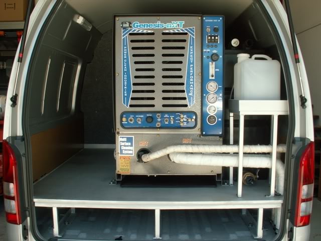

Thought I'd show you guys what we are up to on the other side of the world. This install is a PowerClean Gen 59 into a Toyota Hi-Ace van (a pretty small van compared to what you have over there I know, but we have to work with what we have)
This customer had some unique requests when he purchased this machine and got us to do the install. He wanted something he could simply get in and pressure wash out the back of his rig. Then entire floor is waterproofed and coated in Line-X, as are all the frames and part way up the walls. The frame and waste tank on the machine are all Stainless Steel as well.
We had it colour coded to match the colour of the van also. He wanted a raised floor installed to mount the Genesis to so he could put ladders and other accessories under the floor. The hose reel wasn't in at this stage, but it is a stainless steel reel that can hold 6 lengths, and he wanted it set up with a hide-a-hose arrangement. He also wanted all the exhausts ducted and muffled under the vehicle.

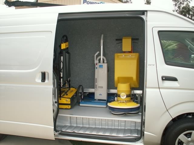

Behind the drivers door, he wanted this compartment just for his larger tools/accessories. You can also climb in through this section and get to the back of the machine/waste tank very easily.

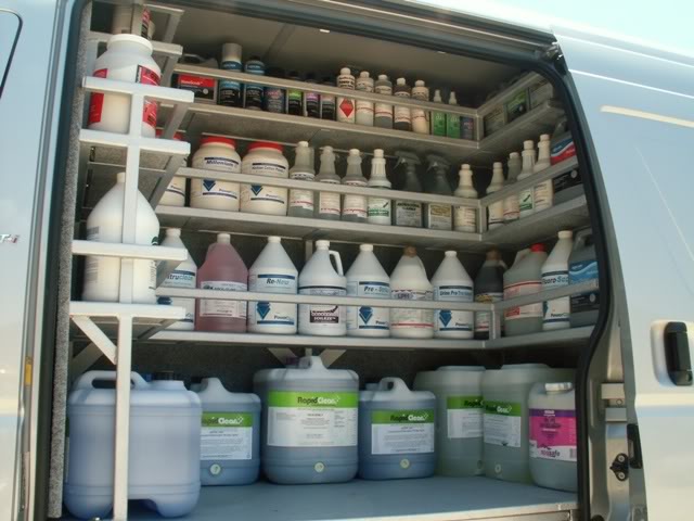

He requested that we build a chemical shelf in the compartment behind the passenger door, that in his words "will hold a tonne of chemicals". Again all this racking is also sprayed and waterproofed by colour coded Line-X. This section also sits on a raised floor.

Thanks for the kind words again John. We would love to play around with larger vans and trucks. I reckon we could pimp out a Vortex nicely :) We haven't made a Cimex ramp for this van yet as the customer has got some other accessories and air movers to go into this section. When he gets everything finalized, we can easily make the ramps for him that suit the final Cimex storage place.

Any chance you can post a picture with the hose reel in? I would love to see how a 300 (6 lengths) hose real would fit in there.
You guys do some awesome installs!!
1 thing I would change is on the chem shelf. It appears there are multiple bottles of the same chems. if you made the shelf straight but deep enough for 2 bottles (open container in the front with replacement directly behind) it would give you around another foot to the compartment behind where the Cimex and vac are.

I will contact the customer and ask him to email me a picture when the hose reel goes back in. He has taken it out to make it electric wind up. Let me tell you though that the hose reel is a very snug fit in there!
You are right, there are multiple bottles there. As we have a bit of a reputation (I am probably biased though :) ) for our nice installs, this customer that purchased this lives 4 states away - about 2500 miles from our office - so after we finished the installation, it gets put onto a car carrying truck and begins a 8 day delivery trip before the owners gets it. We then fly over and run the handover and servicing on the machine.
So I filled up the chem shelf just as an exercise (and to take a photo of it) to see how much chemical I could fit in there before we shipped this rig out to our customer. It had to get shipped completely void of any chemical and anything not bolted down.
Good idea on the shelf though Scott. Thanks!
