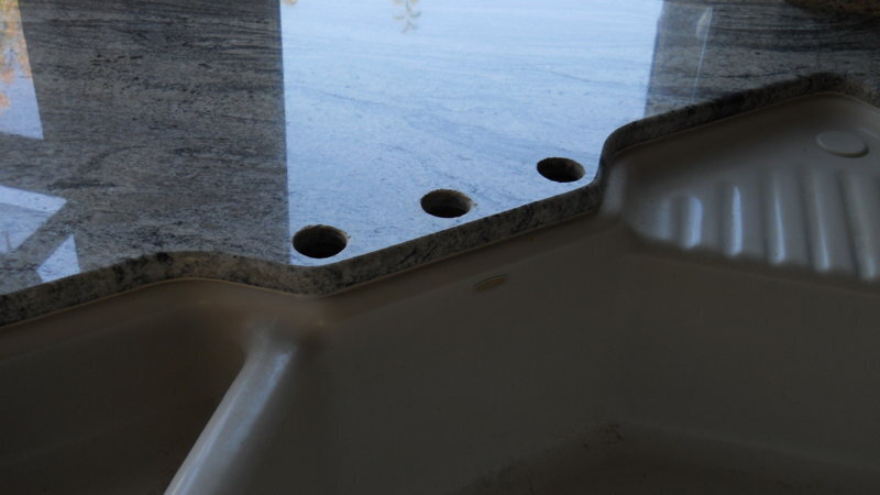

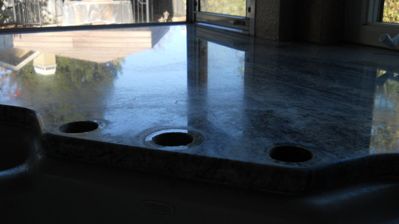

Pretty good article but he left out a very basic and easy procedure as far as removing hard water deposits on granite: razor blades. Here are pics from a job where I scrapped off the deposits, scrubbed with a product similar to Magic Al's glass cleaner, then polished with MB-20

I like your article but diamonds are way faster and easier to use. This video is shot in real time.
