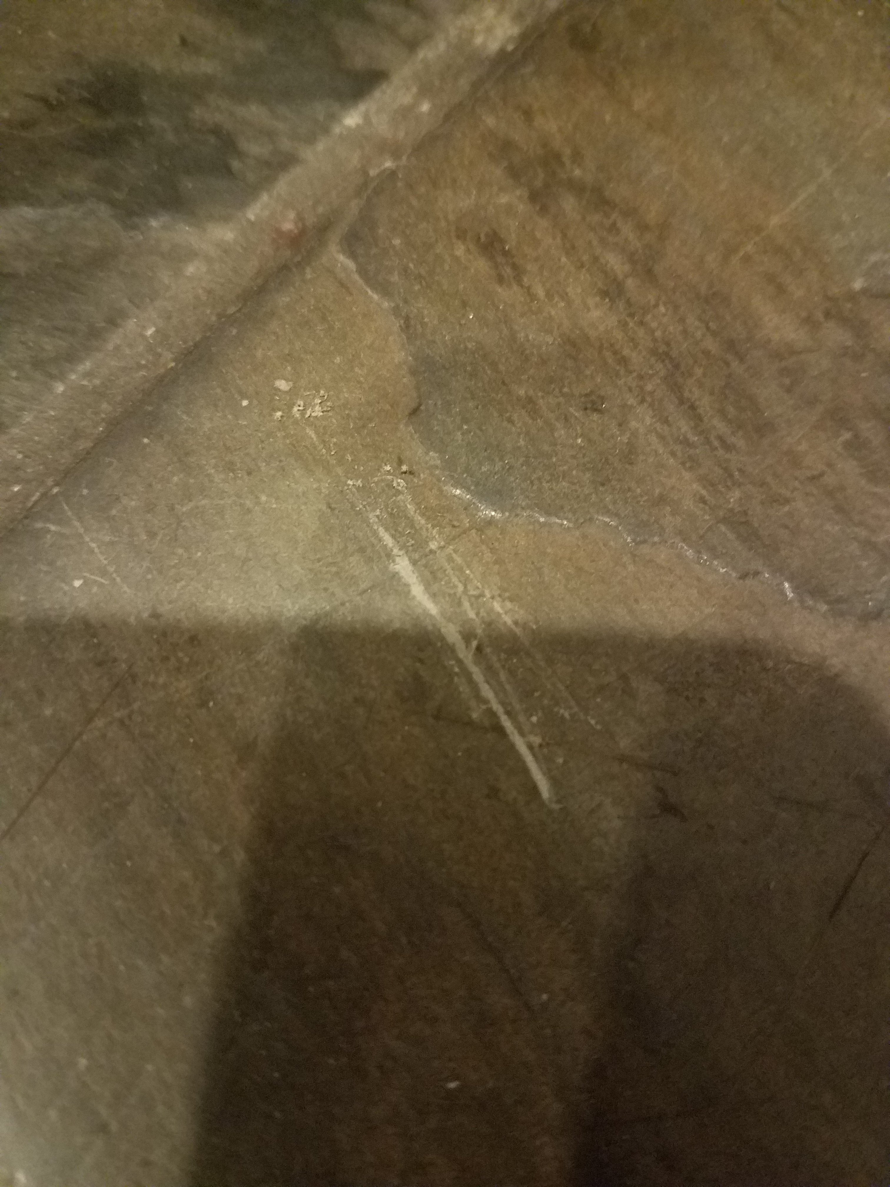

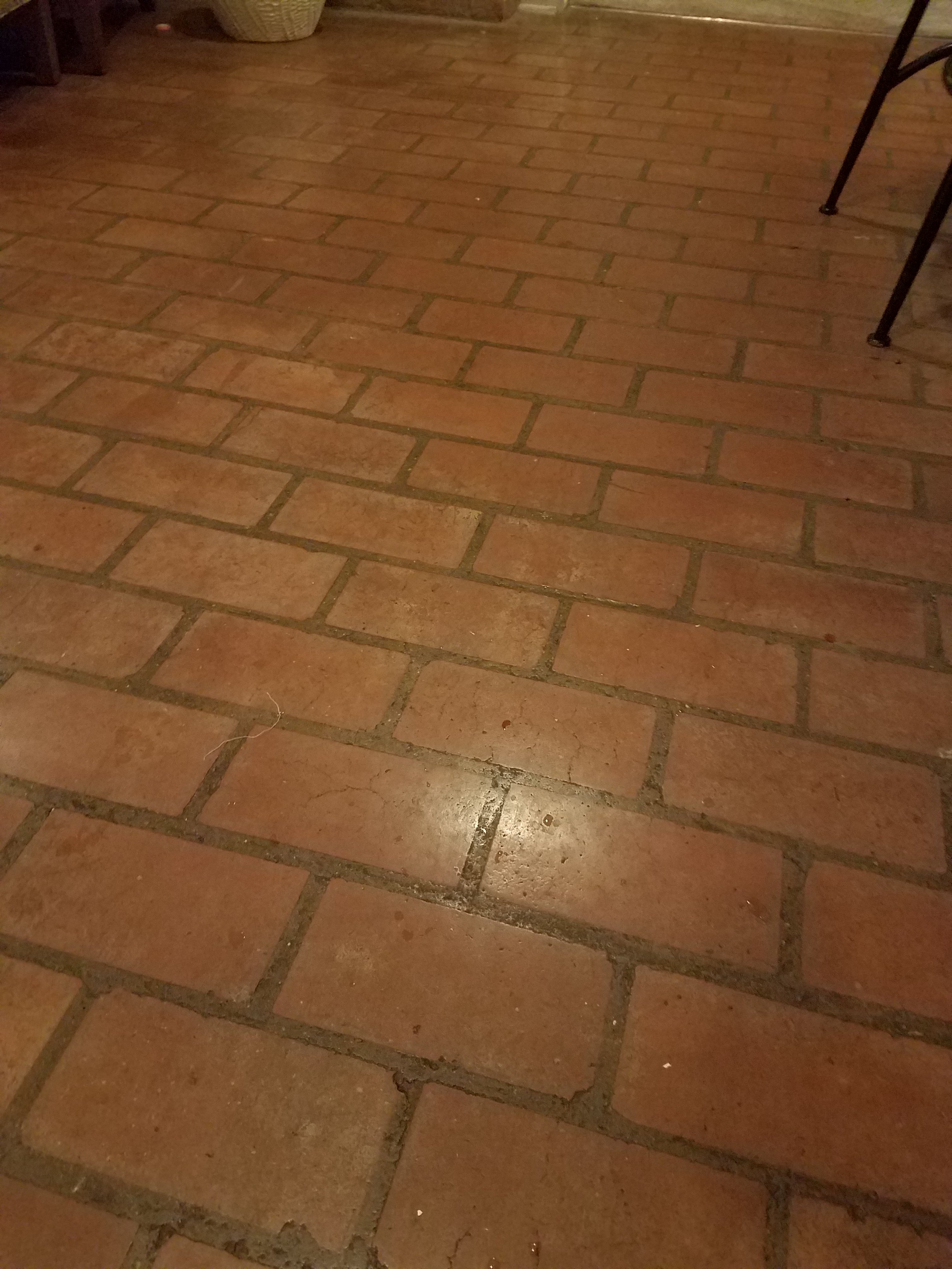

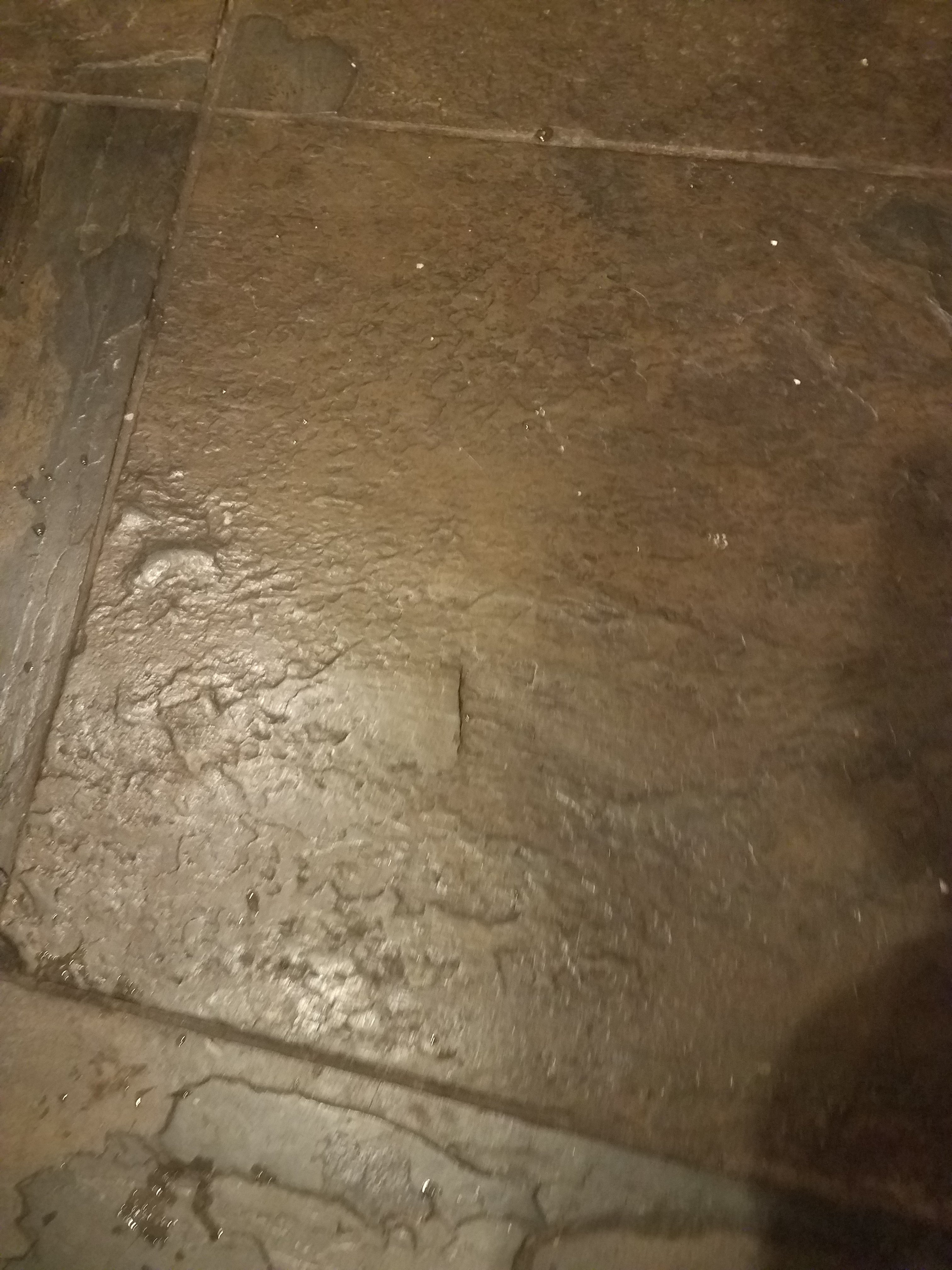

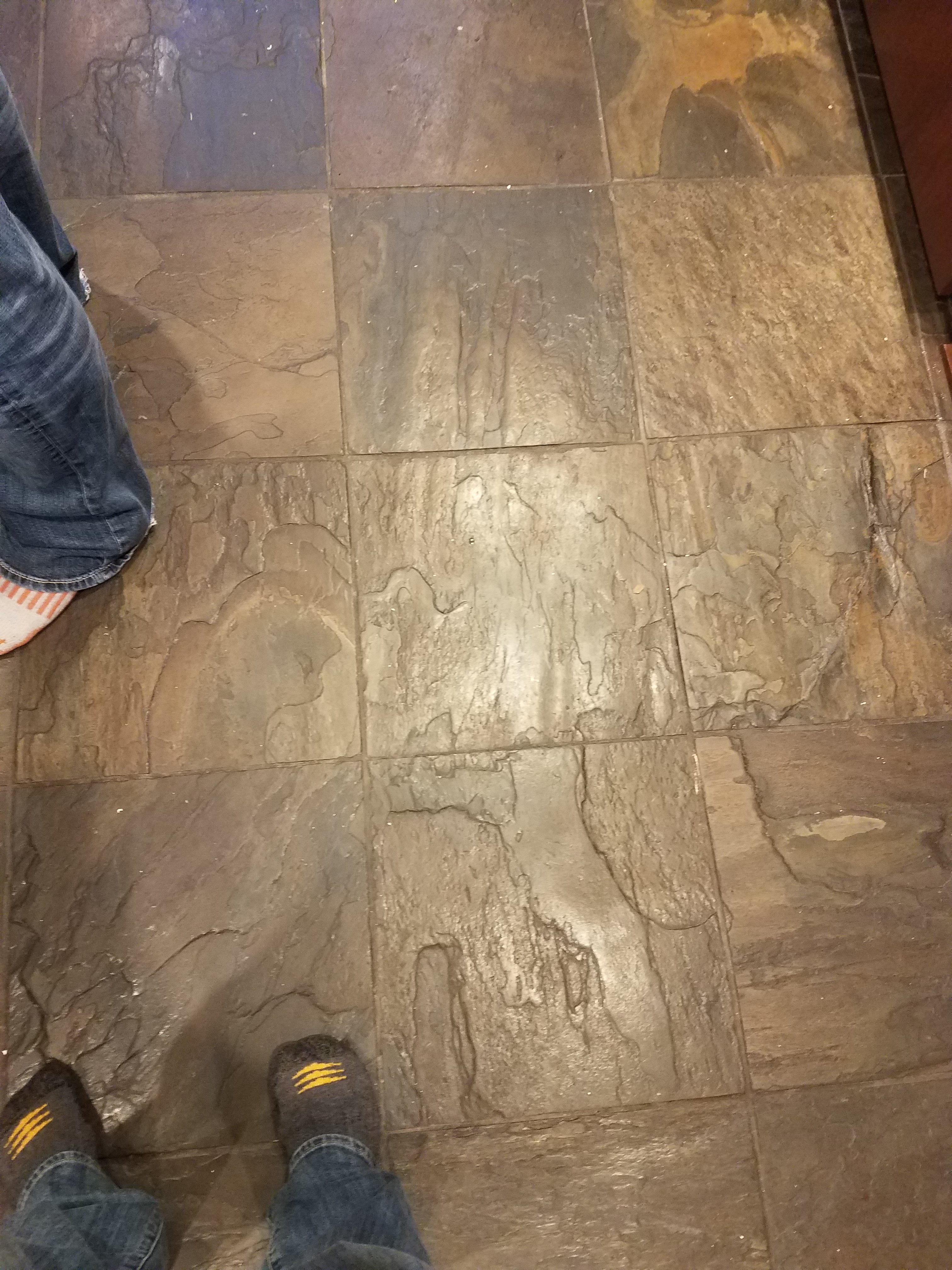

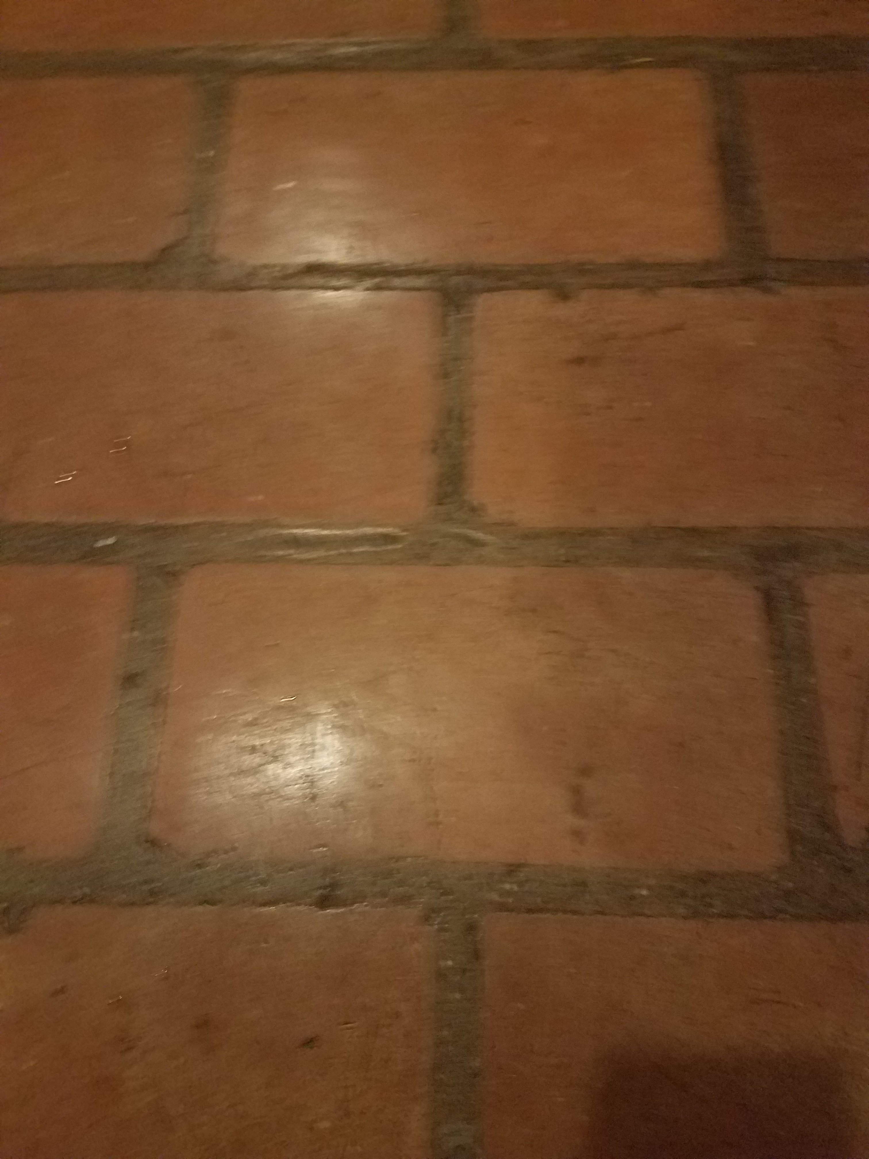

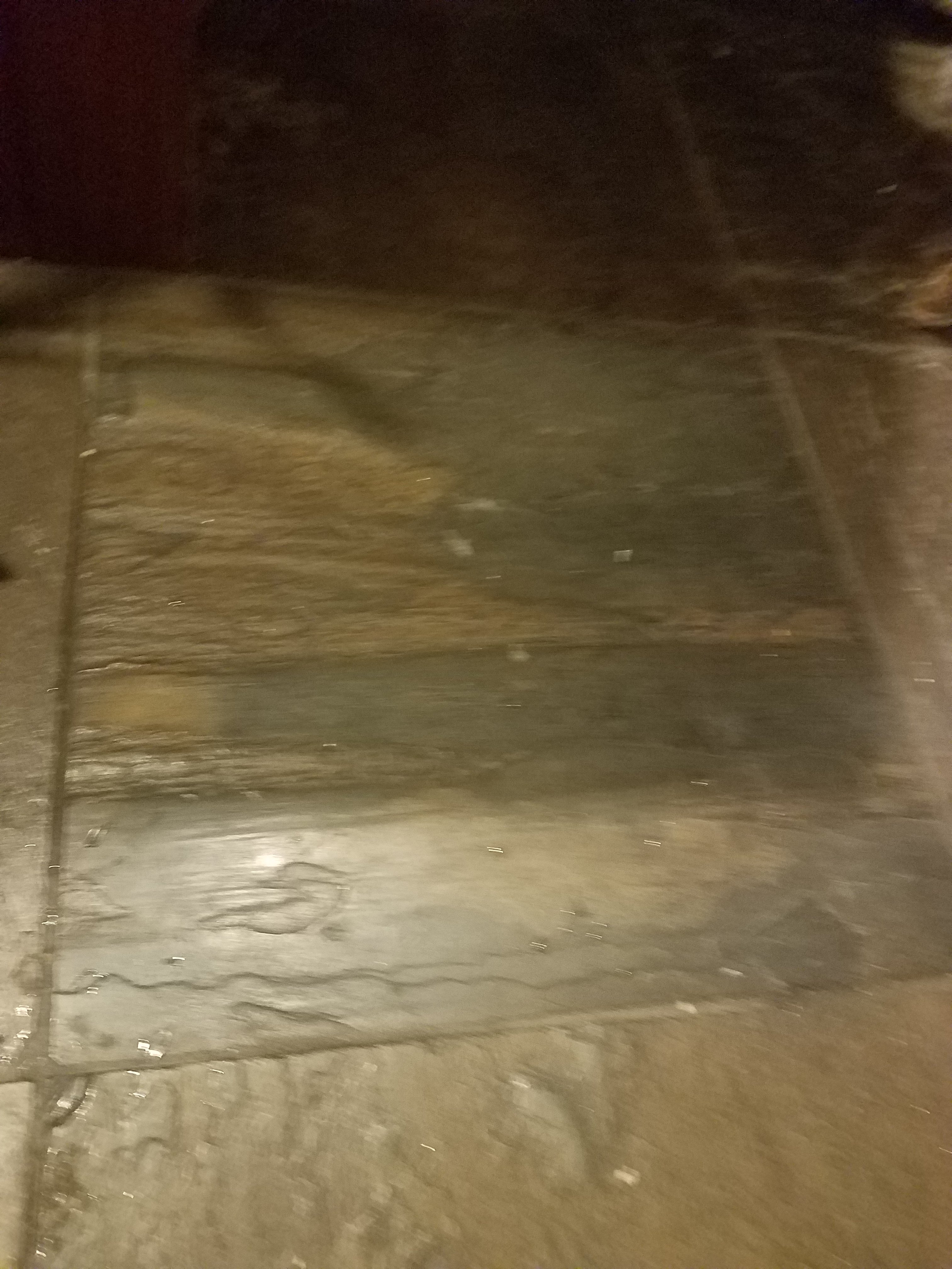

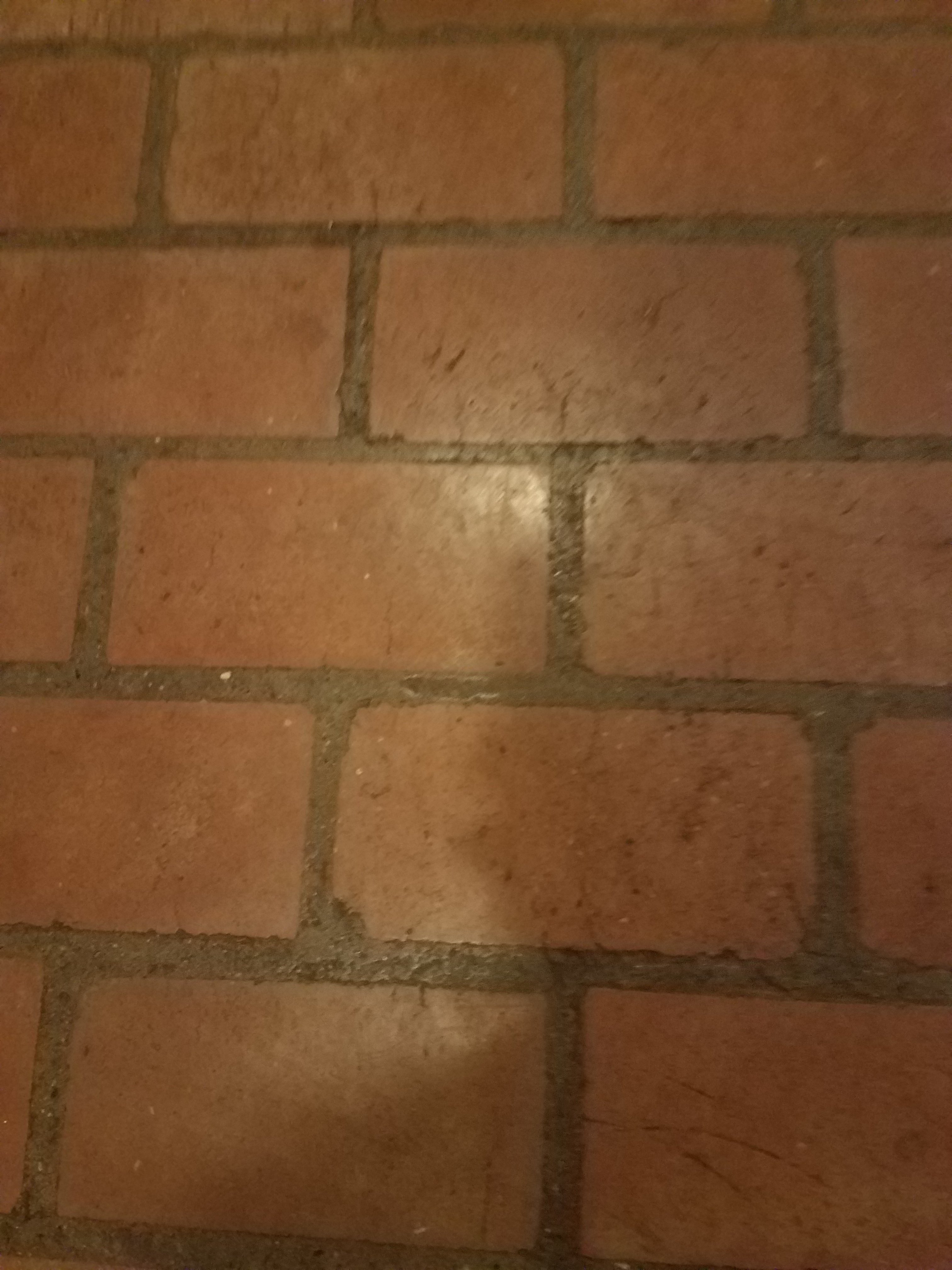

Slate is around 10 years old and the old brick pavers are from an old street in Helena MT. I believe the brick is clear coated with poly. Not sure about the finish on the slate. Owners said only Bona's been used. What are your thoughts on prespray and PSI? I only have a spinner and I'll be using my TM.
116,041
Slate is just about the best stone to use a CRB on, if you dont have one, use a push broom to scrub in an alkaline carpet pre spray. Get giggy and go to town in a few directions.
Same with the brick.
700 psi and dont let the spinner sit in one spot or you'll power etch a ring into the surface.
You can raise the pressure 1 or 2 hundred on the brick but lower the heat to well under 200°
Seal the slate with a solvent impregnator after its dry.
Even Marty could do this.
