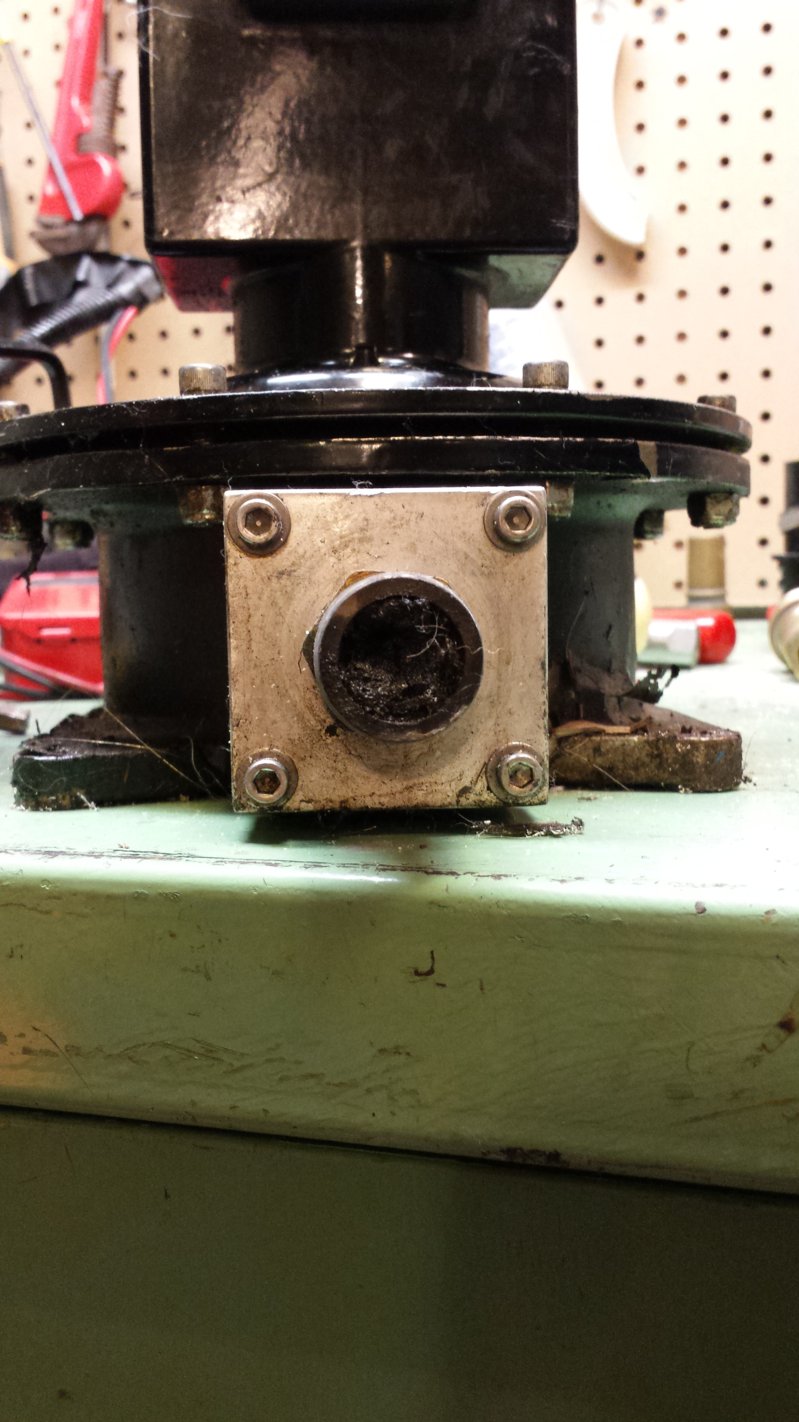

Anyone have any info on this APO?
A
Able 1
I want to rebuild this thing,and there isn't any sticker as far as who makes it..
TConway
Jan 18, 2013
1,193
Thomas Conway
If the motor is still working, I would suggest just giving it a good cleaning. The rubber diaphragm could be ripped, or it could just be the check valves it should have one on each side, they work together to keep the water pumping out, from the amount of debris in the pic, they could just be stuck open.
These are very simple pumps and work really well, pump just about anything as long as it can make it through the two ports.
I was trying to make one out of a windshield wiper motor...it pumped a ton of water, but just like the one above it hadf a pretty good surge as it works so you might need to place something on the hose to keep it where you place it.
Awesome pump out you will be happy once you get it going.

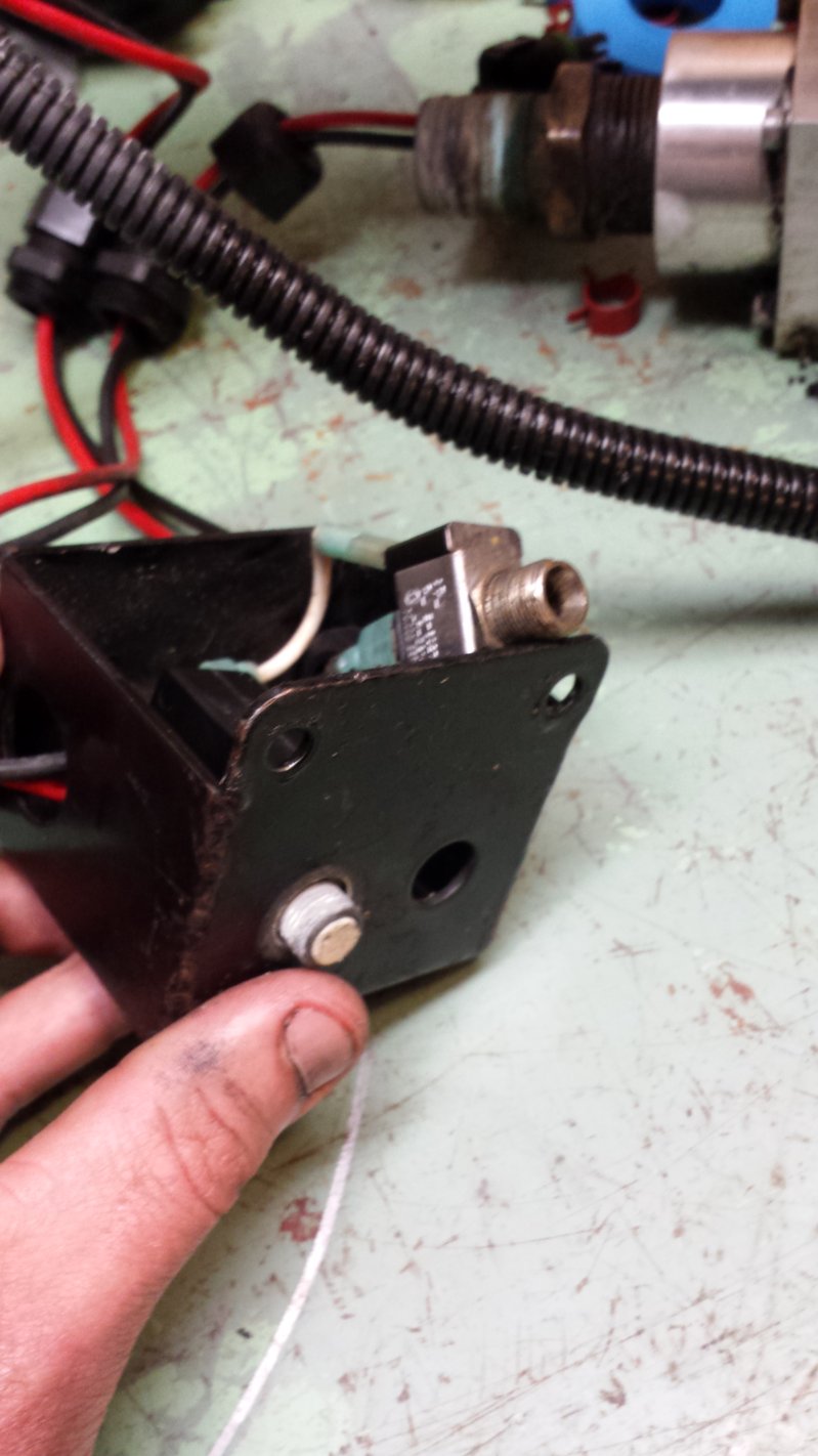

So, breaker and on off toggle switch? What is the breaker set at?
9,756
Dude, stop biting your nails...... And clean them, I can't stand grease on/under my nails....... Wear gloves..........No glove, no love.....
Signed finger banger.......:clap:
Reactions: Able 1
D
dgardner
That pumpout was used on the Avenger 600 (among others) and the wiring diagram shows the breaker as a 20A.

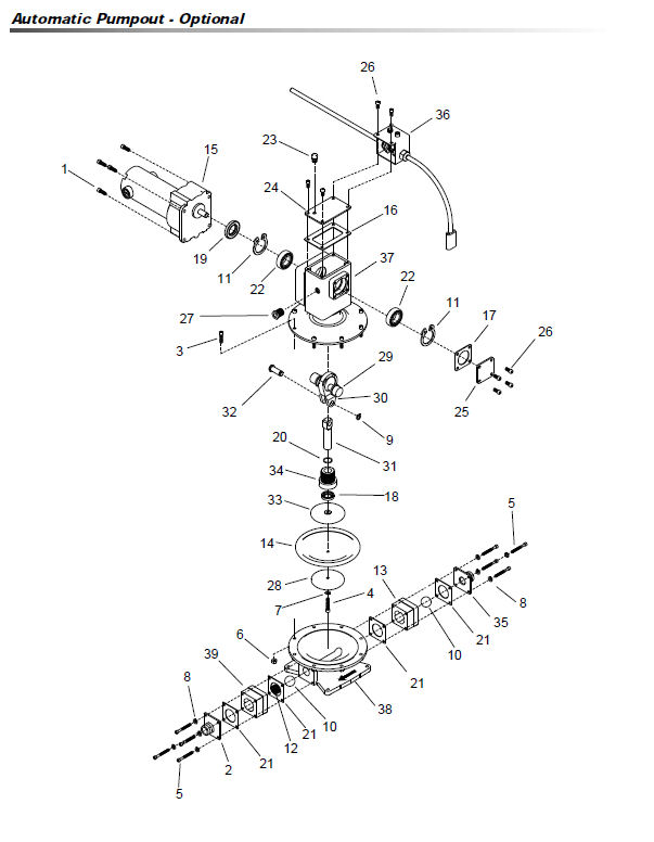

found this video on youtube. keith, it looks like the one you have. how much are you asking for it after rebuild???
