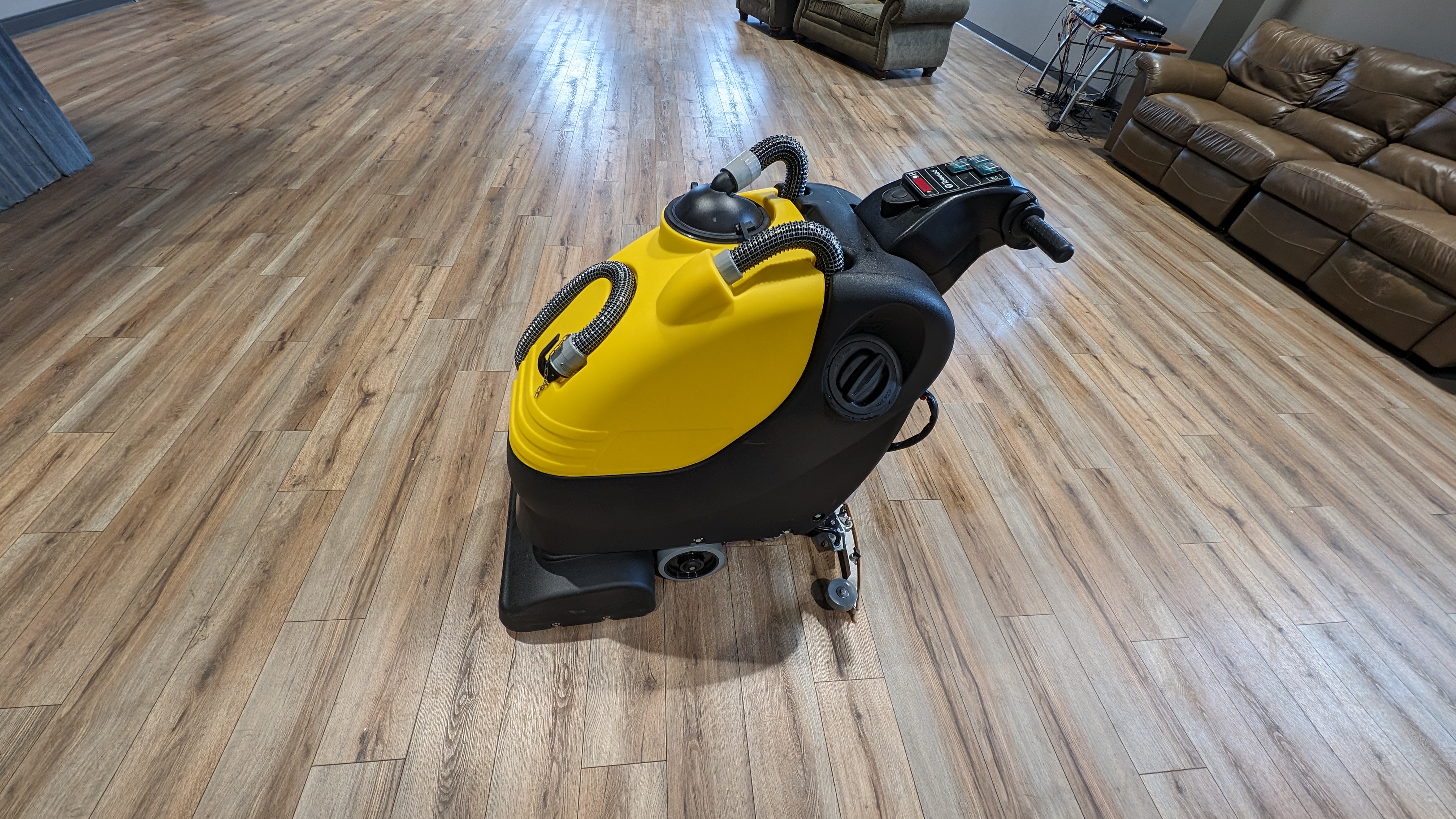

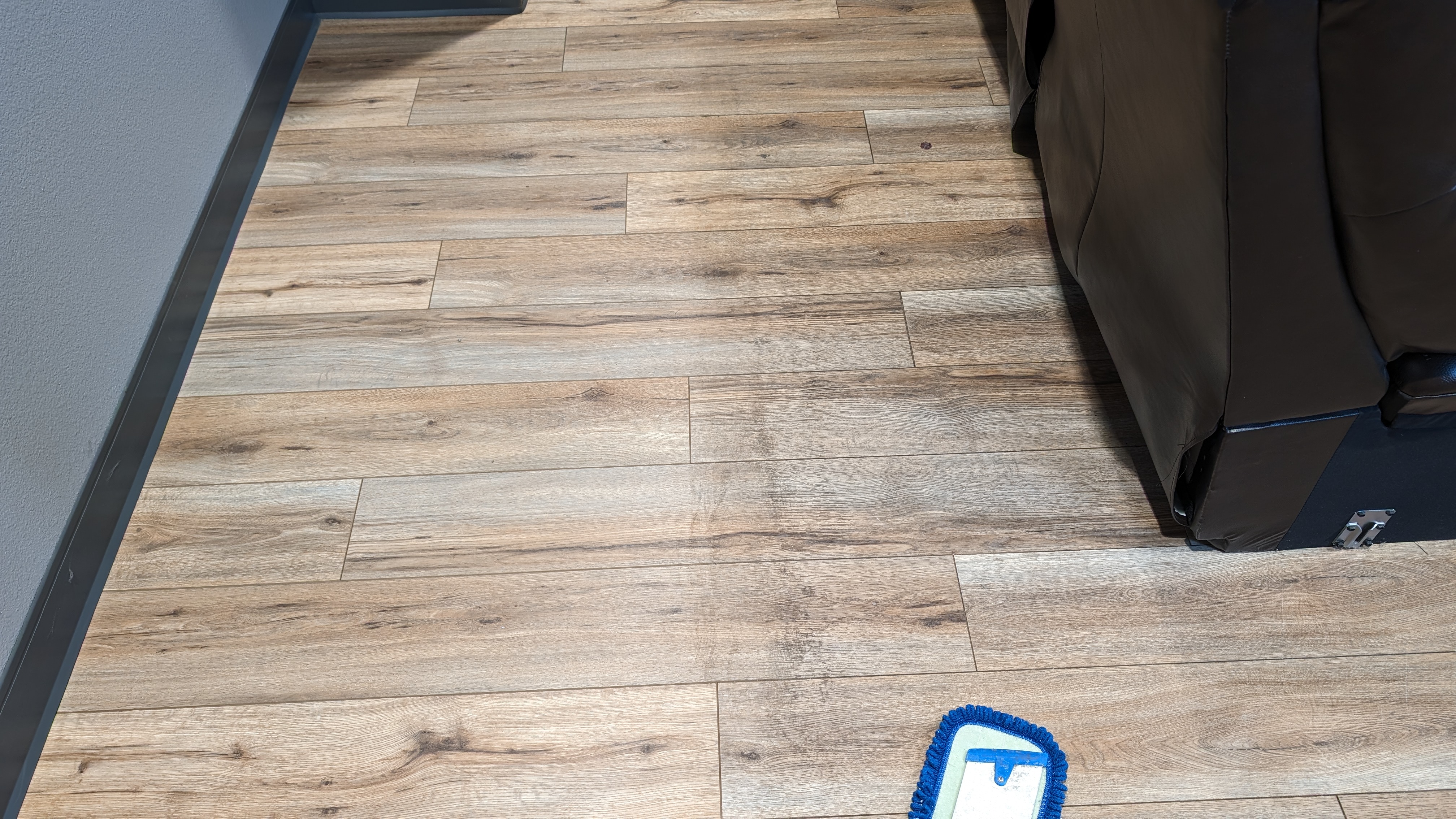

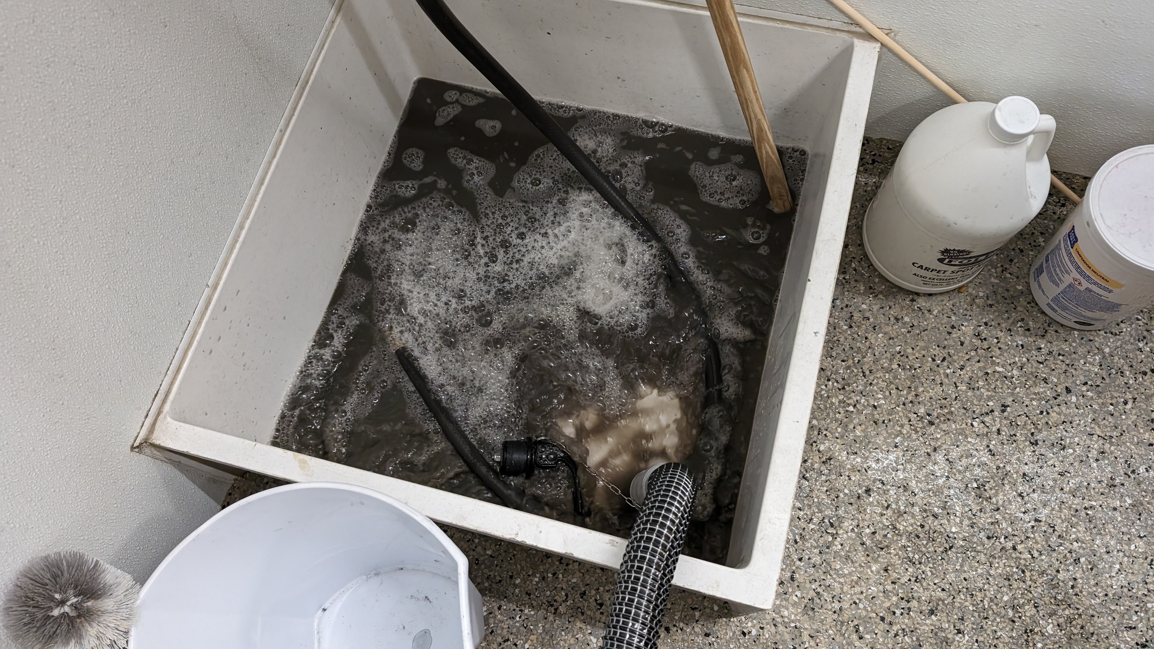

It's been 10 plus years since I've used an AutoScrubber..
This LVP floor at my church could have been "wanded" but I chose to try their walk behind for the sake of evaluating the process.
Edges, nooks, around furniture, corners all needed cleaning by hand and the whole project took PXL_20240122_175642256.jpgPXL_20240122_182712987.jpgPXL_20240122_195553106.jpgtwice as long as I if had used my truck out and HS wand..

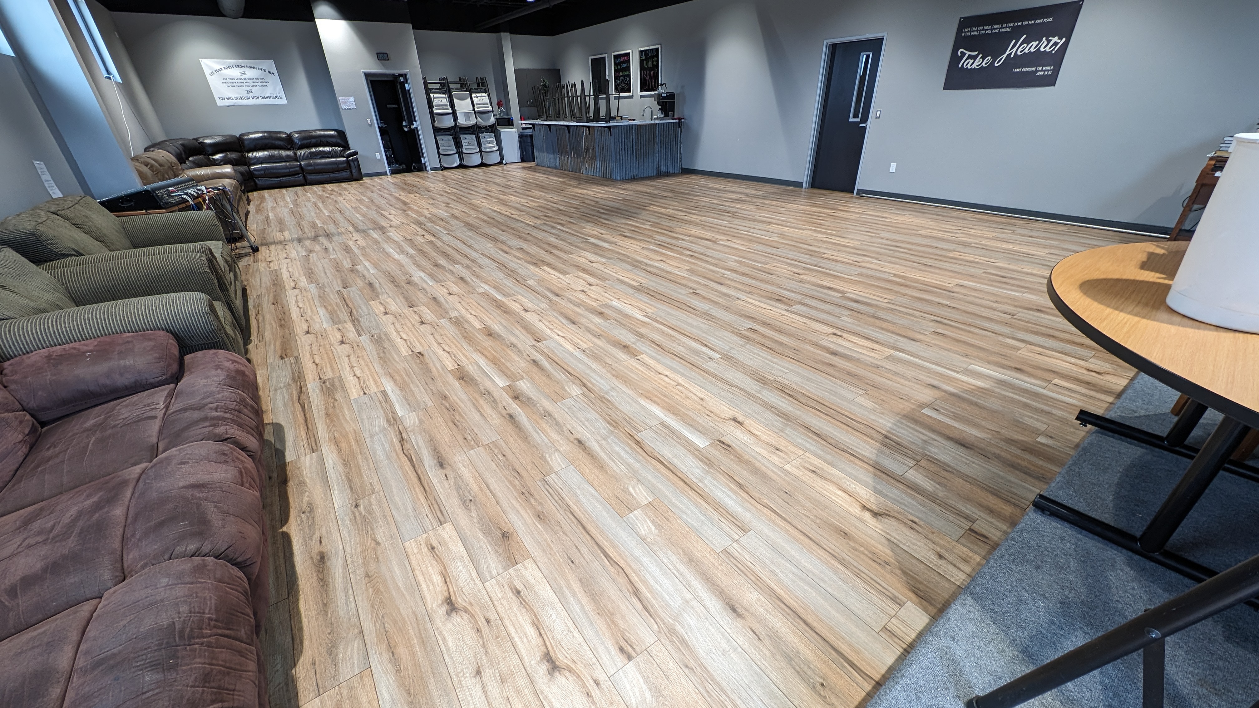

But as you can see, it worked well when I pre-moped an area with a heavy alkaline.. PXL_20240122_200547804.jpg
12,717
Autoscrubbers make sense for regular cleaning and maintenance of larger facilities.
One need only look in the corners and edge in such buildings to see that few of those places ever see the amount of detail work that you performed.
Edges, nooks, around furniture, corners all needed cleaning by hand and the whole project took View attachment 125913View attachment 125914View attachment 125915twice as long as I if had used my truck out and HS wand..
But as you can see, it worked well when I pre-moped an area with a heavy alkaline.. View attachment 125916
Rougly 2000 sqf. ? I'd love to hit it with my Tenant T1 with
IFT from Basic coatings, one tank if solution would suffice, na drying, no wiping, corners debatable. Maybe two hours in very slow pace. I love cleaning wood, laminate or LVP.
Auto srubber is more advanced than I -Robot, but nothing can compare to straight overlap passes of push- self propelled machine
