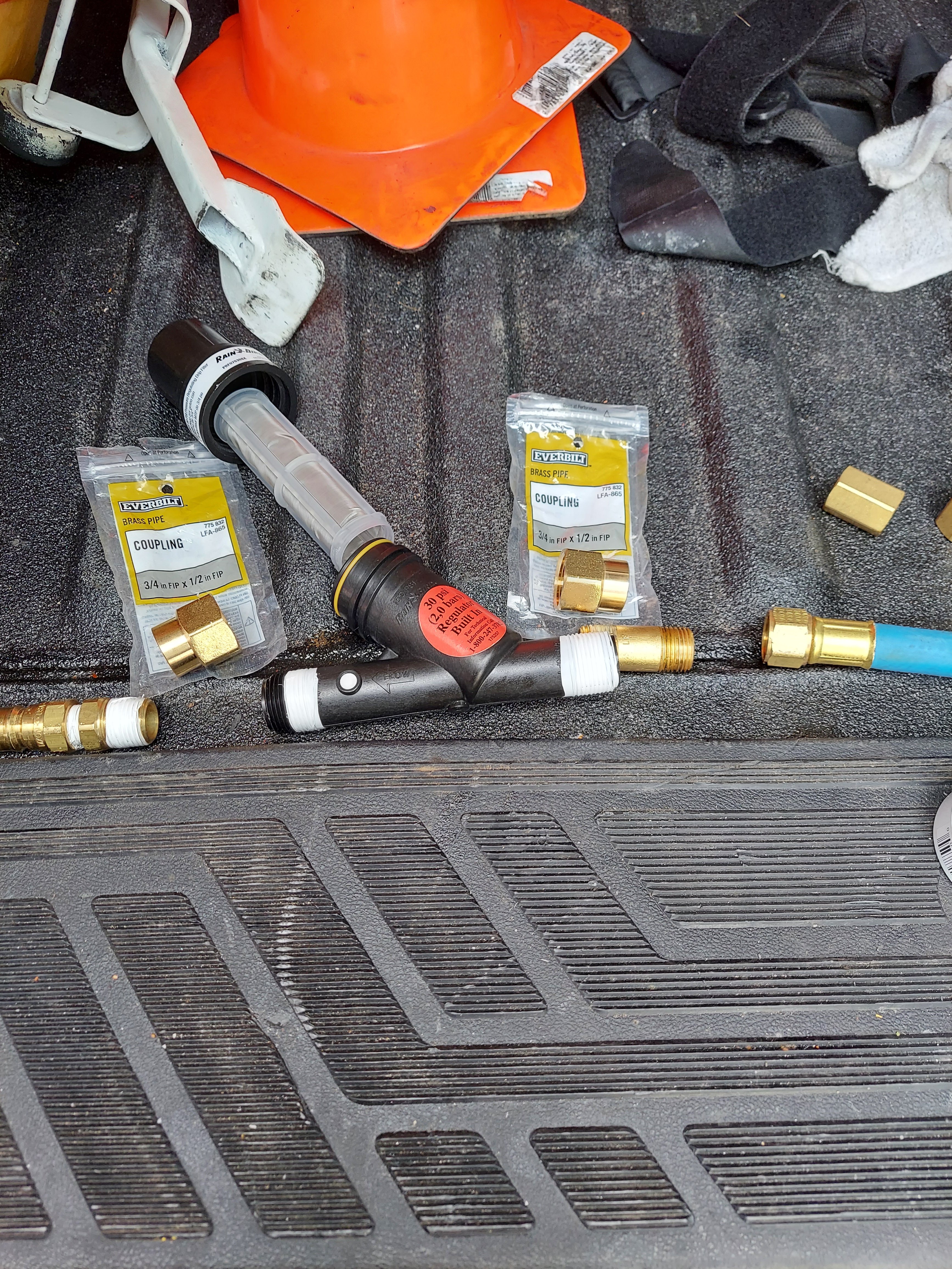

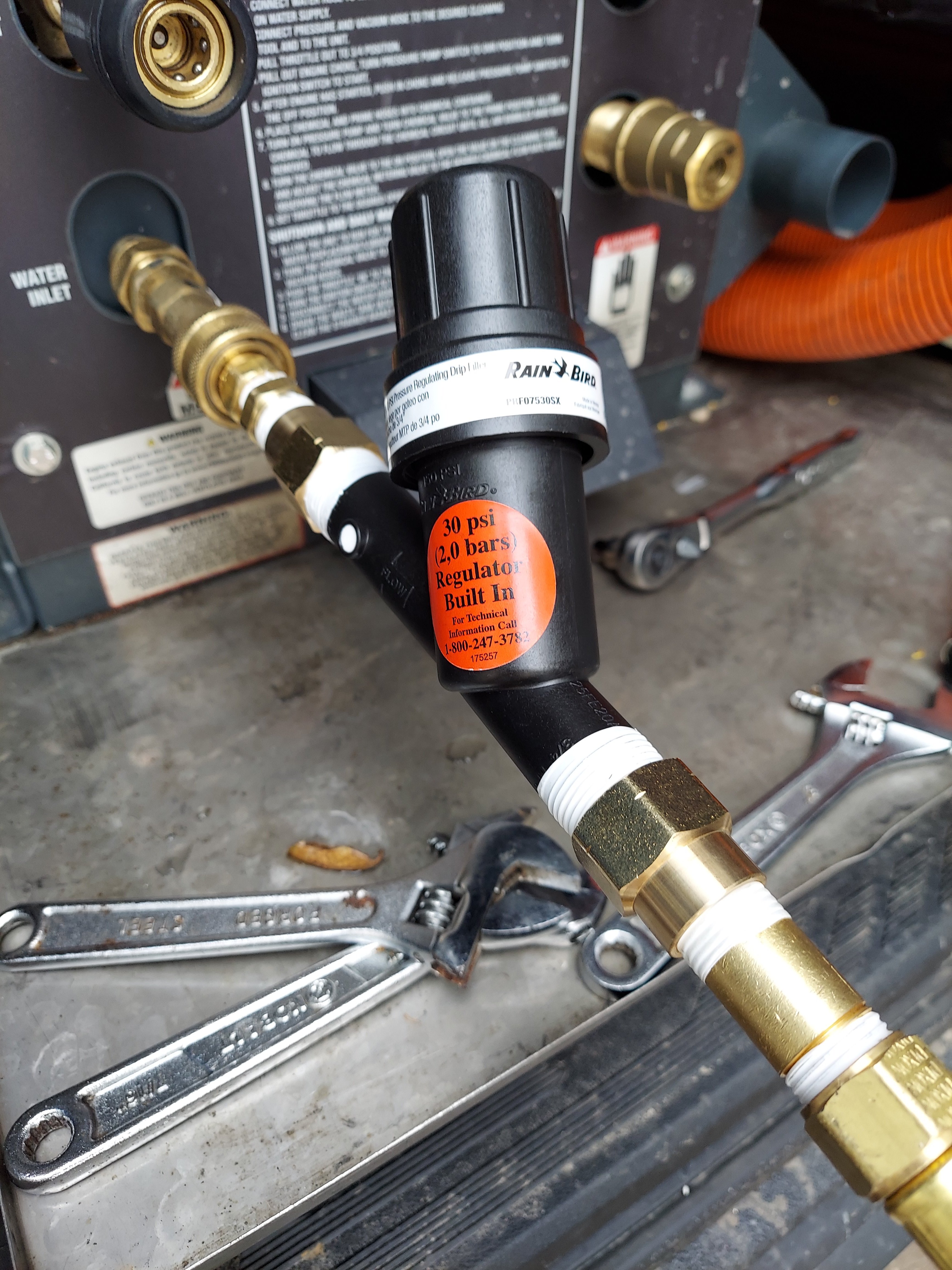

Contaminated and or high pressure water from a customer's can cause issues with the 370 or simular TMs.
This setup is like a Devistator filter for your fresh water if you don't have a fresh water tank setup.
This rainbird inline strainer/regulator has a 200 mesh filter inside and reduces the psi to 30. Ranbird has an additional coupling that could reduce the psi to 25psi if you wish.
