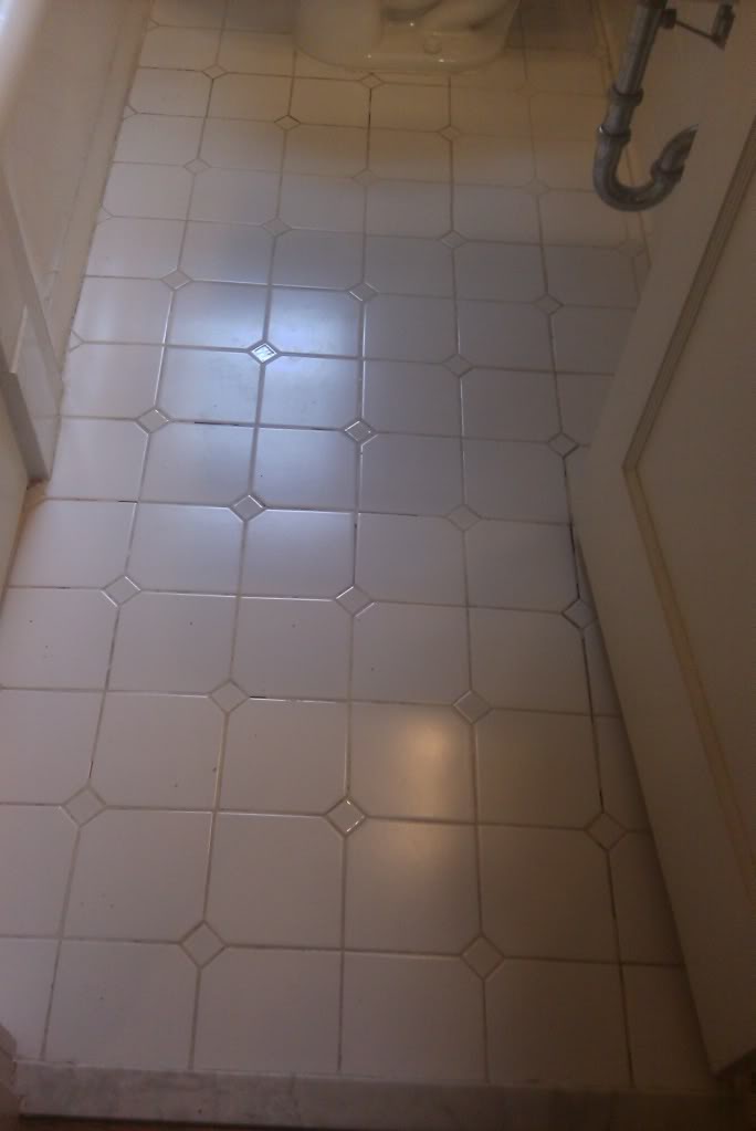

Cool. I need to regrout this floor and caulk the tub.
I am going to watch some youtube videos etc and just start trying to learn all I can.
116,689
add grout, not "re" grout..
dont even attempt to pull that out..

Clean it, add grout as needed (looks like sanded white), color seal all white, recaulk shower. Be sure to smooth out the new grout so thats it's flush with the remaining. That's a good 6-800.00. Myself and assistant could bust that out in ~3.5hours.
Follow the directions and you've just given your customer a brand new bathroom.
PS: Don't sell regrouting work without colorsealing. You will never match the exact color unless they have the original specs. Also nobody pays you to drive around picking up random grout colors (been there done that)
PSS: Caulk the crapper

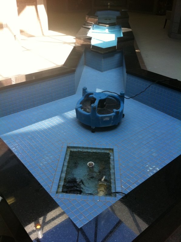

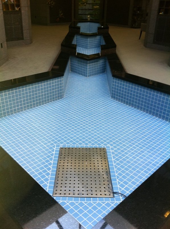

Dan,
I gotta say this is a true before and after picture on this fountain, great job.

Bee Busy said:
nice job Bill...color clad?
It's not my job, It's Dan's job, from his gallery on his site. Some really good work on there.
danbrown
Nov 14, 2006
39
tmdry said:
Haha thanks. Have you ever heard of crypt flies? Next time you are in a mausoleum note the bugs flying around behind the glass of their personal effects. Tombs aren't airtight apparently..... Note that the fountain is an arrow pointing towards the front doors of this tomb. Pretty cool.
That was Grout Perfect. Don't know how its holding up, but guess who they will call to maintain it next time....

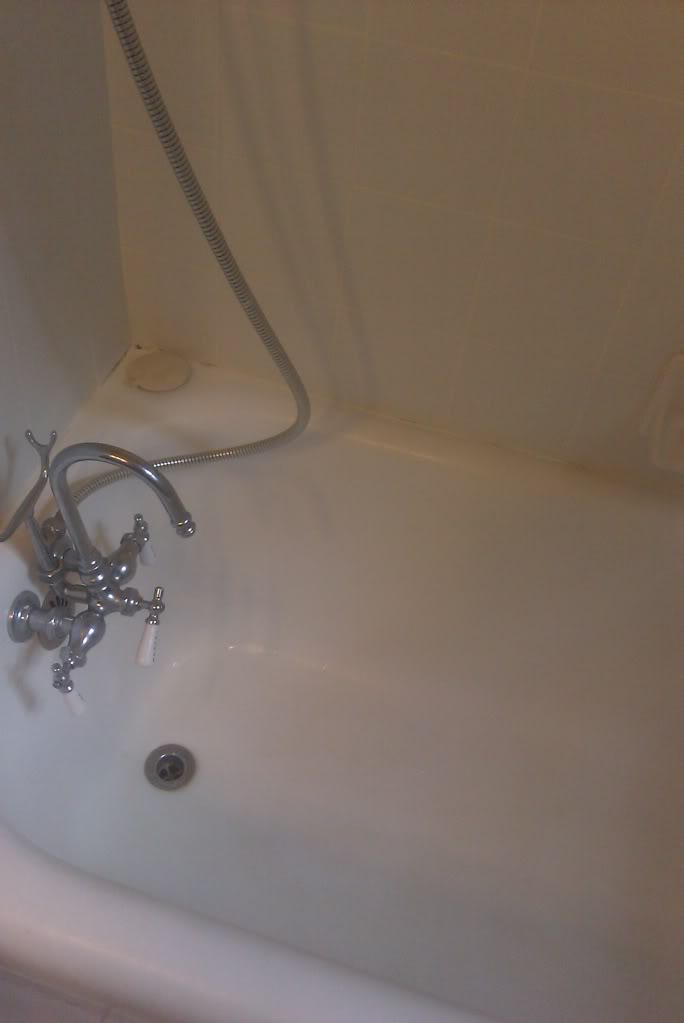

When you caulk the tub, fill it up with water before you caulk.
that's a cool tub, faucet comes in on the tub instead of the wall, when was it built, 1940's?
Not necessary. There's not any movement going on with that tub, I'd put money on it.

Good habits are good habits. You'd be surprised at the difference 330lbs of water makes in spreading timbers supporting a 275 lb iron tub. Gravity works.
