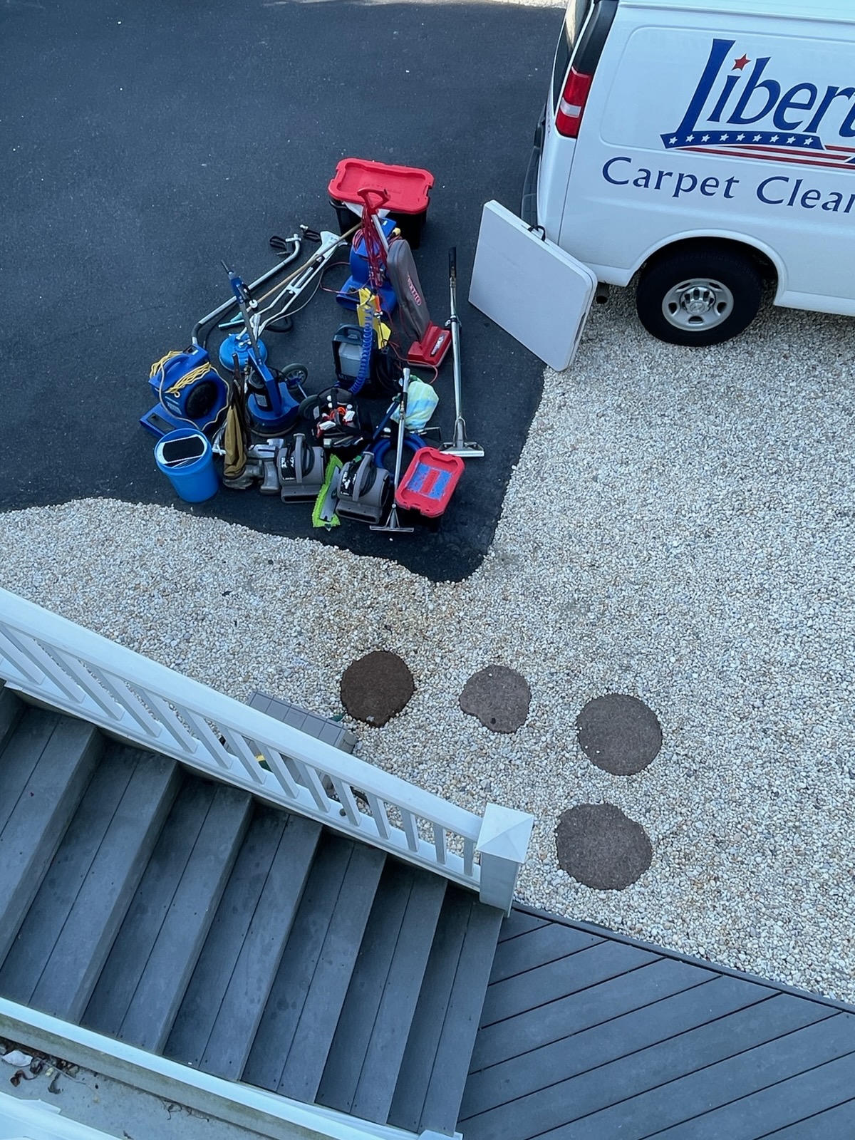

Especially, when you feel the need to get it all out at once.😬😉 A vacuum for each hand😂 Must be a tight schedule 🤣

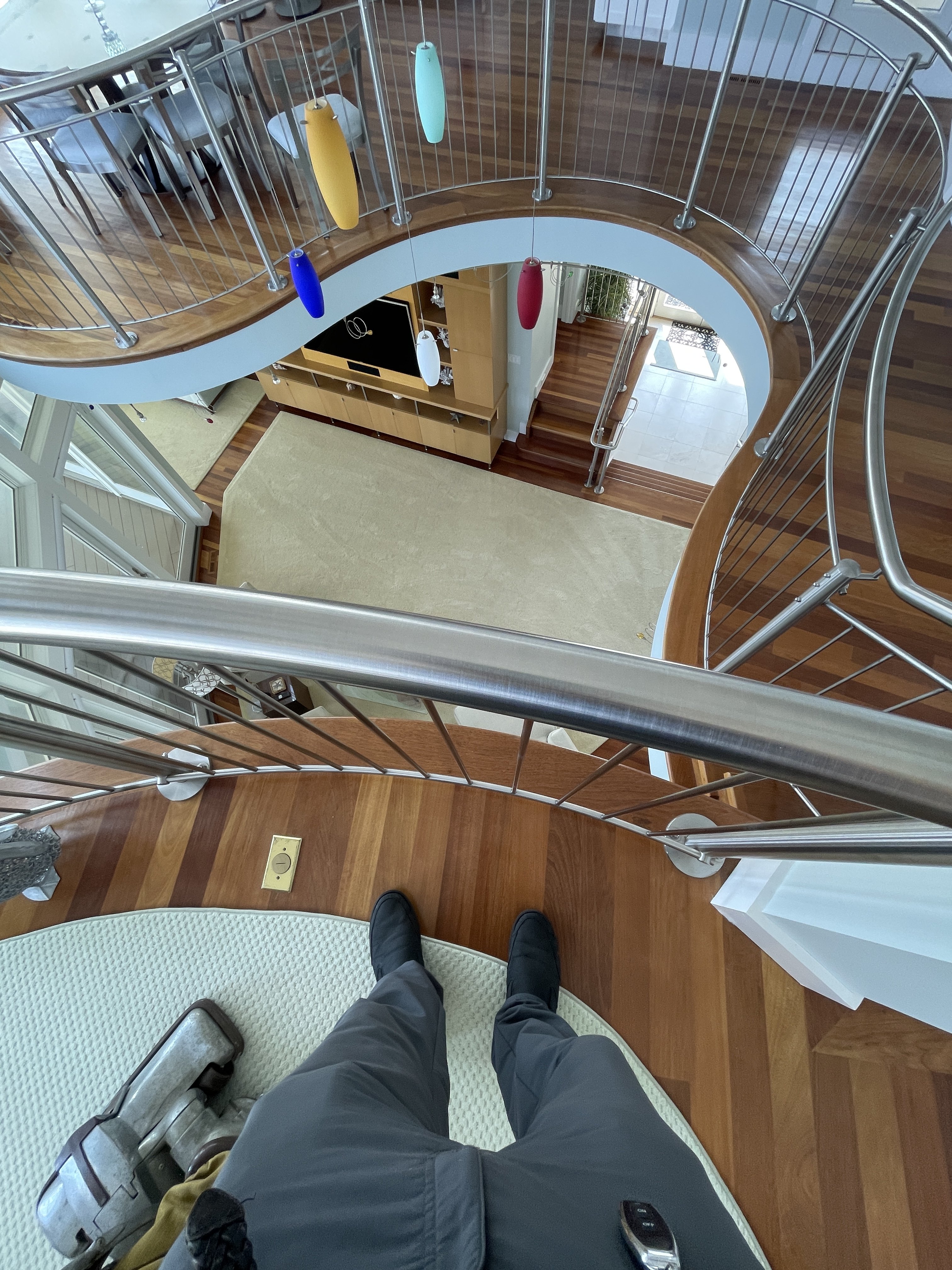

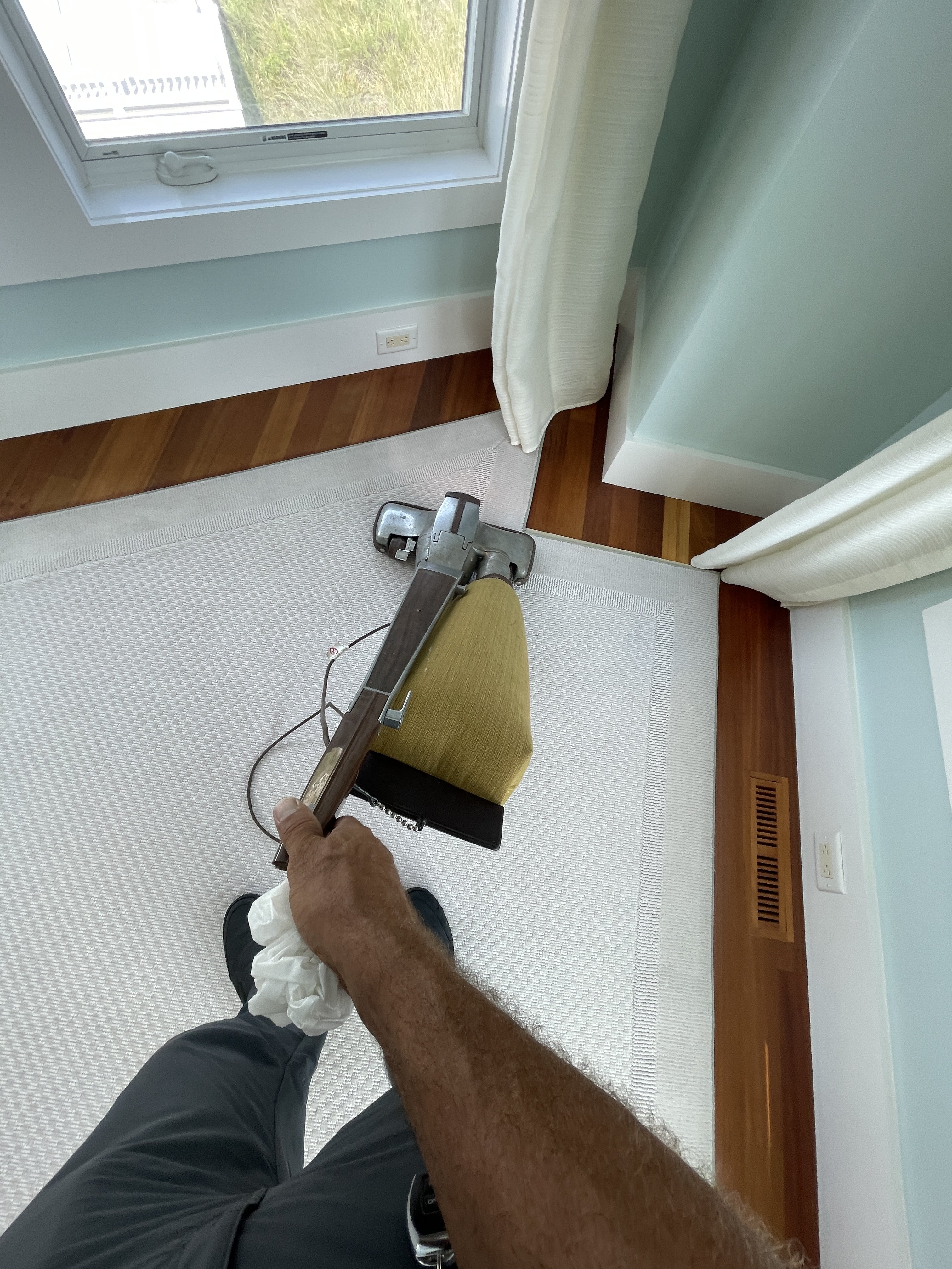

One for traffic (Kirby) before I move furniture.
Then I move furniture
And use the Oreck to pick up the scraps and dust the boards and heaters

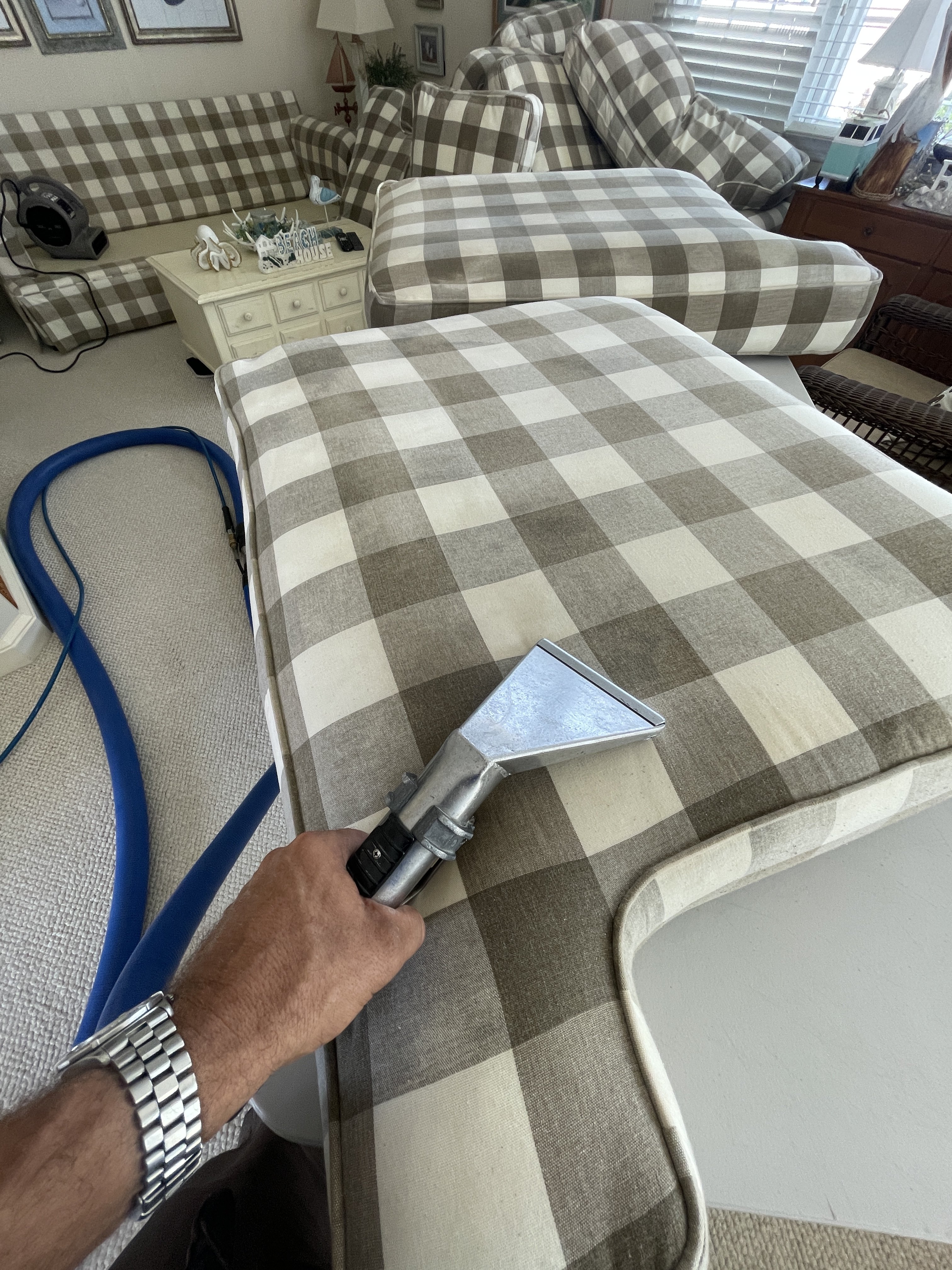

Now for Upholstery

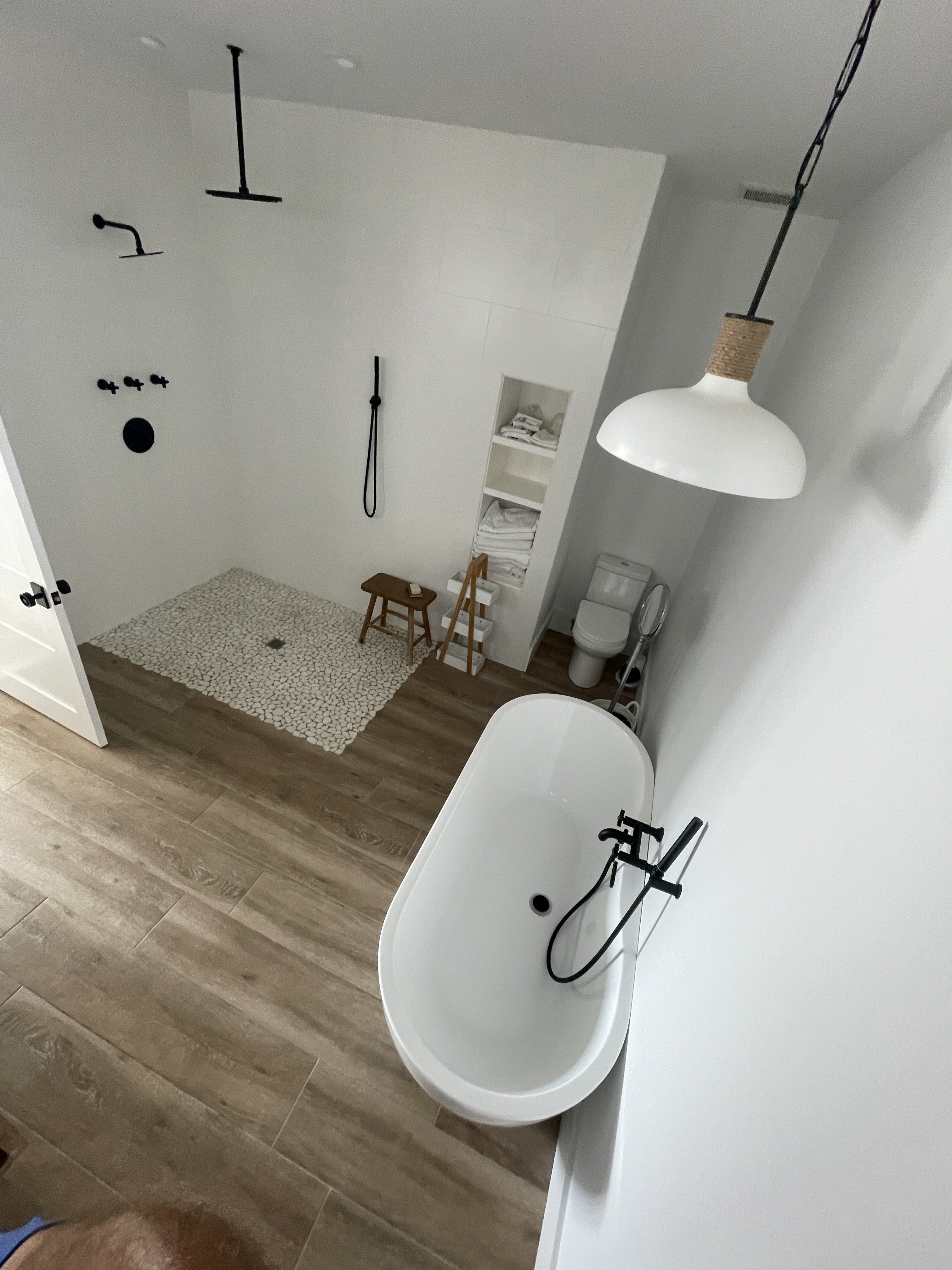

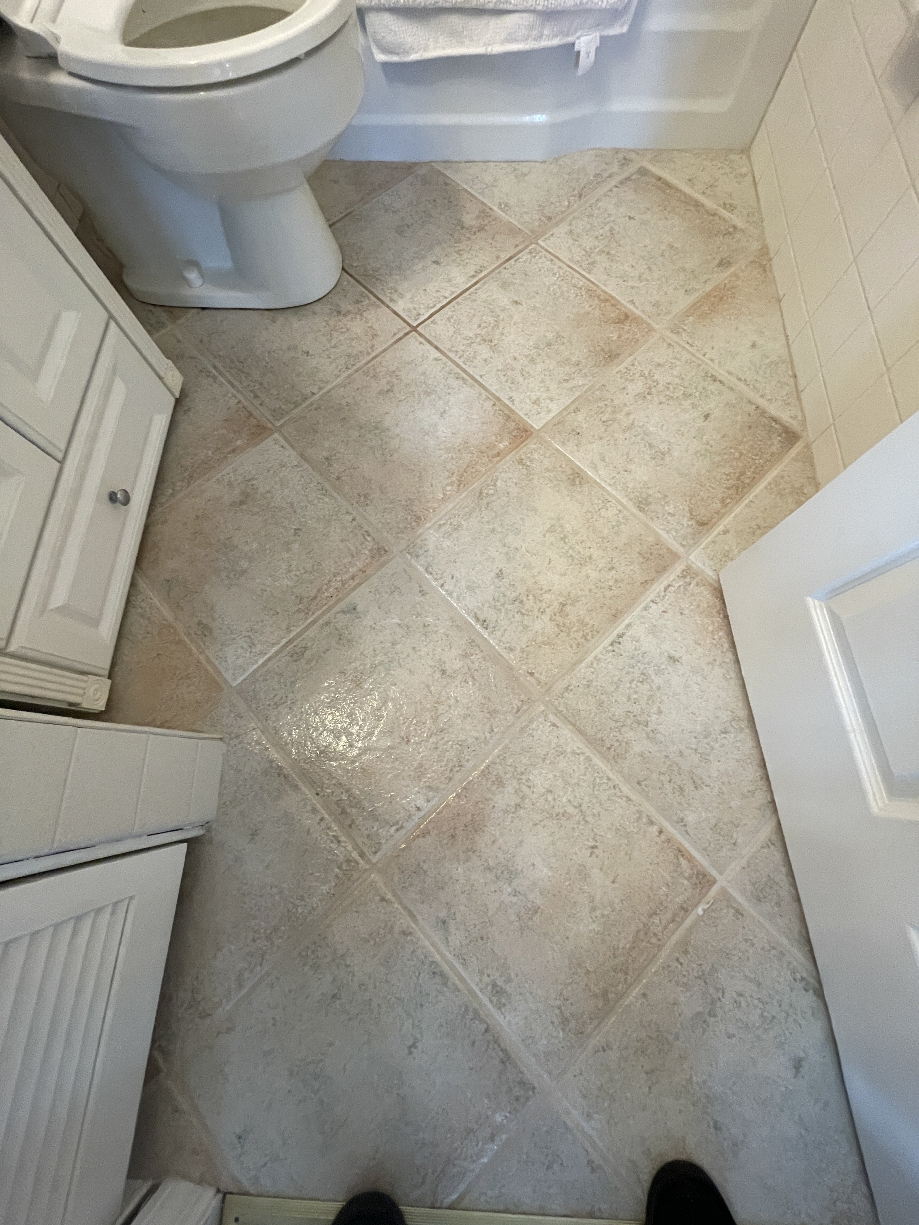

And I will admit, the Turbo tool and gecko were not used. I used the PCQJ with the Hybrid Greenglide and banged out 2 small bathrooms and kitchen, it worked wonderfully.
I hack cleaned it for now, after Texas I am coming back to re caulk, brighten the grout around the pisser, caulk the tub. So I charged a little for now and gonna charge about 25% of the cost of my Advanced Multi Cleaning cost for this one bathroom....... (right MikeyP?) You gotta fast track me.

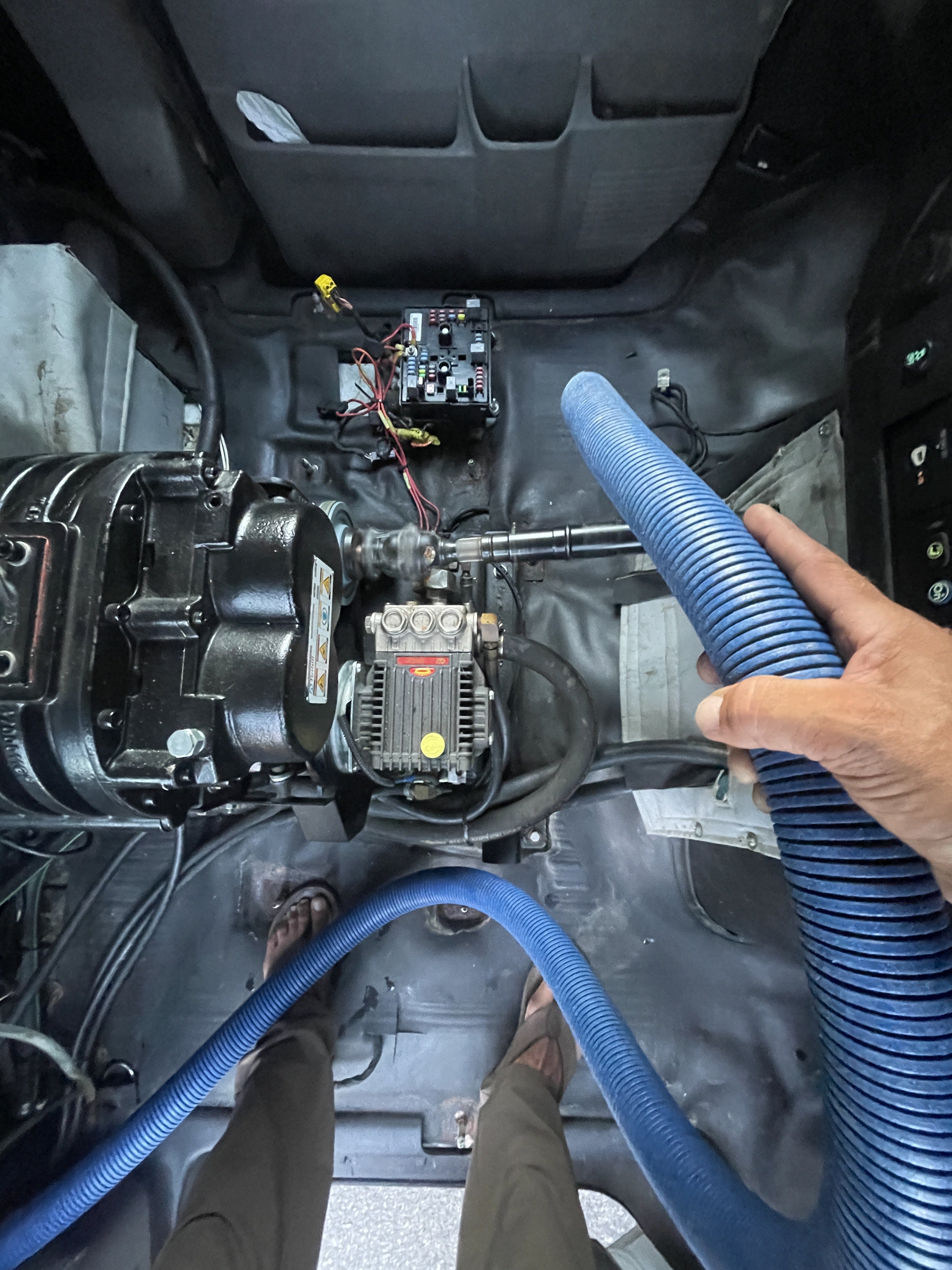

Had to stop after this job and lube up my Hydramaster

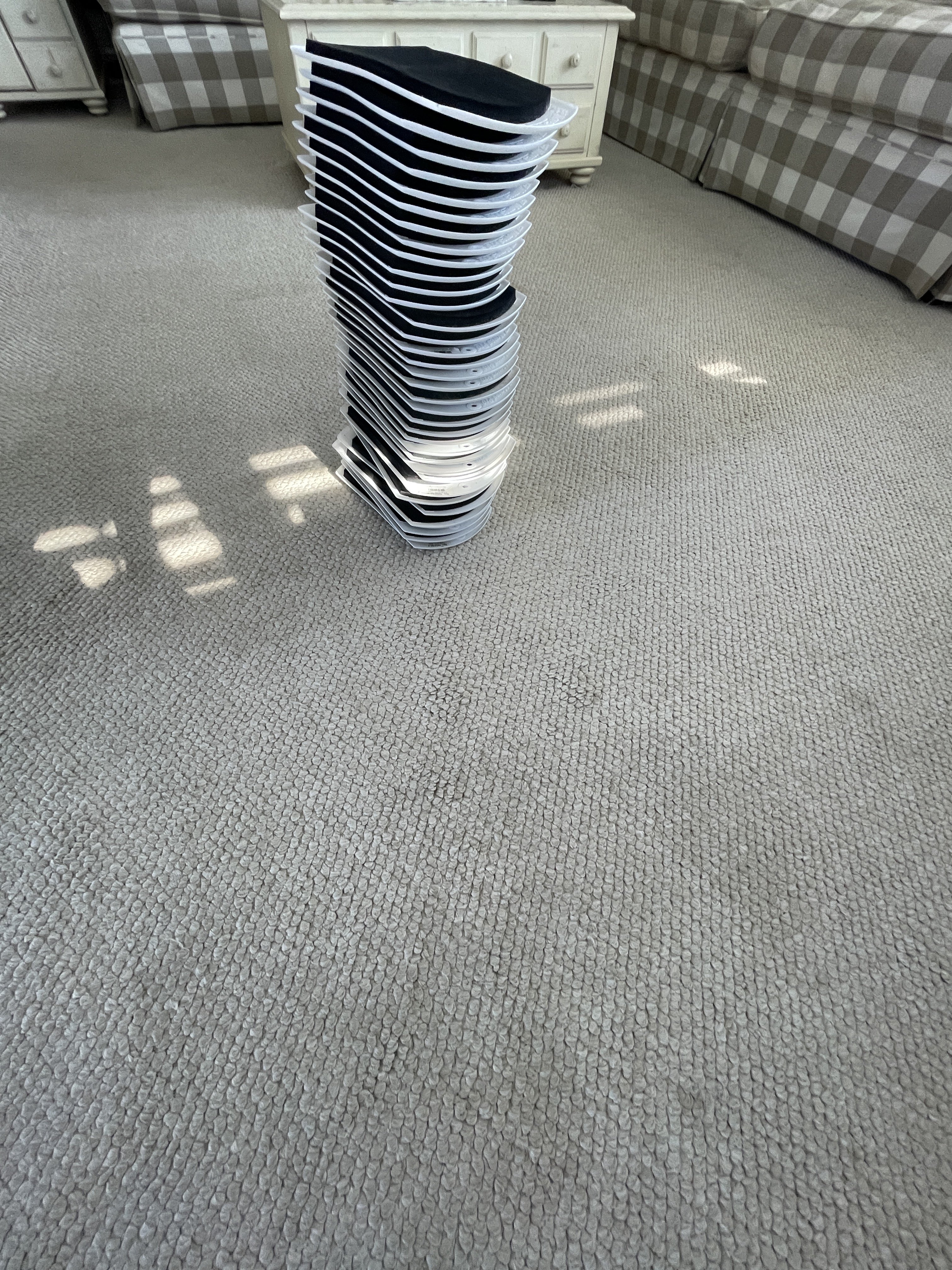

Im gonna start using these more often

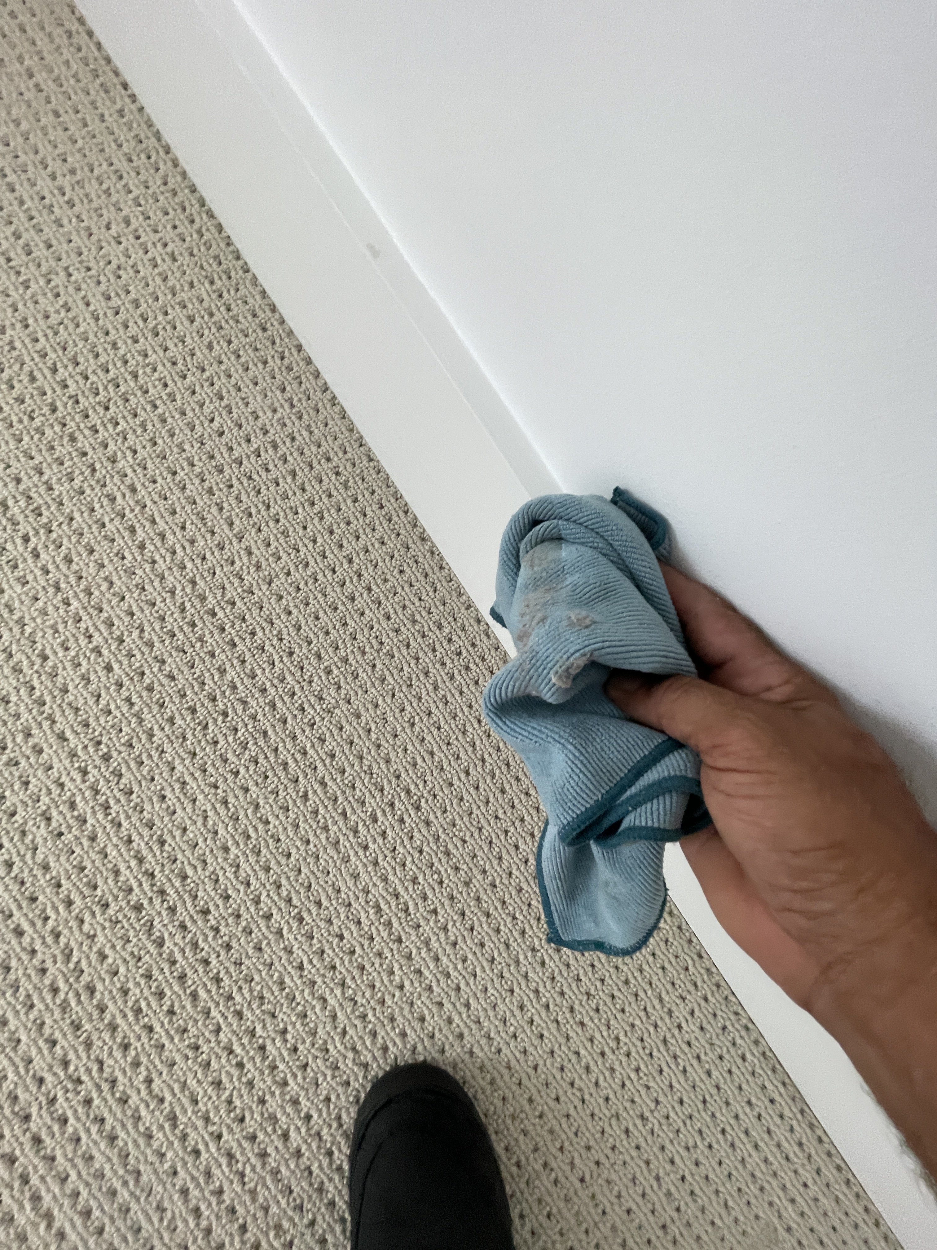

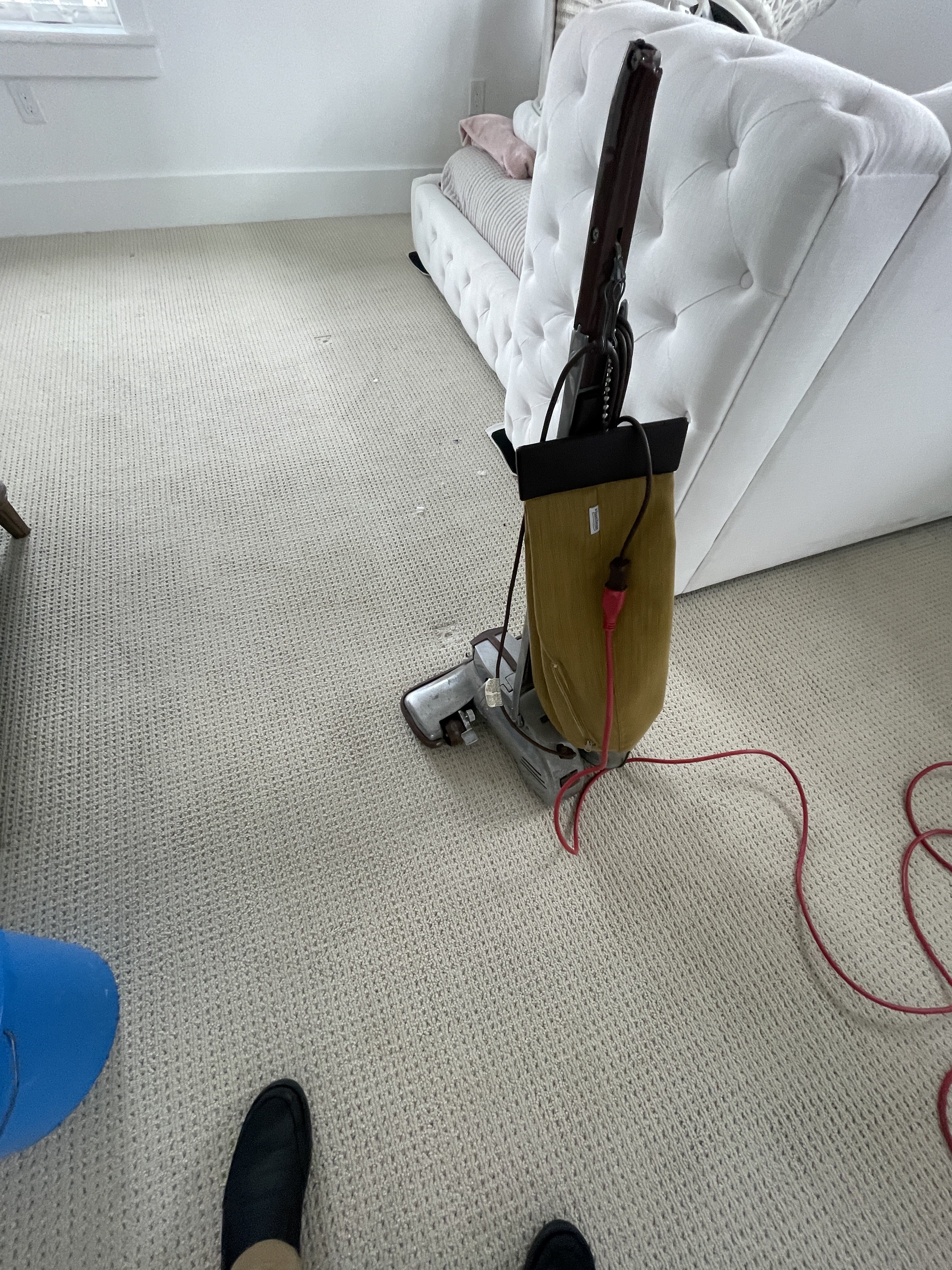

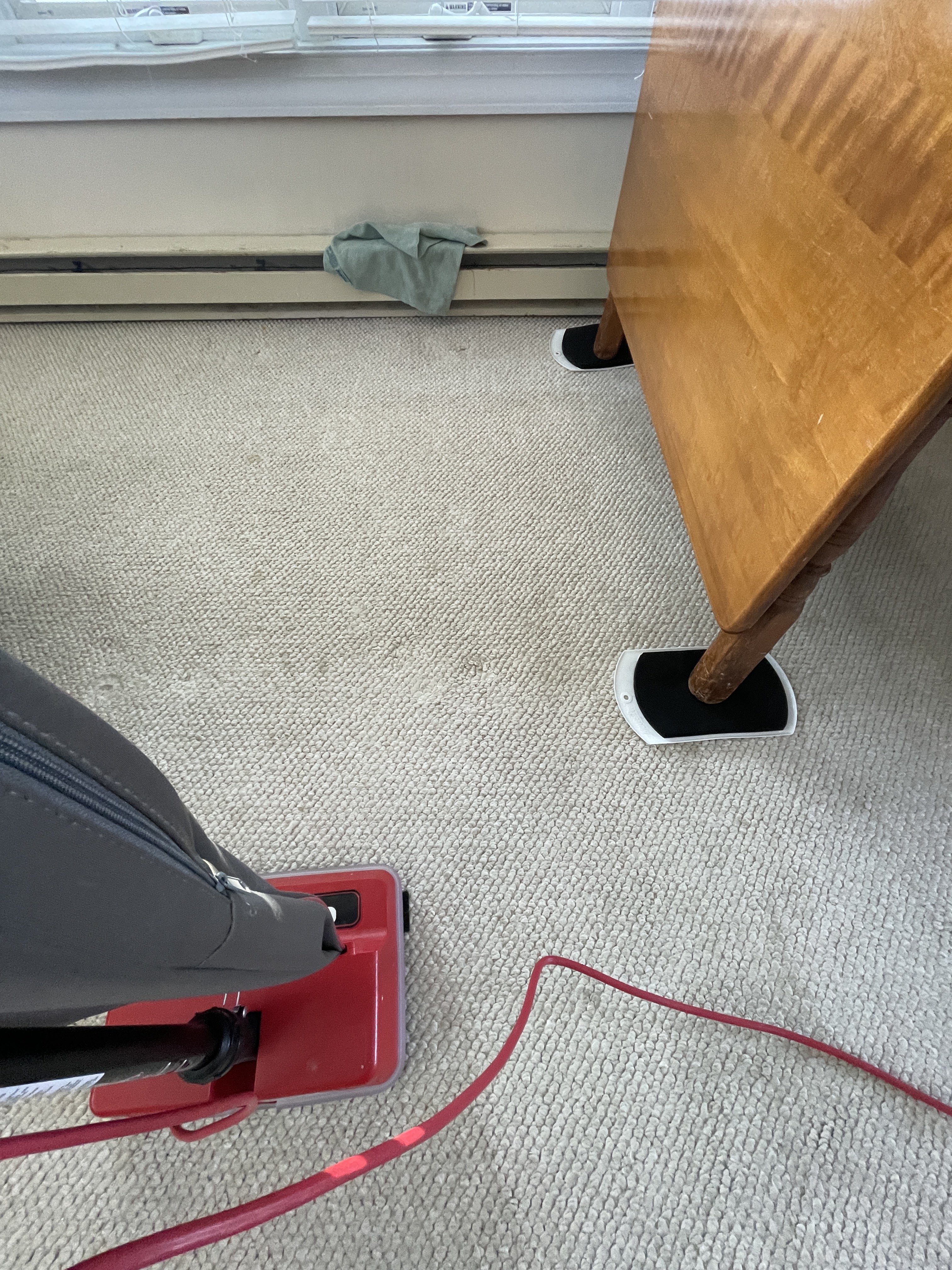

a lot of times under low beds, its the "dirtiest" part of the house and the bseboards are nasty. How do people even live like this... scroll in
notice the cord management, I love that Oreck cord. Easier to manage than a 2" vac hose.

Moving furniture is not how I look at it. Sliding and shifting furniture the least amount of distance and replacing in exact spot is a. lot differnt than actually moving furniture. If I spend 1 hour pucking up and slide, vac, wipe boards, the TM is not running, the doors are shut with AC on, or heat.
When you master putting sliders in with a flex of the calf muscle,and have enough to do a few rooms, even on light furniture so you can slide them right out of the room to create space.
Legs never contact pre(cleaning)spray, cleaning spray, and dont need tabs or blocks, saves time and money.
Furniture sliding got a bad rap.
