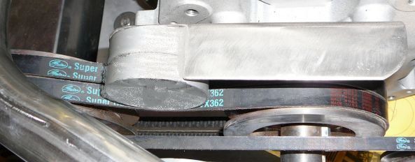

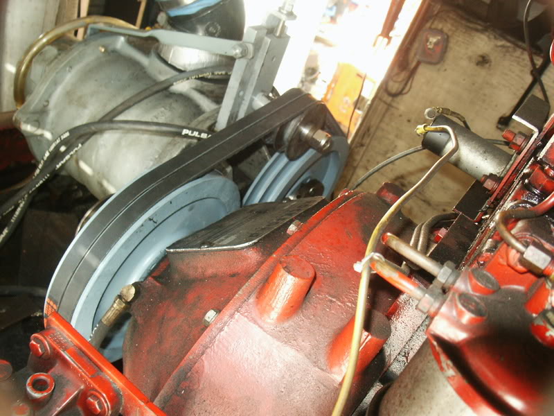

Ron Werner
8,726
Ron Werner
Took a little extra engineering to make it fit but it works great.
Got it from John's Machine Shop.

Thanks Ron, I need mine to ride on the back(flat) side of the belts. I will give John a call, maybe he can get a different pulley to fit. Besides making it easier to change belts I want create more surface for the belts grip the drive and blower sheaves.

On the belt tensioner ...
We do have a stainless ball-bearing design that mounts on the engine.
It was designed for the flat side of several 3VX belts.
Larry Cobb

Larry, That looks like what I'm looking for. Is your tensioner self adjusting(spring loaded)? Will it fit on my 31 horse Agies? How much is it?
