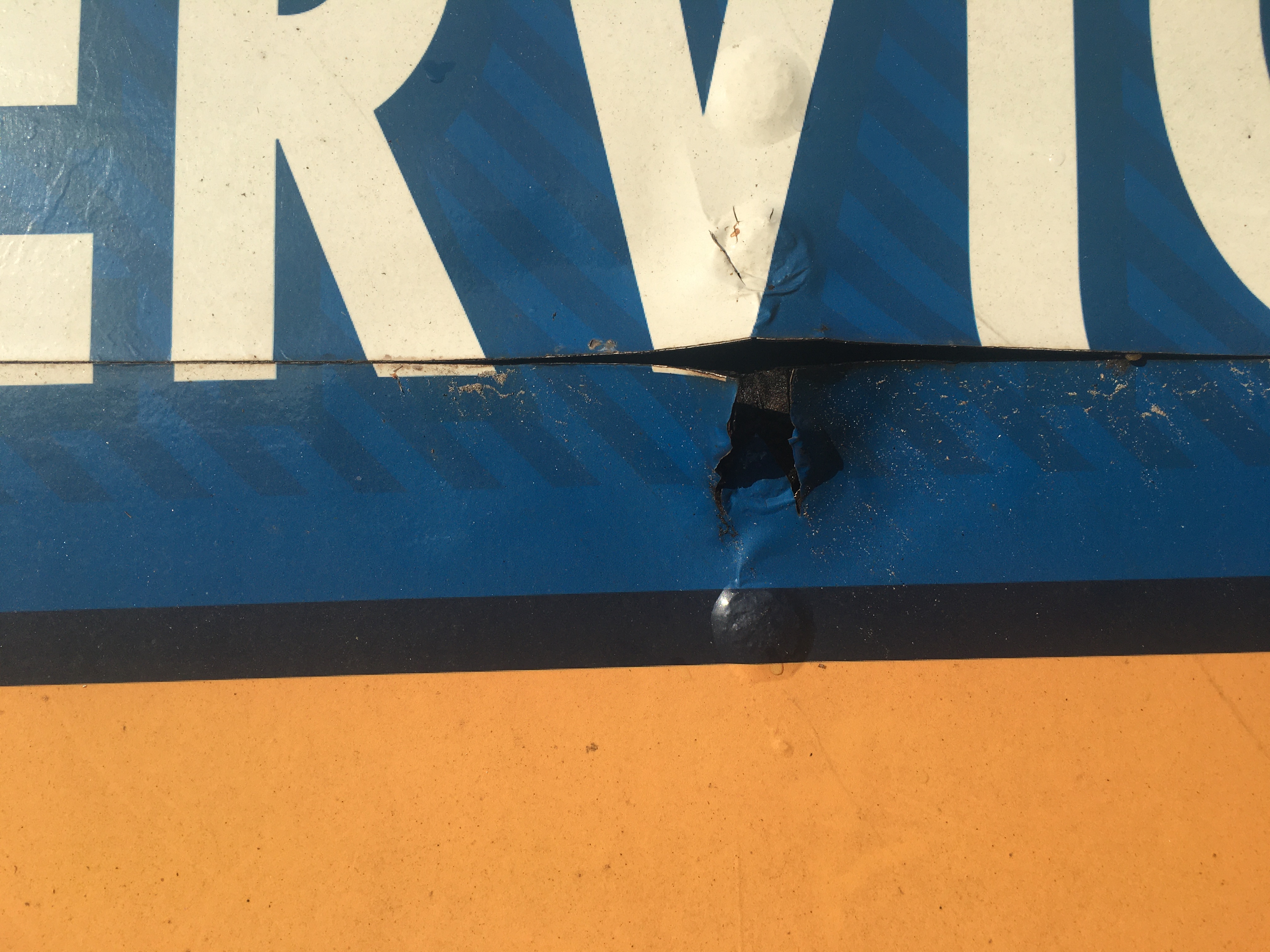

Best company to buy a roll up door from?
14,624
And are they easy to install?

Not sure the brand matters. They all rot. Even metal clad ones are wood inside. I haven't been able to find a full-width all metal door, but I'd be concerned it would be noisy.
Installation is simple, but tensioning the springs is a little dangerous. It requires keeping body parts out of the path of potentially flying tensioning tools.
