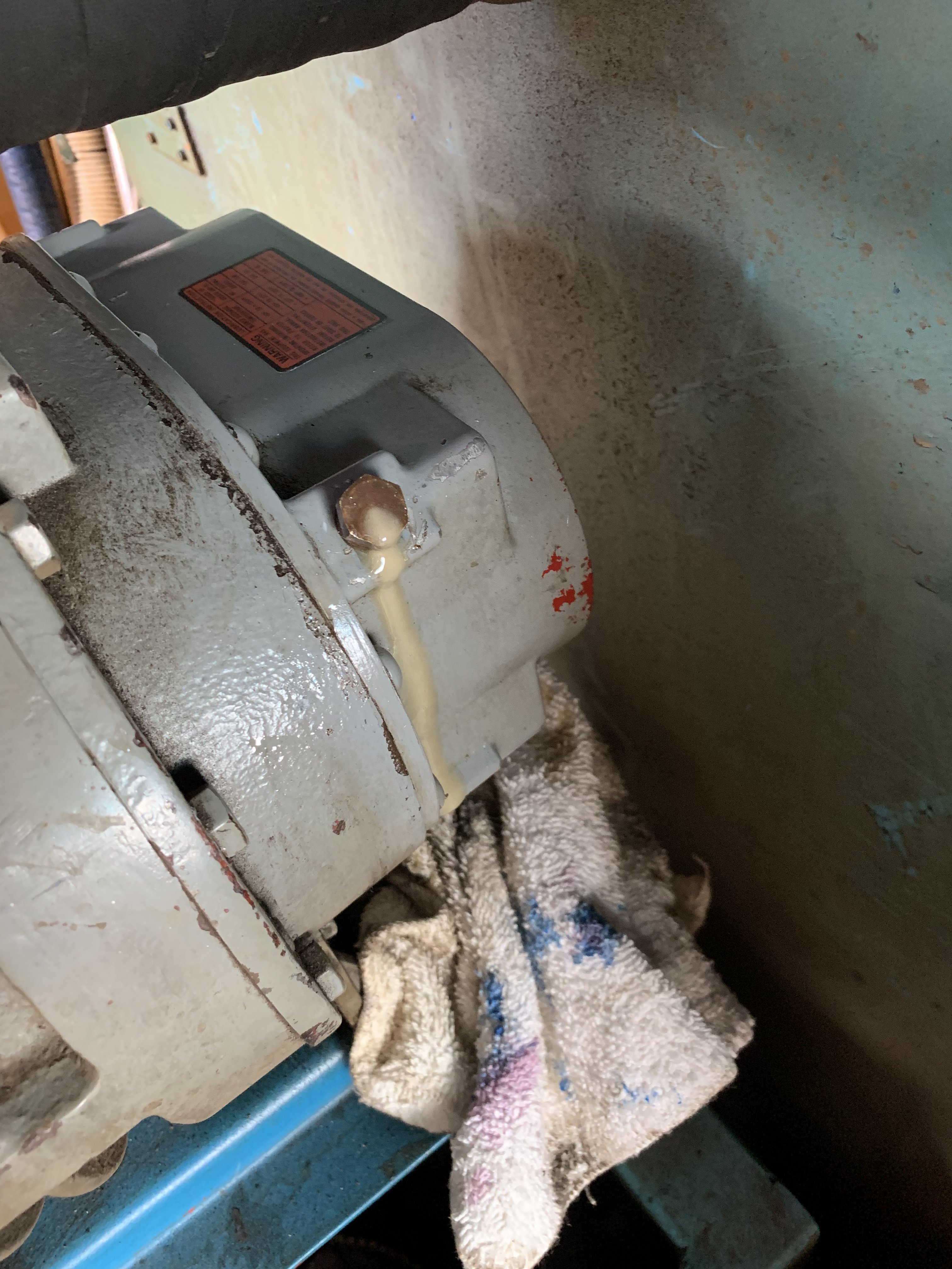

Jeremy
What causes oil to come out of this
jmo
Apr 11, 2011
350
Jeremy
It was low I refilled how would water get in it?
seems unlikely but maybe a bearing seal failure could cause moisture to enter AND overpressure the case
Edit: If it wasn't coming out I would think maybe just condensation...happens on my bike
jmo
Apr 11, 2011
350
Jeremy
Vac was really weak is why I check oil. Once filled vac was good again but now it’s doing that. So maybe a bad seal.

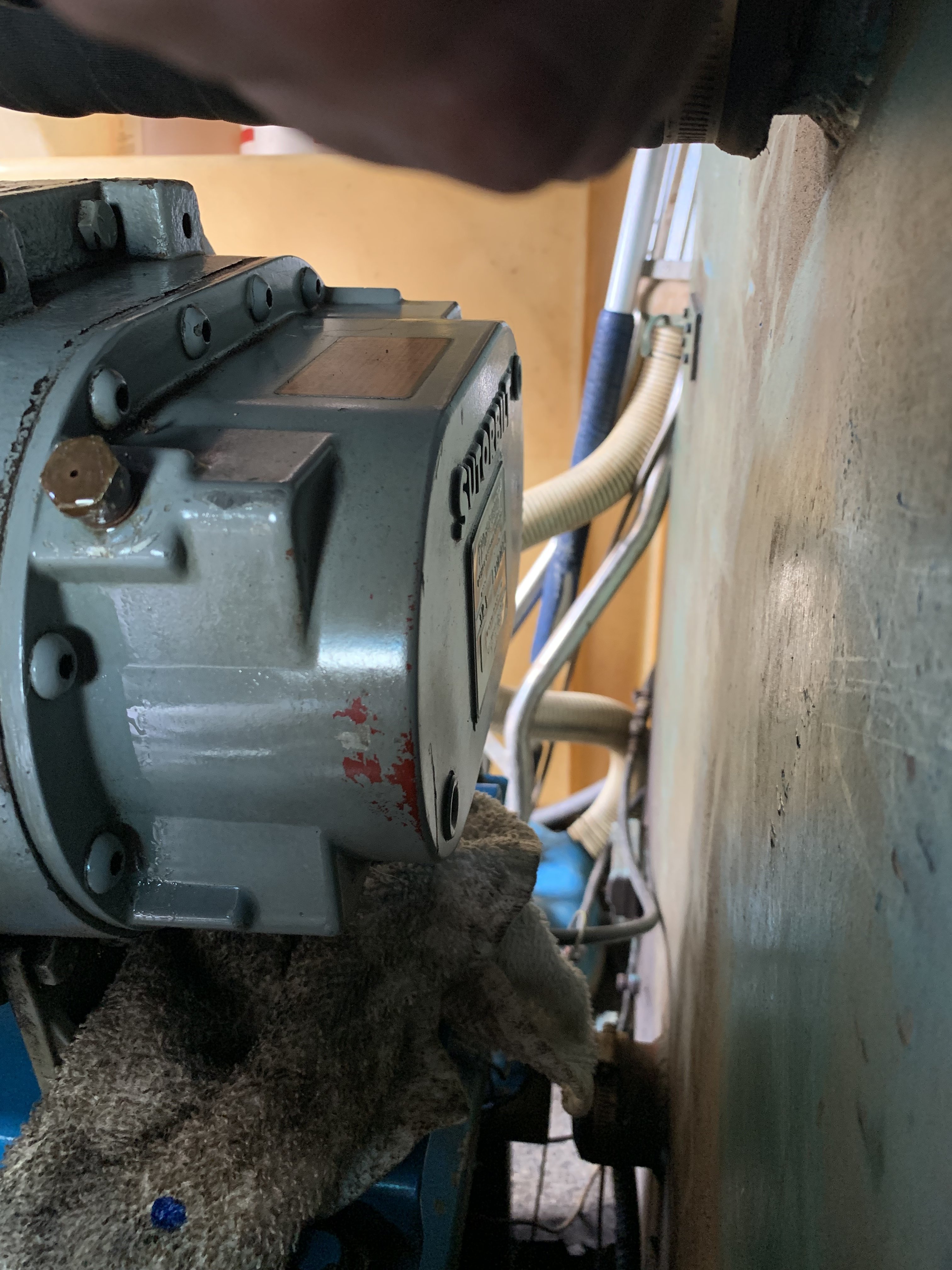

Jeremy
I filled to top screw on back of blower
Has anyone ever changed the seals or can it be done? Am I going to need a new blower?
it can be done. Not sure what blower that is but there are rebuild kits for most.
searching the part number would lead you to the individual part but probably better to have the whole kit
and there is a vid or two on youtube about rebuilding one
may want to consider a pro doing it if you lack a good tool set

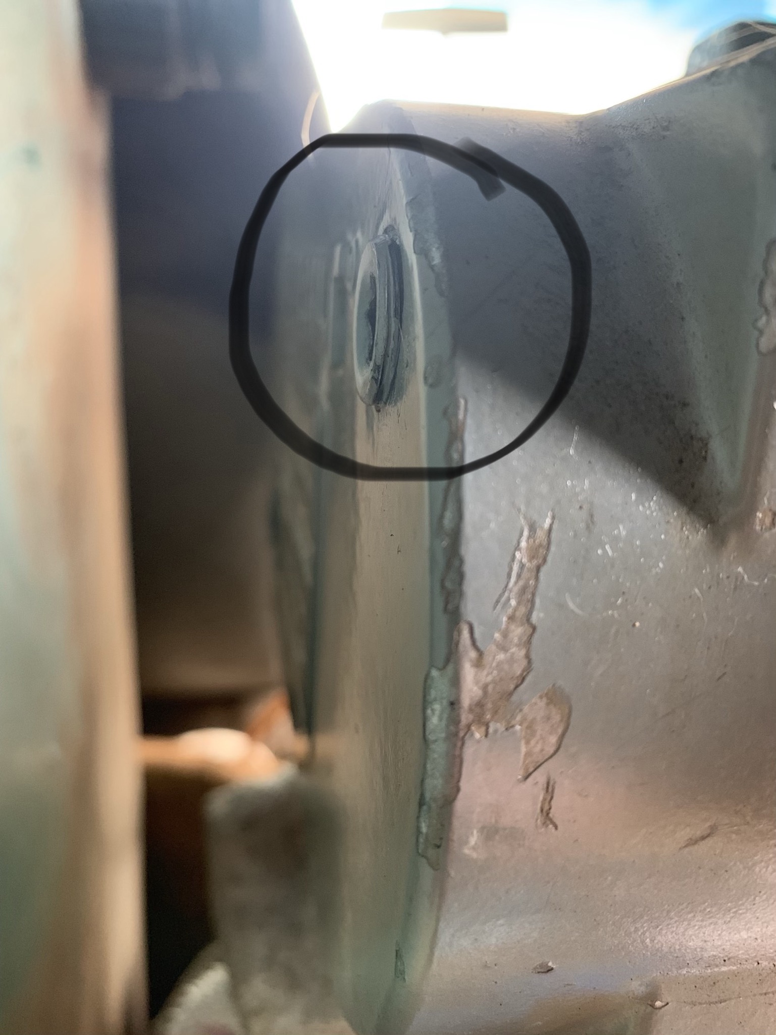

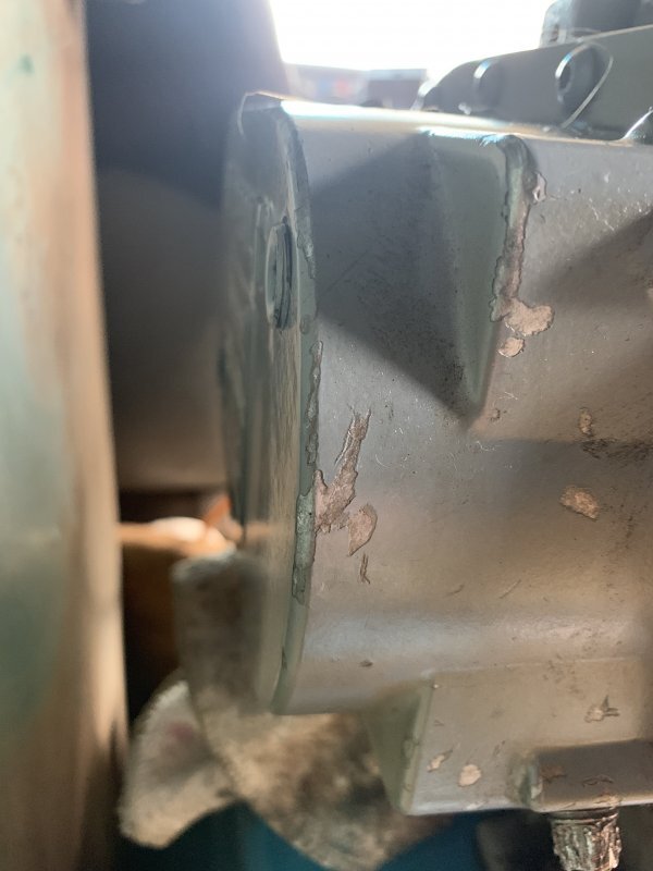

jmo
Apr 11, 2011
350
Jeremy
this one
jmo
Apr 11, 2011
350
Jeremy
There are only two plugs on the back the other one is at the bottom.
