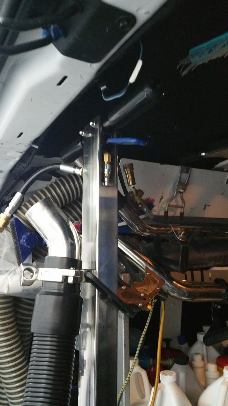

Shawn, I have a couple questions for you. Don't know if you can tell from the photos attached but the exhaust manifolds where they connect to the divertor appear to have warped or bowed slightly. (On both ends) I'm wondering do I have a more serious problem then I think. If they are warped then new gaskets may not seal. What would be a possible source of excessive back pressure for the exhaust system? Clogged muffler? The exhaust from muffler does not seem to have changed any. Thanks for your thoughts.
View attachment 3614View attachment 3615
