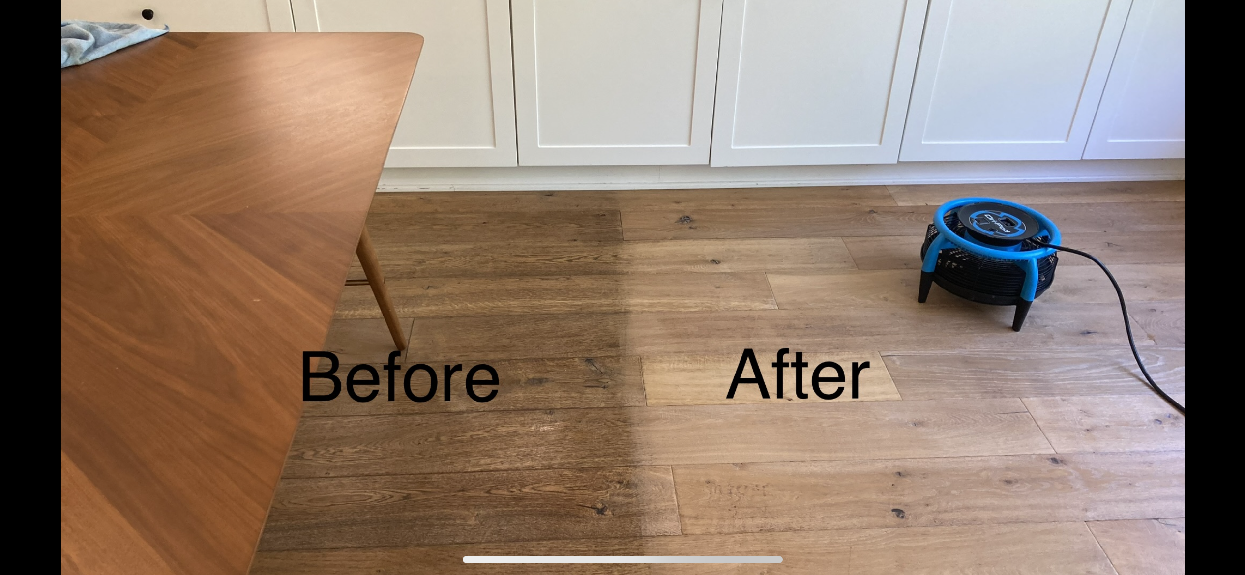

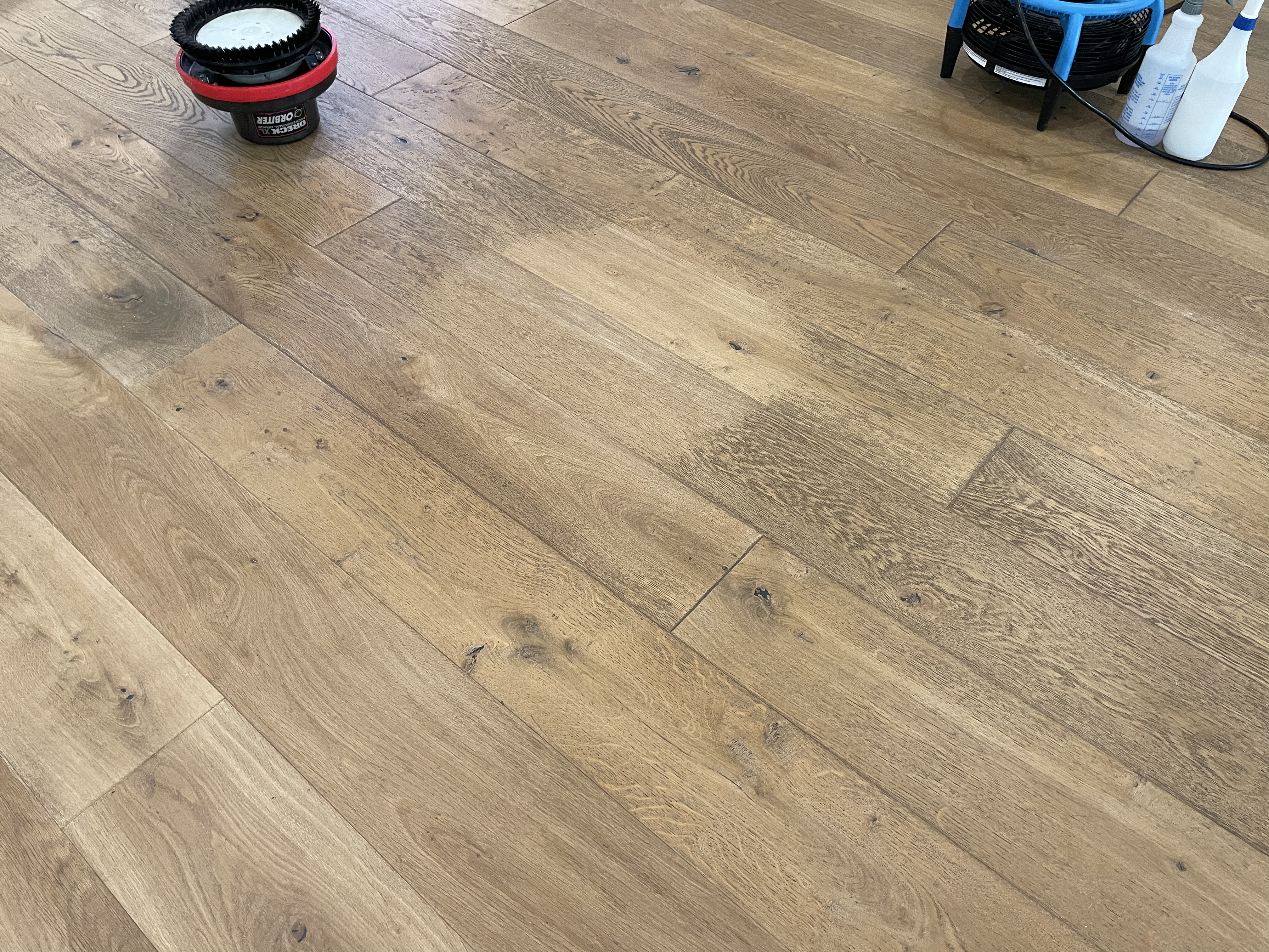

Demo spot with oreck orbiter black carpet brush and basic coatings dissolver, then rinse with squeaky and dri pod.

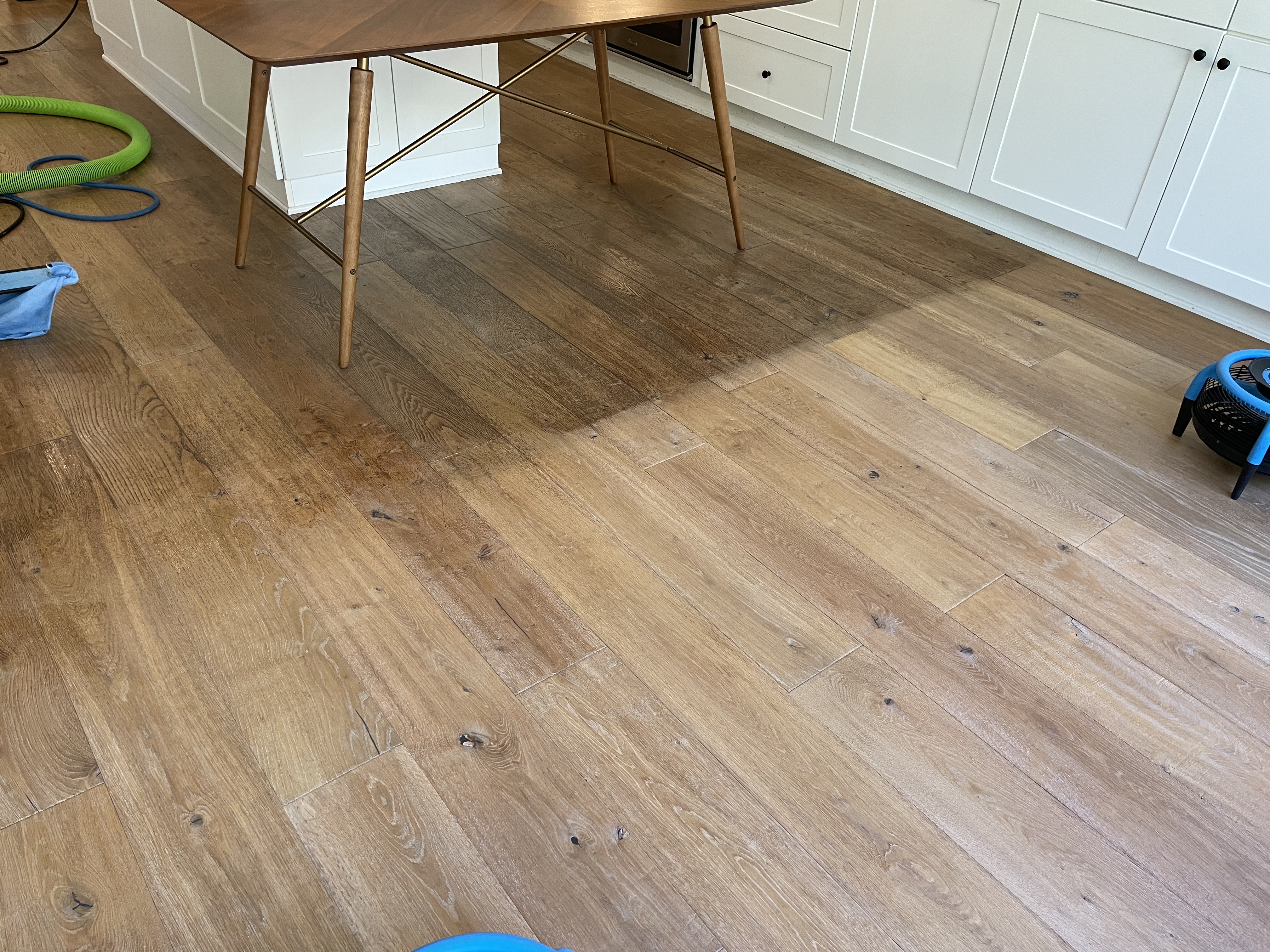

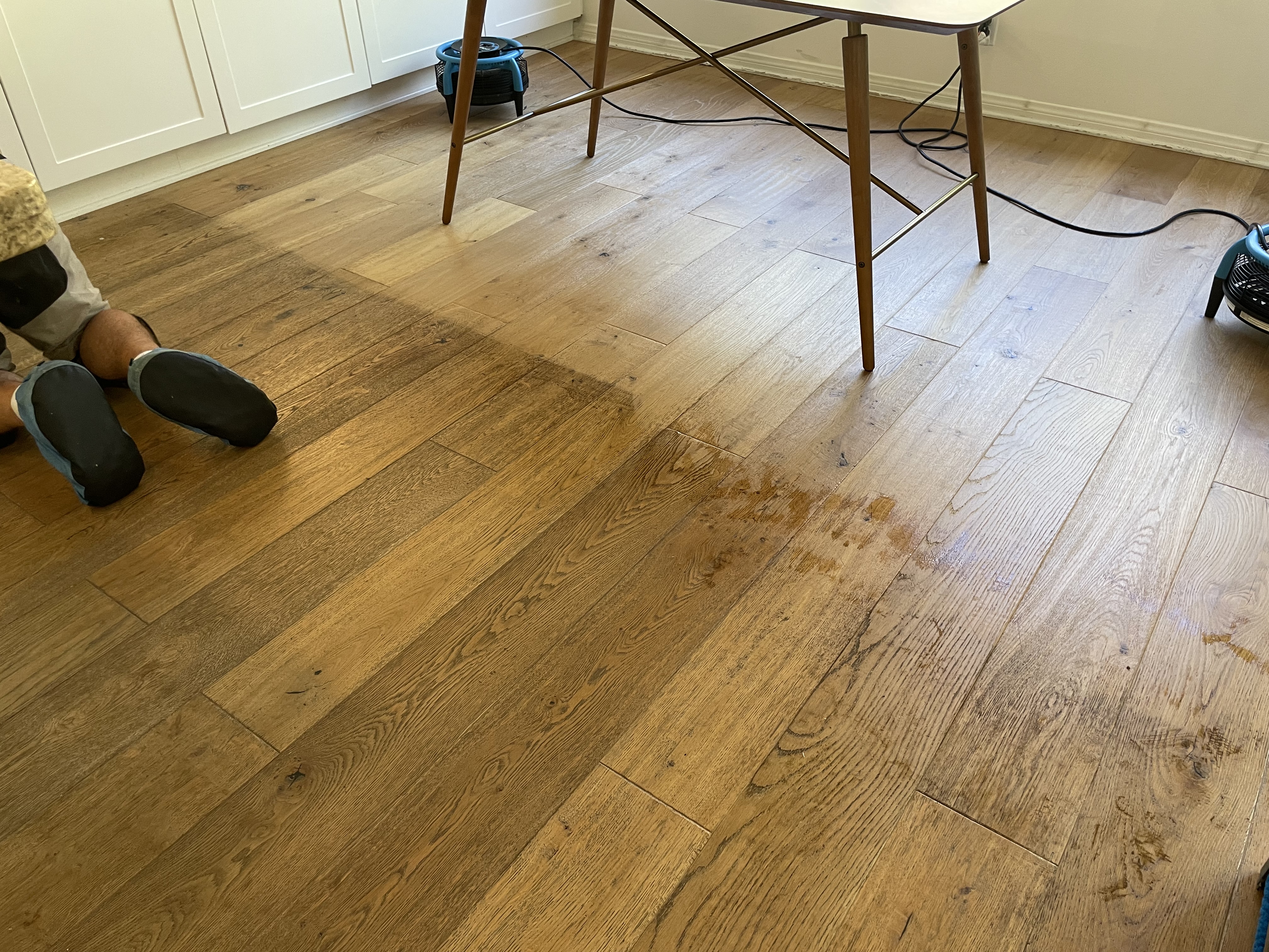

Brush Pro killed it!!

encapman
2,331
St Petersburg, FL
Rick Gelinas
