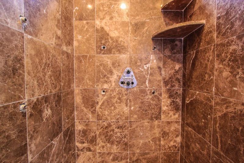

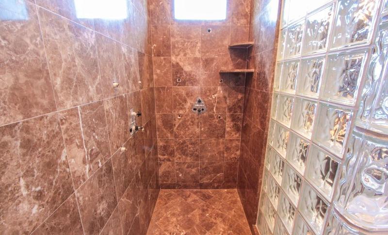

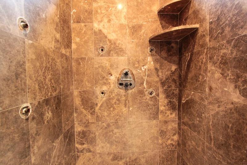

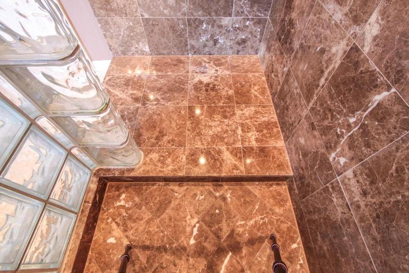

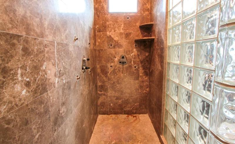

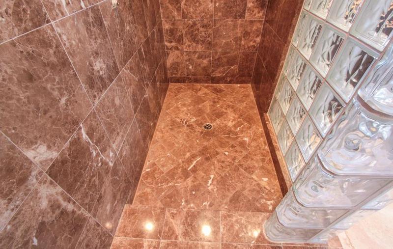

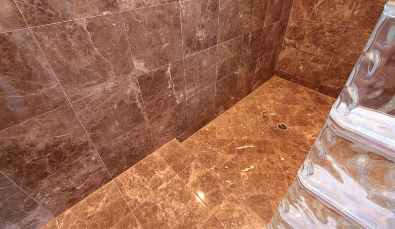

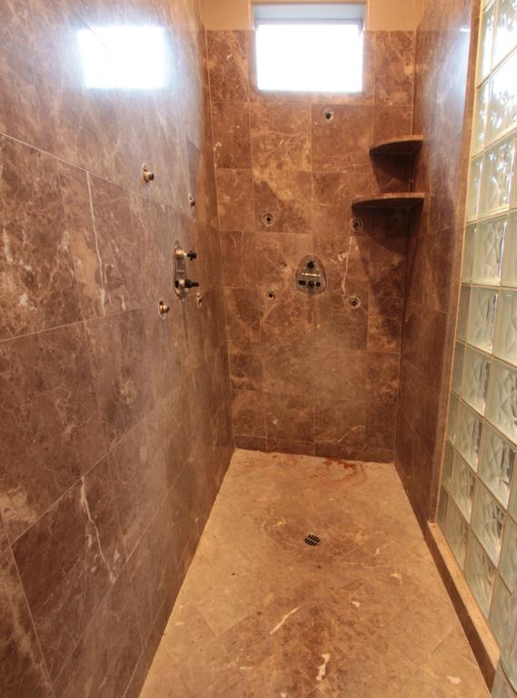

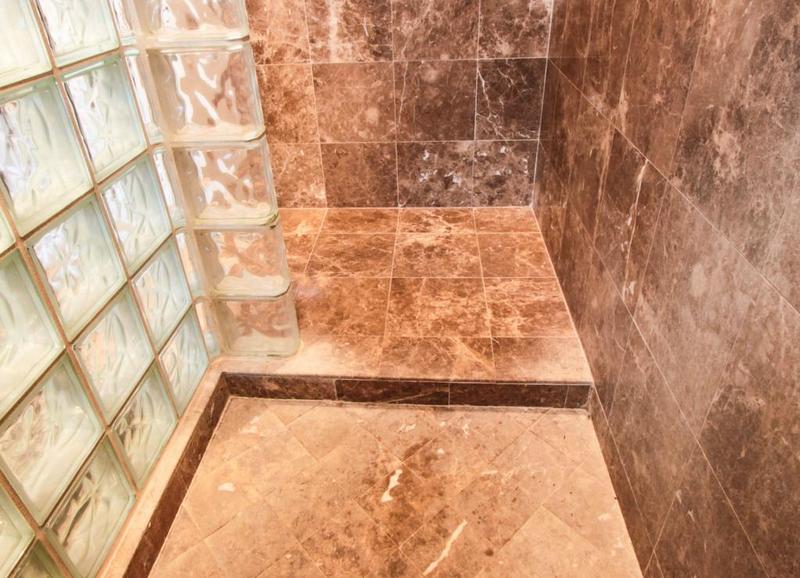

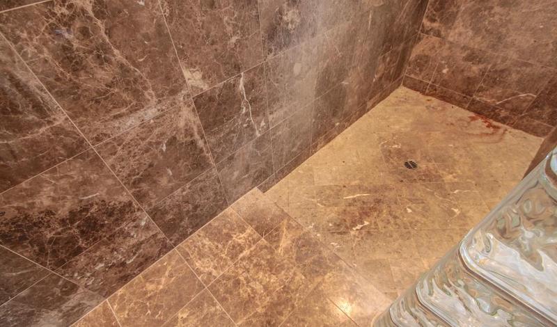

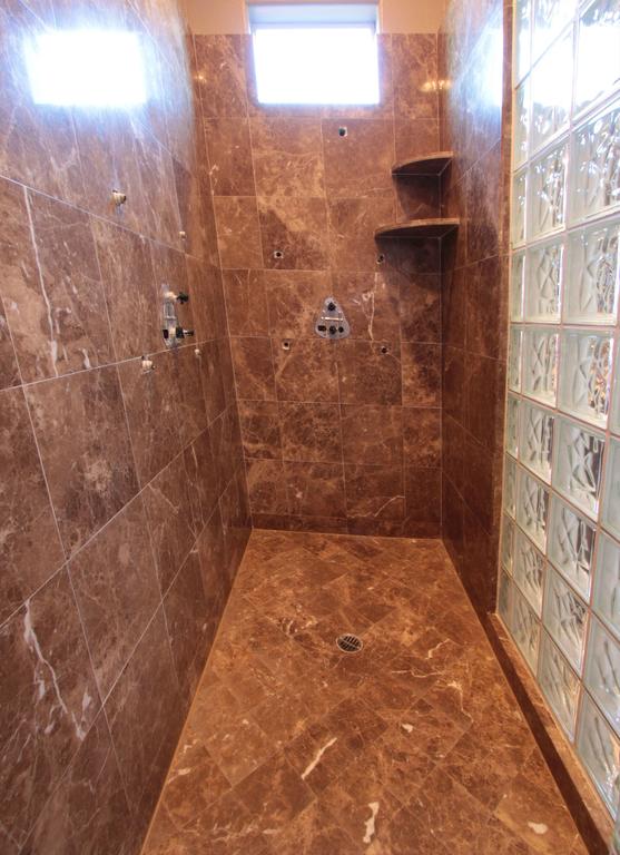

This shower doesn't look too bad, but what you see is all acid etching, no soap scum. It was rough to the touch. The homeowner hired someone who apparently washed it down with muriatic. It took 3 days of refinishing, detailing and caulking to get this recovered. The glass block was machine polished and sealed. Some areas had to be started with 120 resin, which is extremely rare in a shower.
•The glass block was done with Stone Pro Stone Scrub and sealed with Wipe N Seal from Easy Stone Care.
•MB-22 polishing powder was used to finish it off
•Customs 100% silicone was used around the perimeter of the floor and landing.
•Klindex Stone Soap from Easy Stone Care was used to wash everything down and seal it.

My guys did this, I just took the pictures. I did guide them a bit. These can bite you in the ass if you don't do the first few steps absolutely correctly.
I hope you charged like 3 to 4 thousand for that! Nice work.
It was exactly as profitable as it should be. The guy asked us to recover the shower and was happy to pay for it.
