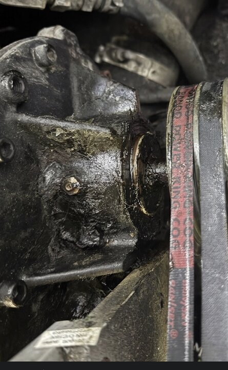

I was greasing and oiling everything tonight. This seal that goes around the driveshaft in the blower is out. If I tape one side in, the other side comes out. When I put grease in, rather than leaking out the vents, it pushes out this seal and starts leaking out the bottom. Wondering if I took the belt pulley off if I could just take a pipe and bang it straight back in. Not sure if it’s supposed to be glued in there somehow or what.

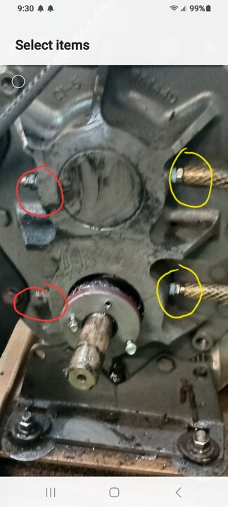

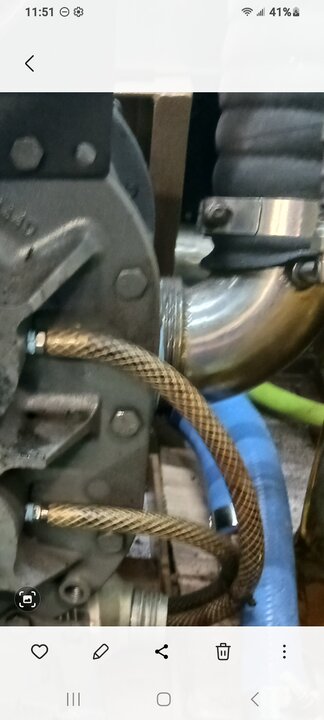

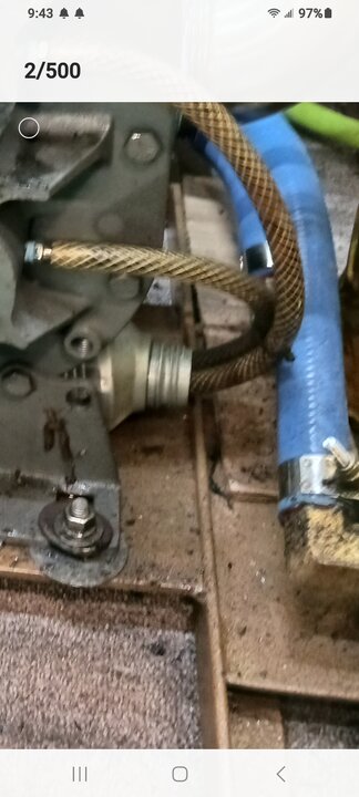

If this is where the grease is coming out of that is a big restrictionand will cause back pressure(it doesn't look like a zirk for grease in)remove them and eighter leave open or better and cleaner plumb um like i did mine (picture below) They should be screwed into ⅛"npt holes. On my blower i put ⅛"npt × ⅜ mhb and ⅜hose to plumb excess grease to a holding container.
View attachment 133463 View attachment 133464

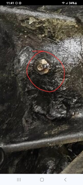

Hello. I think I’m a bit confused by your response here. The fitting on my photo is a vent for the grease I believe. Usually when that seal is in, I pump both lines full of grease on the bottom side where the zirk fittings are until it starts leaking out the top vents. At least that’s what the butler manual said to do.
You should have 2 zirks on one side. And 2 vents on the other. 1 each for each bearing, correct? If so, remove the vents. You'll have larger holes for the excess grease to leave so as not to build pressure. On my blowers i install hose barbs and hoses to redirect the excess grease to a container instead of having it pile up in the machine picture below grease in, red(zirk) grease out, yellow to holding container hose barb. The hose barb has a much larger hole so as not to build back pressure clear hose allow me to see when grease is coming out and stop filling. Easier on shaft seal and upper bearing cover/plug plate and no mess to constantly cleanup. Because my blower sets vertical i simply used a qt oil bottle that i cut the side out of and it sets under my blower and collects the excess grease
View attachment 133466 View attachment 133467 View attachment 133468
Ohhhh ok I gotcha now. Thank you!
