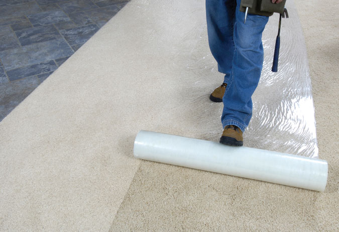

Carpet mask is plastic sheeting that is sticky on one side that can be laid down to protect any flat surface. Once it’s applied it doesn’t move when walked on, thus preventing most slips and falls all the while protecting the floor. Carpet mask should be used for short-term situations perhaps a few days or a week.
For 90 days multiple contractors walked up and down these stairs and in the hallway going in & out of the rooms during the renovations. With each step, each boot, each turn of the heel, the glue from the sticky side of the carpet mask was pushed into the carpet with pressure. Another dilemma was the carpet mask was applied to cover the steps wall to wall but the hallway just had a few strips running down the center leaving exposed carpet on either side of the carpet mask in the hallway. The exposed carpet looked different after the carpet mask was removed and a visible line was discovered. This created another concern in the cleaning process.
Doing some research on carpet mask, you will find the glue that holds the plastic down is water based or a solvent acrylic based adhesive that is recommended for use only on synthetic carpeting. Most carpet mask will use the solvent acrylic based adhesive in their construction. We now know that the glue residue left behind on the carpet is most likely solvent based. Even in the off chance it is a water based glue it has been on the carpet for approximately 90 days and has somewhat bonded with the natural fibers becoming extremely difficult if not impossible to remove with only a wet cleaning process.
Fast forward, about two weeks later, the carpet had noticeable discoloration. The carpet mask left a residue that you couldn’t see or feel to the touch. The Estate Manager called his favorite cleaner and had the carpet cleaned like they always do and the carpet seemed to be back to normal… for a couple of weeks. The flooring was even more soiled looking than before. Why?

The Solution! A multi-step process needs to be applied when removing carpet mask residue that has been left down for a long period of time on carpeting. A combination of dry cleaning the carpet to remove the glue residue most likely will be done first followed up by a wet cleaning to rinse and remove the soil. It should be noted that a multi-step process may not remove all the residue or soil on the first cleaning and may need to have a light cleaning touch up a few days or weeks after the initial cleaning to be sure it is completely removed.

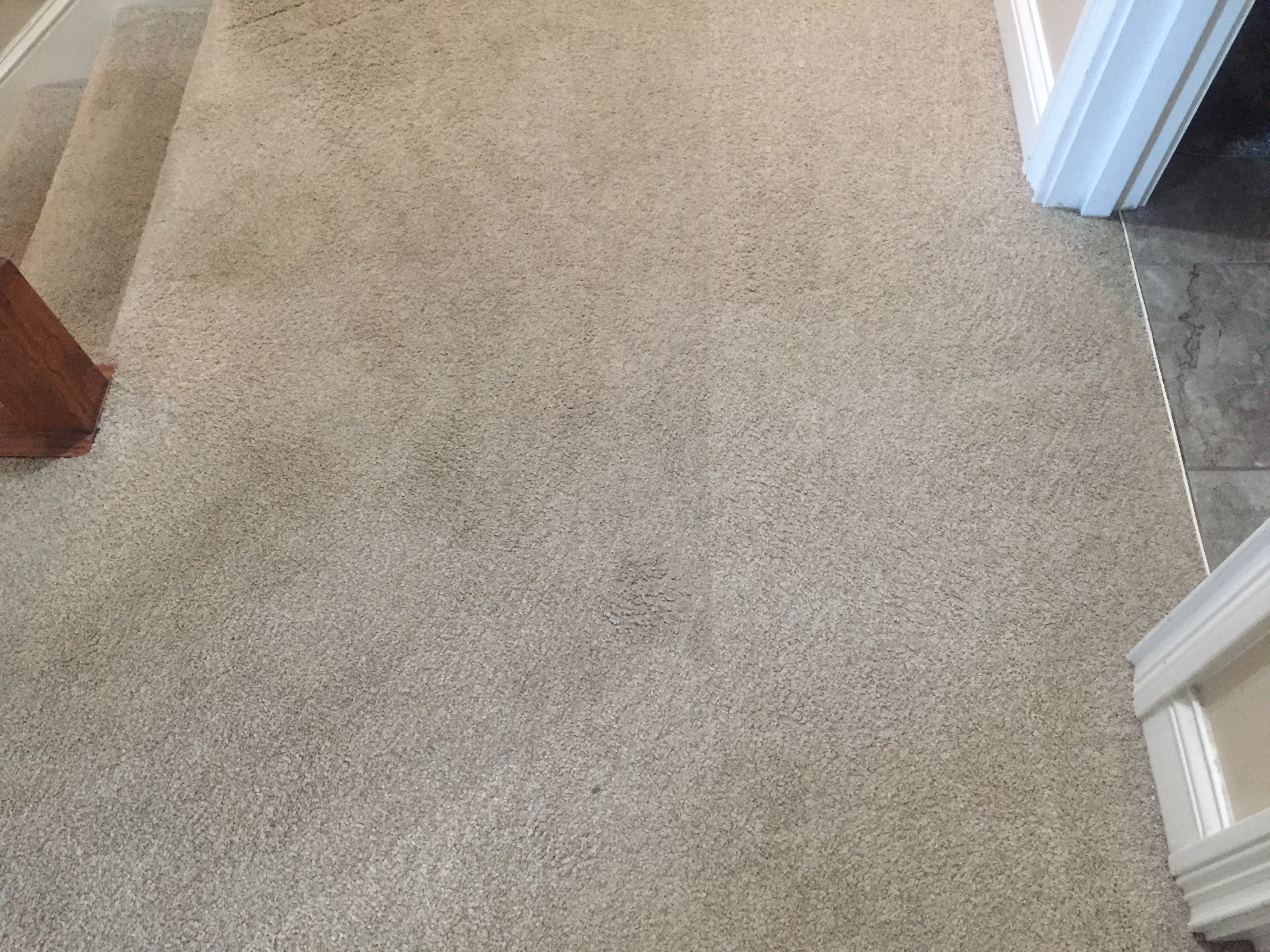

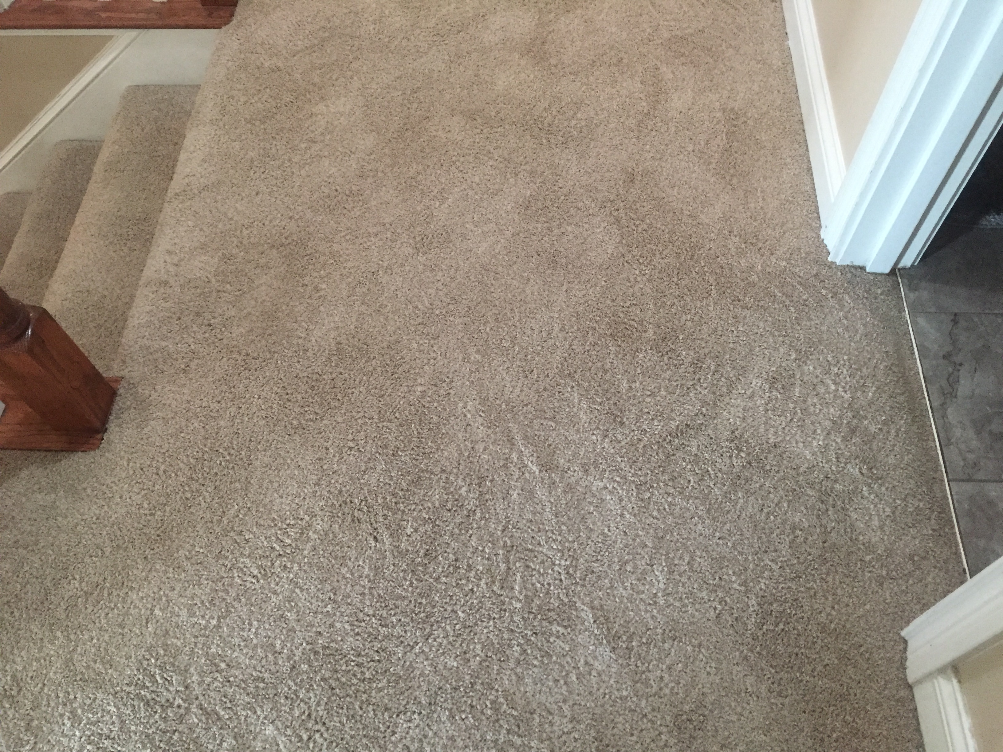

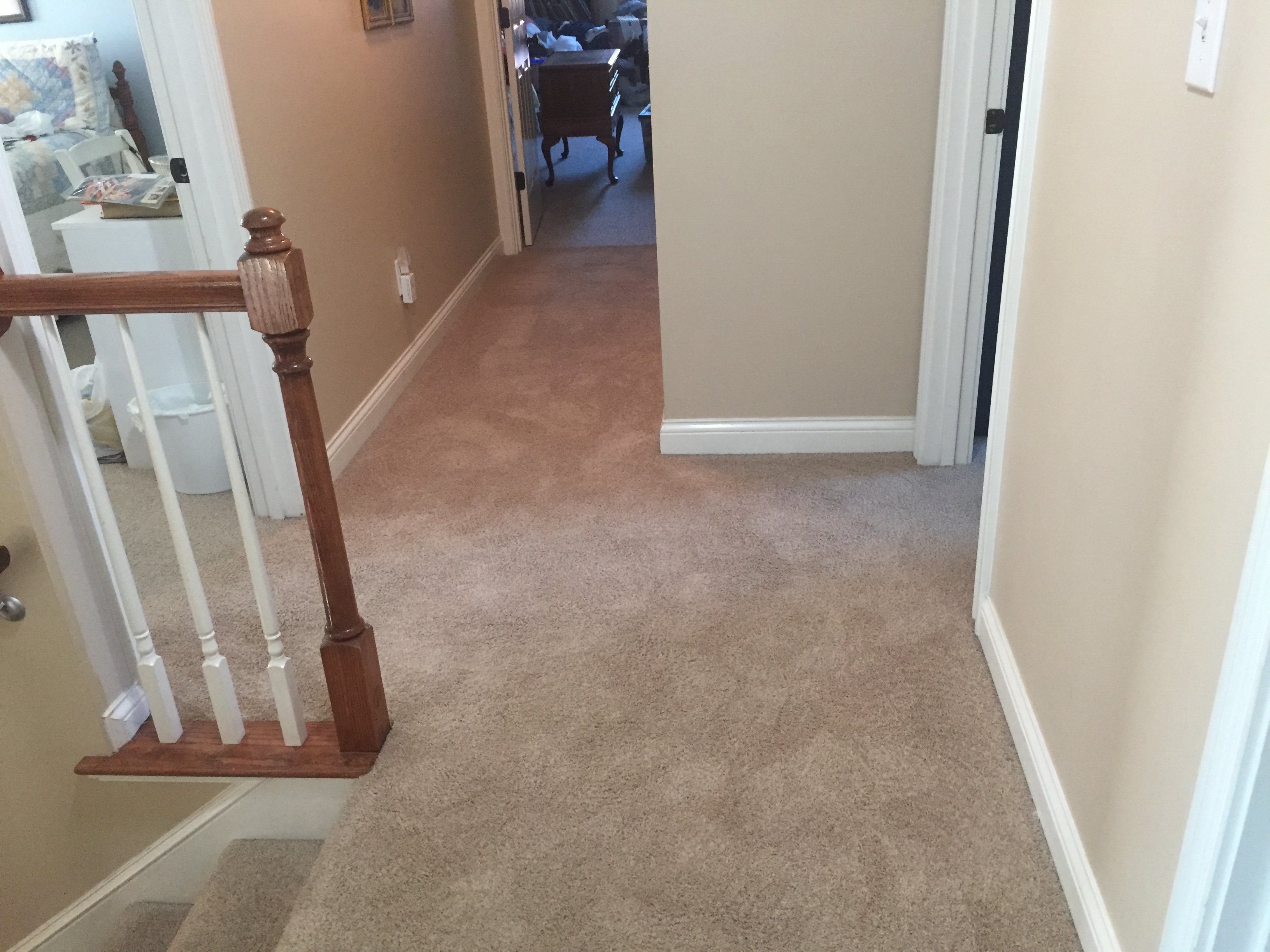

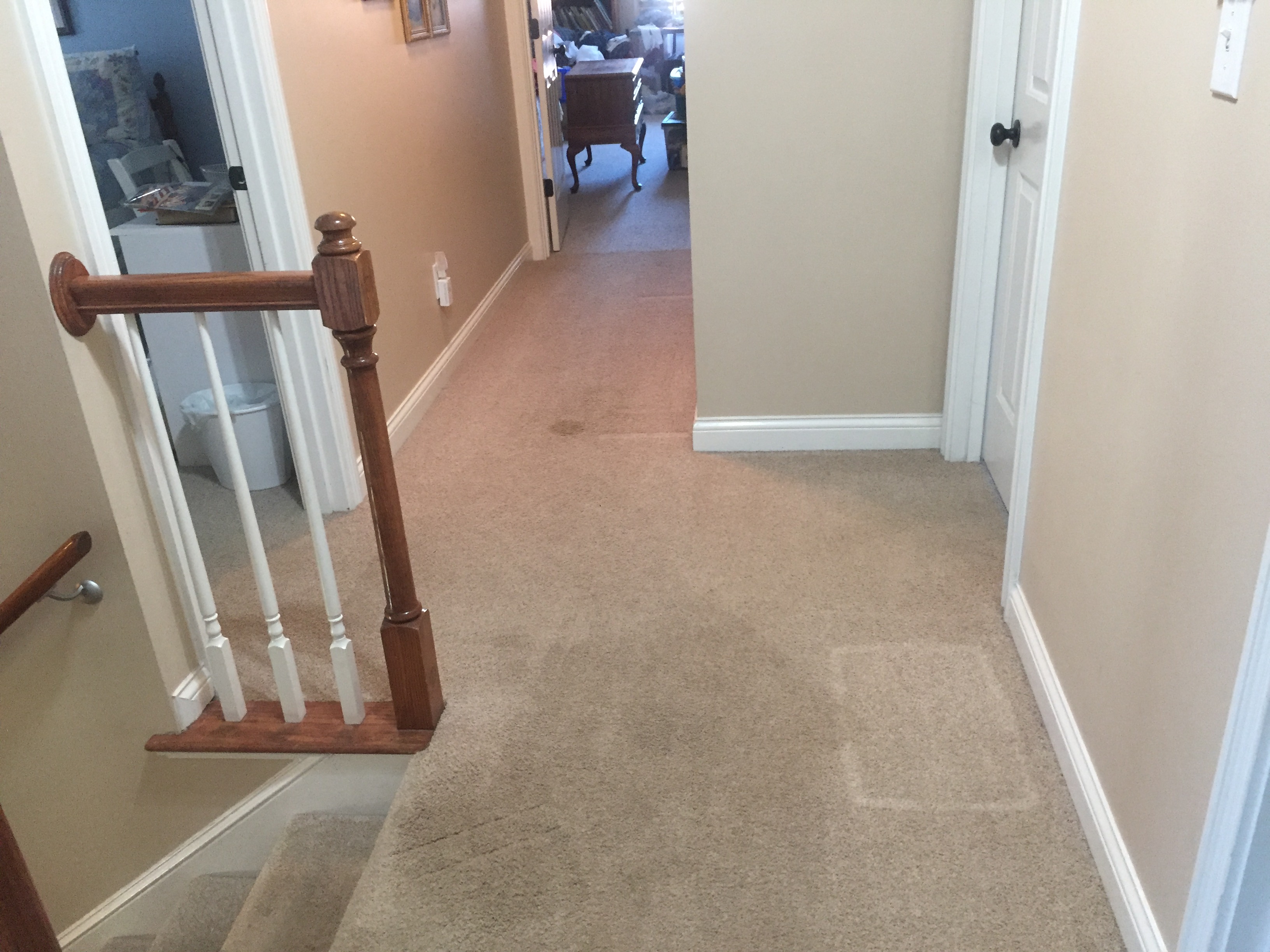

Before #1: It is easy to see where the plastic runner left adhesive on the carpet.
Before #2: The steps and landing show how soil has adhered to the residue.
After #1: Using a 50/50 mix of Citra-Solve II and distilled water, I presprayed the adhesive. I then ran the 360i brush head over it with no water or vacuum, to scrub.
Then I applied Saiger’s Free and Clear to emulsify (“DO YOU KNOW WHAT EMULSIFICATION IS?”) the Citra-Solve II and extracted the whole shitterie. Customer showed her husband the gunk pumping out of the apo hose and he lost his appetite, hahahahaha!
After #2: the whole place looks like new carpet. Job was done at .51/foot.
Not shown was a furniture stain spot from whenever; it came right out. Ditto for numerous other spots that I shot with Citra-Solve II. I plan to bottle the remaining solution for future spotting.
