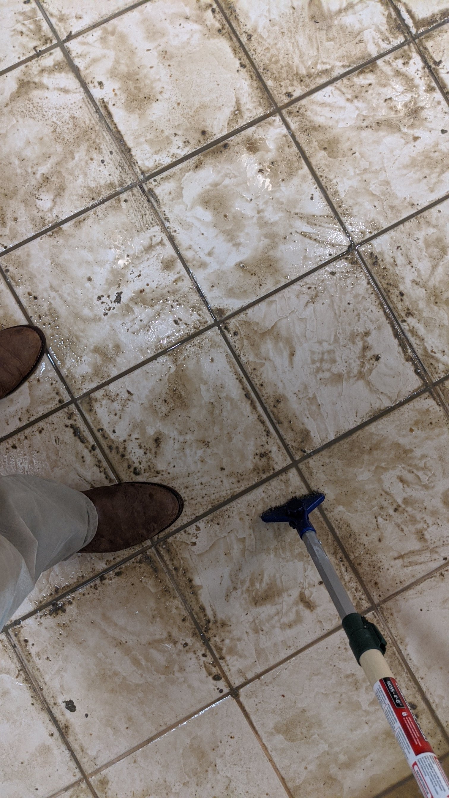

14,624
That's with double strength Tsunami, stripper boost, Nylagrit 175 super slow pre scrub and 1200 psi turbo rinse...

Looks like they had something with two front legs sitting there. Whatever it was protected that area from whatever happened to the rest of the floor.

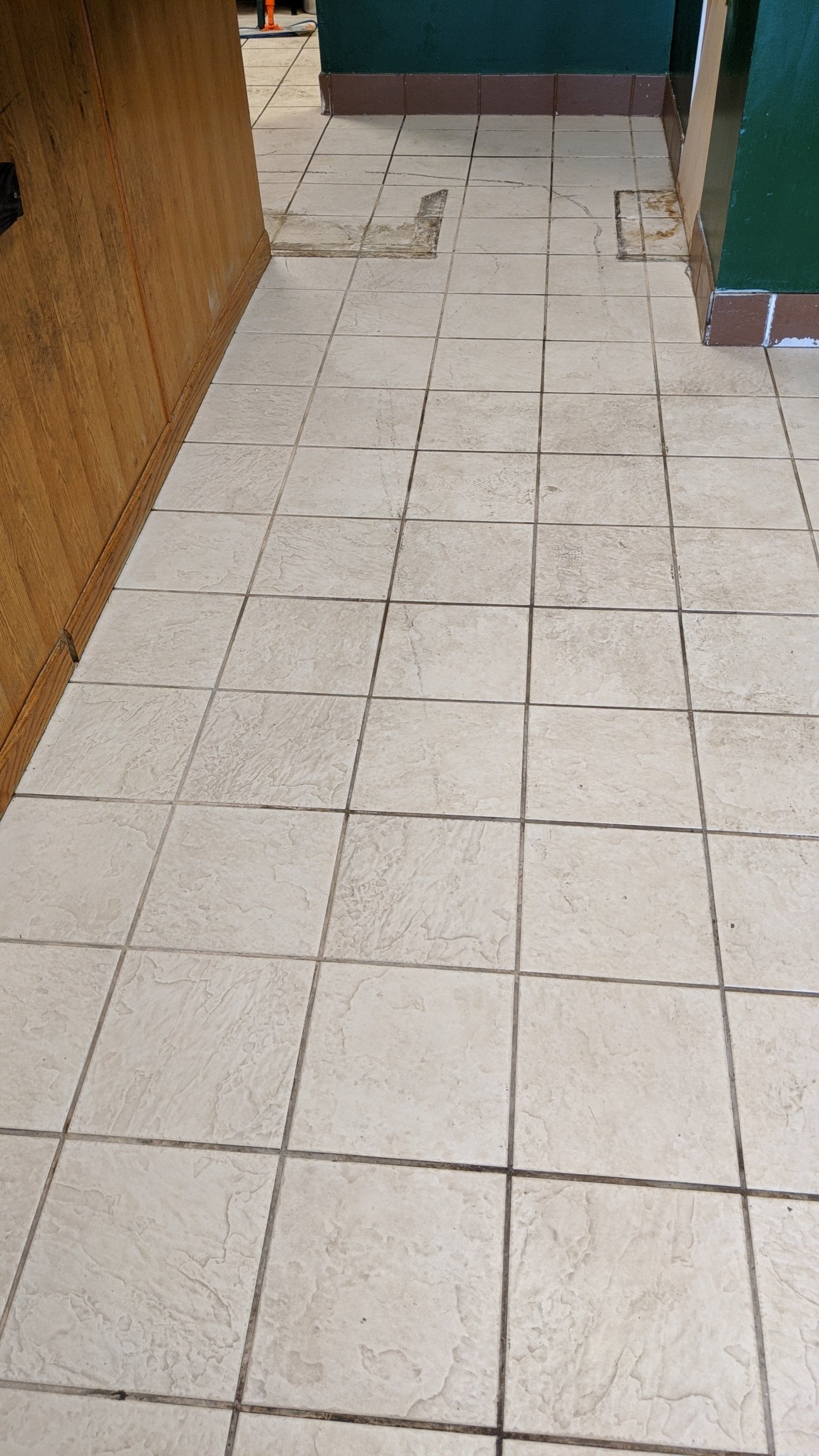

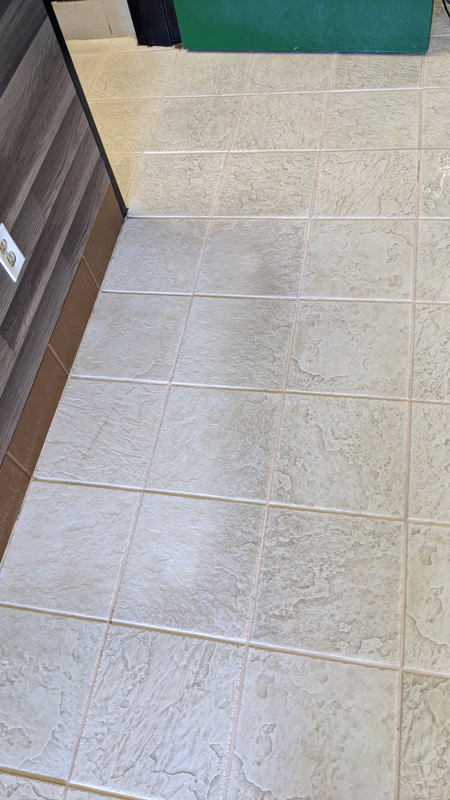

Yes it's a restaurant
where they had rubber mats in the kitchen there's nowhere like this and the tiles look perfect wherever people were walking around the furniture in the dining room created this look
117,241
Yeah I've never seen anything like it , either as Brian Thompson
and I cleaned the living shit out of it, literally.

It may have penetrated and permanently discolored it, since ya did everything you could.

If acid didn’t touch it...I know tsunami is hot, so I’m just throwing guesses out there

need to add an abrasive like lava to your cleaner, then mono with your brush.
