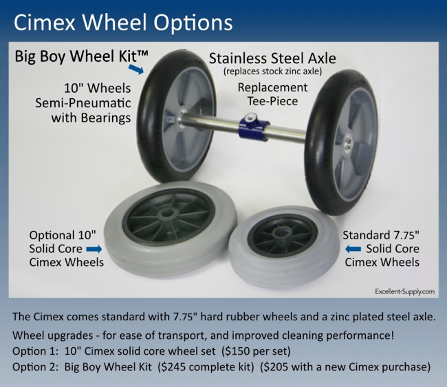

We did just knock "20 bucks off the top"... in fact we lowered the price for the compete kit $25. :)
You'd be surprised how many guys need the new Tee-Piece. In the beginning we weren't including a tee-piece with the wheel kits. But so many folks had problems getting their old axle free from the tee-piece - we decided to throw in a new tee-piece for free.

I had to literally cut the old T piece from my old axle due to it "welding" itself to the steel.
Thus a new T piece was essential.
The old wheels can last a very long time, but the ease with which the Big Boy kit makes to a Cimex is (Howard here), is phenomenal. :lol:
Not only for taking it up or down stairs, but general maneuvering with it as well.

The story behind larger Cimex wheels...
I guess the folks at Cimex never realized that the machine would benefit from larger wheels. In fact the Cimex rolled along for 75+ years on those small wheels - from the original Cimex built in 1933, till the day a wise Aussie (a.k.a. Shorty) came up with the idea of adding larger wheels to his Cimex. Then after Shorty talked up how much nicer the large wheels were under his Cimex, we took that good idea and developed our Big Boy Wheel Kit upgrade. After a few years of upgrading Cimex machines with larger wheels, Cimex has now recognized the value of larger wheels and is also offering a larger wheel option. Looks like we all have Shorty to thank for this innovation! A simple idea that led to a big improvement. Probably was inspired by the stance of the kangaroo.
