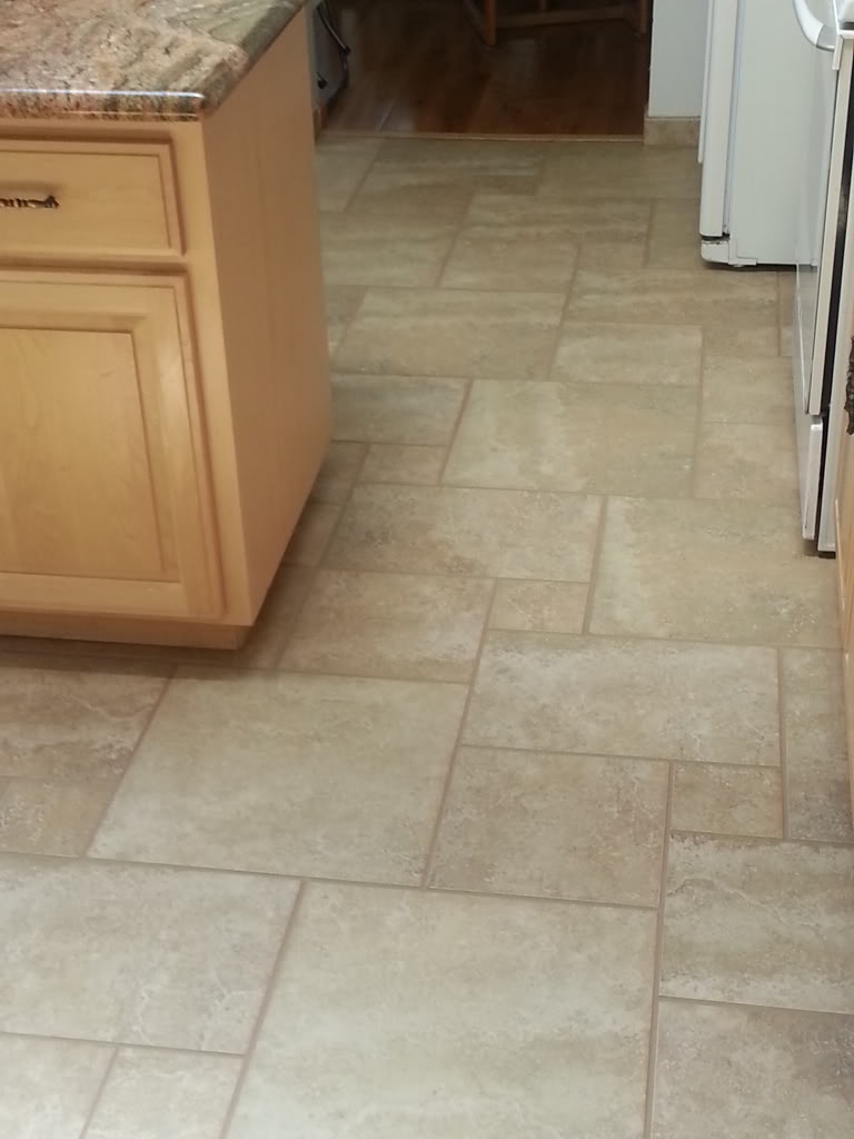

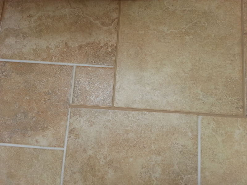

I have a color seal on for tomorrow with a pretty drastic color change..ugh..
Wish me luck.
And a one handed helper..ugh.ugh.

light to dark (summer wheat)

I used to use Grout Perfect a lot. It's pretty easy to clean. Like Mikey said, hot water and a neutral cleaner. I would just run over it with a machine and soft brush, it really doesn't take much.
116,688
yep, dont waste time over cleaning as you apply the CS.
get the bulk off and let your 175 do the work later.
