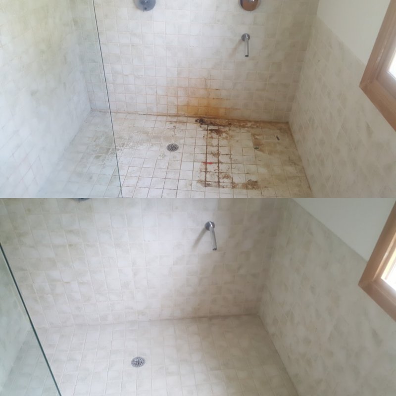

If most of the residue is soap scum with the balance hard water scale I don't bother with using a turbo tool even though I designed it. Since there's a drain in the floor of every shower I've started using a rotomax zero degree nozzle on my pressure gun at about 1500 to 1800 psi with pretty high heat to zip the history right off walls, pan, and glass. Prespray is high pH and no agitation just multiple fine mistings to attack the bond.
