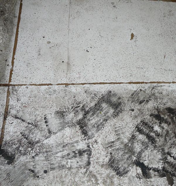

Here is a before & after TM demo I did with "forklift tracks" on rough white epoxy floors.
I did this job with only Dynachem PowerMax and a DC534 Truckmount,
since I was told it was "only average soil".
I did have to set the pressure to the Turbo Hybrid at about 1300 PSI spraying.
I can discuss the entire procedure,
if you are using the PowerMax.
Larry
