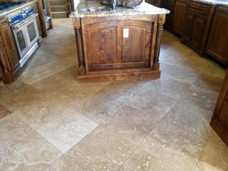

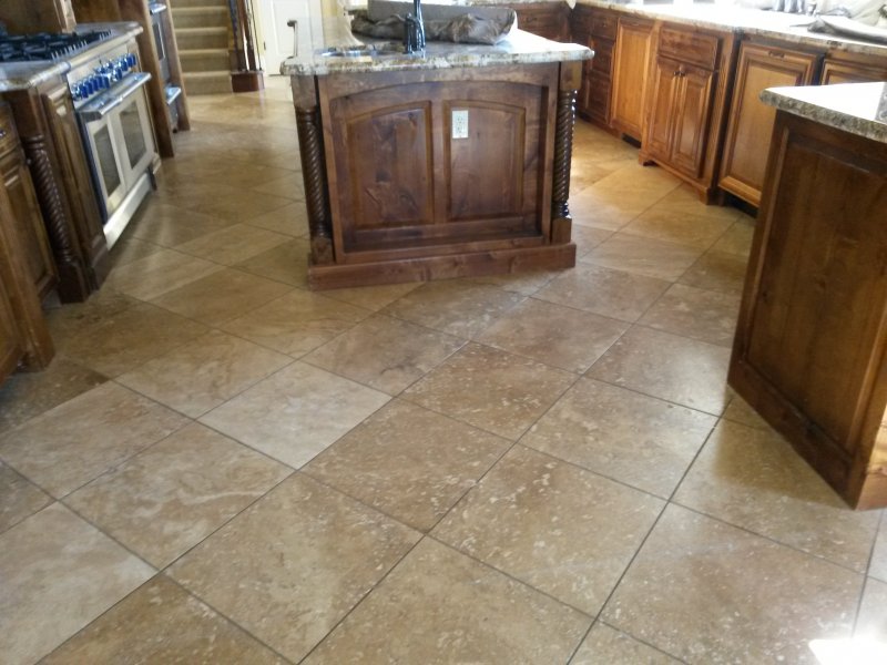

You can use Shorebest 2790 on stones like Slate, Saltillo, Flagstone, etc. Just not high polished calcium stones. Last week I cleaned a travertine floor with 2790
that was polished with a granite polishing compound making it look fake and plastic, the new homeowner wanted a natural flat look, instead of honing it, I cleaned/scrubbed/rinsed with 2790 and all was well
