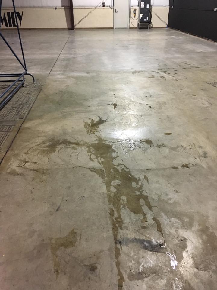

Just did a concrete cleaning job. Removed a LOT of dirt and the concrete brighten up.
But, I was not completely happy with the results. A lot of stains, etc were not completely removed.
This was a warehouse, not a greasy oil-stained garage.
Don't do much of this and not looking to buy new tools. Just want to improve results with my current setup.
What I did:
Pre-spray with tile cleaner with oxidizer.
Pre-sprayed grease, tape lines with de-greaser.
Scrub with 175 and Black scrub pad, dwell.
Tile spinner clean pass.
Final rinse tile spinner.
What can I change to improve results? Chems?
Thanks.
Back section cleaned, not final rinsed:

Concrete stains and also changes color over time.
I would say your procedure was very well thought out for best results
If doing a lot of concrete cleaning there are larger concrete blasting turbo and pressure washing set ups... But that's another investment.

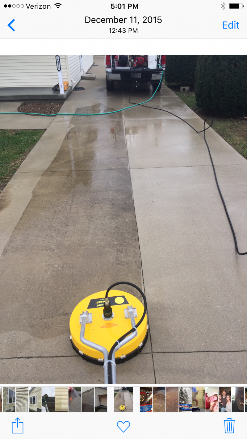

When you do any type of concrete cleaning, which is referred to as surface cleaning, pressure means nothing. Don't let anybody tell you it does. It's all about flow, GPM. The above picture you see is a 2 foot surface cleaner that's being driven by 2500 psi in about 8-10 gallons a minute. That's high flow but low pressure actually. But it's much more powerful than 4500 psi in 5 gallons a minute, although you would not think that it would be. When you use that much flow or GPM's, you will need to have a buffer tank because you were drawing more than a home or business water supply can supply. So it requires trailers and buffer tanks, etc. To turn the jets on a pro surface cleaner you're looking at almost 5–6 GPM minimum fm a pressure washer. An 8–10 GPM PW , preferable, will cost $4000 +. Surface cleaners, trailers etc. are on top of that. As I tell everybody that comes to shadow my work, welcome to the big leagues. :-) But for small concrete jobs that are very occasional, you can get away with a turbo tool & 1000 PSI. It's just very very slow. The driveway in the picture above this post I think was 10 feet by about 220. With my Tools I cleaned that from dirty to looking brand-new in about 40 minutes. - $300 . do the math on why am on the outside working and only doing carpets until noon. Cheers
When you are putting out 8-10 gallons a minute, how do you get out of your own way?
If the water is not being extracted, does it not pool up right away?
SteveCleans
Apr 20, 2015
26
steve Dobson
Good question but the answer is no. It's almost all outside and most sidewalks & driveways have a slight drainage angle to them so the water will gradually move down and slide off of the concrete into the grass. I clean X amount of square foot and then I unhook my high-pressure hose from the surface cleaner and hook on my gun with a three or 400 psi tip and I spray everything off real quick. It looks brand-new. And I hook my surface cleaner back up and clean some more and repeat the process
