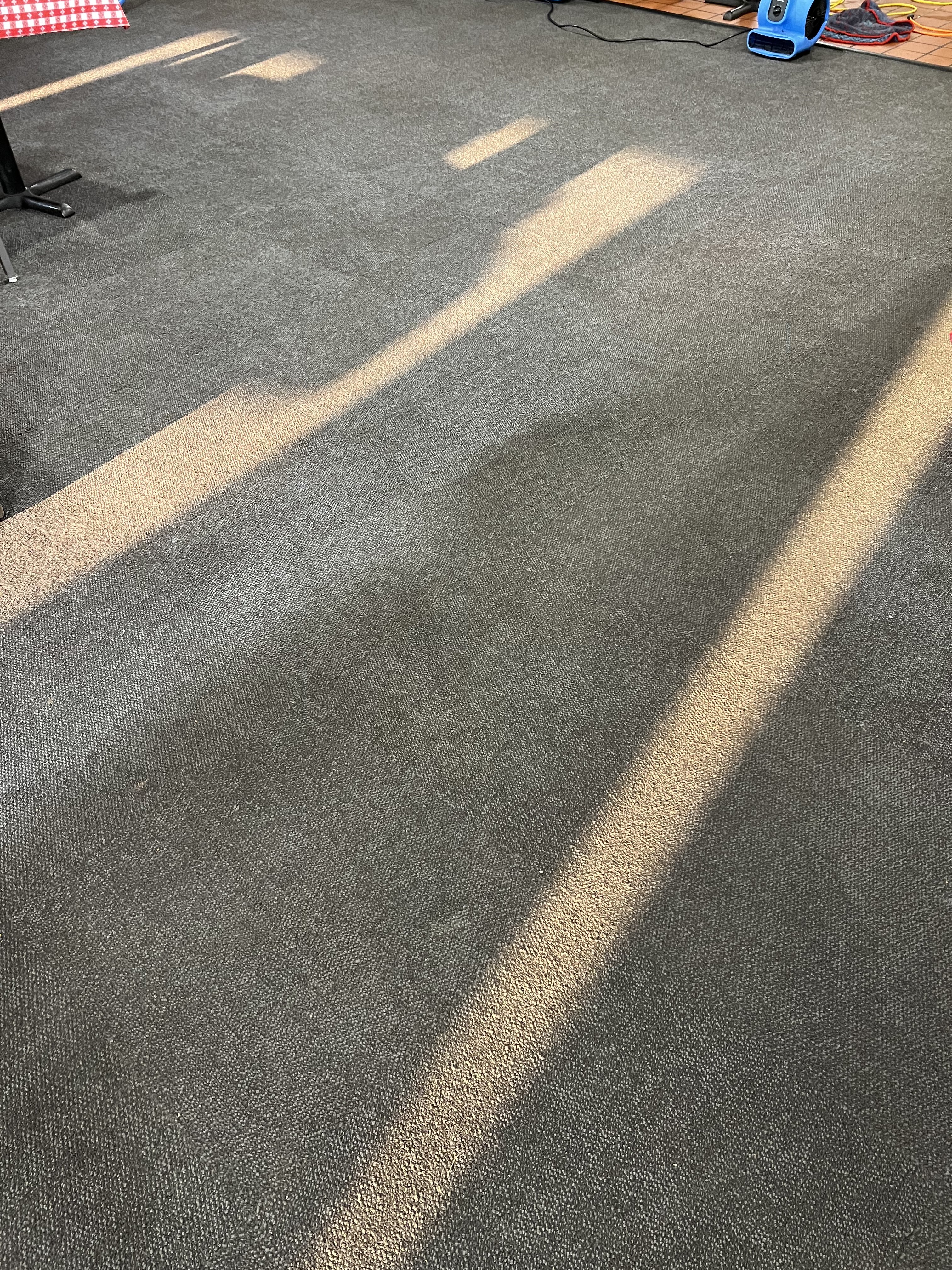

I wish I had pics to show you, but VLM was not an option. It had restaurant typed soil in a hallway and needed several areas of adhesive removed from covid tape. I appreciate the suggestion, but HWE was the only option in this case
I do have 2 quarterly accounts that are eventually gonna start getting VLM because their not gonna let me go up in price, so that will be my preferred method very shortly
Here are some pics from a Pizza Hut my son and I knocked out one morning using VLM. It’s actually the “retro” Pizza Hut in Hillsboro, OH that went viral on social media a year or two ago.
I had my boy running a Cimex with grey pads and scalding hot cleaning solution (Commercial Magic @ 4-5 opg) followed by the TOPS Phoenix running blue microfibers and more Commercial Magic @ 2 opg.
It turned out well and stayed looking great for a couple months.
Don’t be afraid to try VLM out on the more challenging cleans. The chemistry is getting pretty good these days.
I’ve also had success removing adhesive residue as well.
