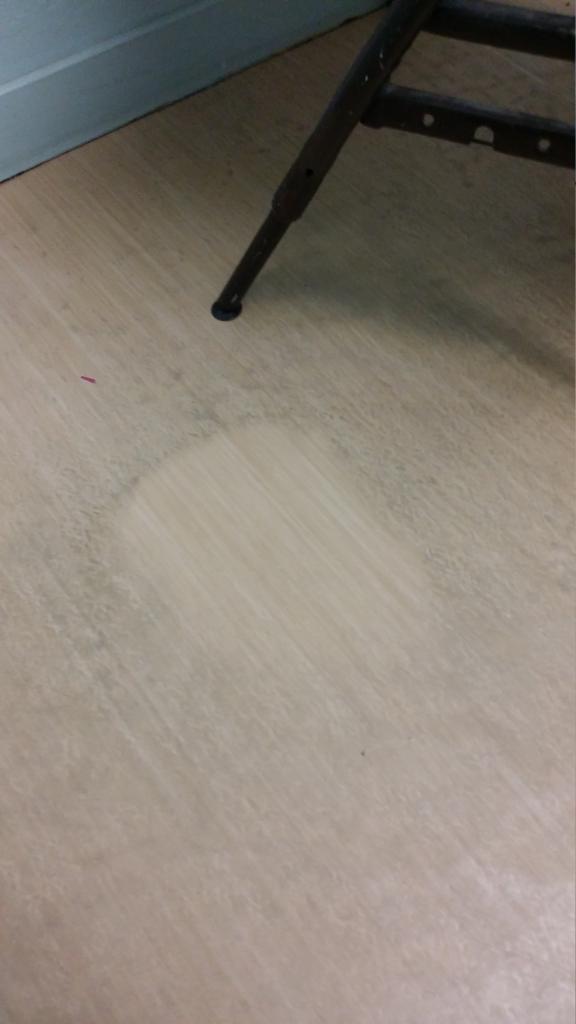

Customer does not want this VCT refinished, just stripped..
116,050
They don't want to have to deal with the buffing, stripping and resealing all the time in 20 small exam rooms.
I tested some areas and the funk came right off with a 3M scub pad and some Devastatro stripper.
Looks like just Fabuloso build up
How will this type of Vinyl perform with out a top coat of any kind?

It won't. It'll get scratched, scuffed and dirt imbedded that won't come out with a witch doctor. Any guess how many mil the finish (clear) vinyl is?

I have one Friday, and I haven't done one in like 15 years.. Kind of anxious about it.. I did a test area and it cleaned up great, but it's out of my comfort zone..

I agree with Willy.. You have to maintain the floor or it will look like shit. If they have it done once or twice a year, what's the big deal?
A planet far far away
If you do it get them to sign off so you are not responsible for how it will hold up down the road.
Not that the paper will mean much but it will show them how serious you believe it needs protection. It will also provide proof later that you warned them, when their cost savings measure ends up flopping.

Oh don't have to put down an shiny coat of finish, there are plenty of no shine or flat finishes available.
It will be an issue in a year or so.
