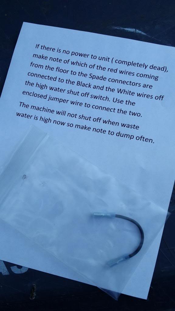

The high water shut off float/switch on the 2004 Vortex has been a royal pain in the arse over the years.
Works fine for months or years than out of nowhere it starts killing the complete power to the unit at the most random times.
Last week it went down and killed power mid job so I had to walk my kid through un-wireing it and continuing the circuit on site. I dont even want to know where he found the wire to do so (customer's garage, something about a lamp) but he got it done and the V worked a few more days
With a huge thanks to Jim Far More Worthy Than Marty, Martin I was able to redo all the fried wiring and replace the connectors with far easier to use water proof spades and even came up with this cool idea for the next time the demon shows up and I'm not around..
This will hang from the Harwell switch...

I'd laminate it and then start a "Trouble Shooting" binder and put stuff like that in the unit so they can turn to the binder before they call you.
Even if its stuff you've told them before they may not remember it step by step. You can even add in photos to help them. It will be a pain to get it started but could keep it from being an issue when you're out on one of your bike rides.

No bob it is a harwil microswitch with a float assembly.

Harwil have the best float switches out there..........on my old Vortex waste tank....I had a shield protecting it ....I don't know if Mikes does or not but it has been his Achilles heel for as long as I can remember.....
Jumper wires are your best friend......take the time and make a few up and toss them in the glove box...you will be happy you did one day.......

You can't just unplug it. Pull it and replace the micro switch. The companies right down the street from you.

If you drive your TM in Hilly areas such as SF and maybe your area Mikey-- The floats in the Waste Tank AND Mixing Tank can become stuck when the water is sloshing around when driving around-- and thus telling your TM to shut down..
