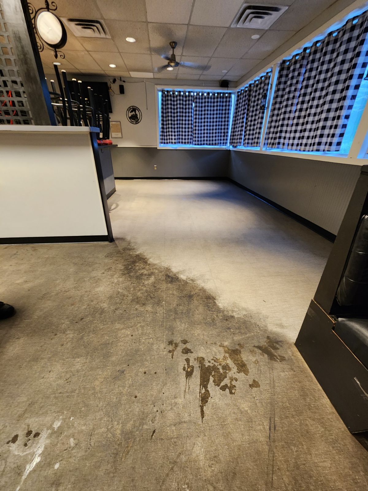

This place was disgusting. Didn't realize just how filthy it was until we got into it. A mentor of mine strongly encouraged me to stay away from dirty restaurants. Now I know why. We got stuck at this place way longer than expected. And didn't charge nearly enough for it. Such is life as a newb. But it's super local and we are friends with the owners so I figured we'd go for it. Good learning experience.
They have LVT floors which seems like a dumb choice for a greasy diner. I recommended afterwards that if he ever gets the floor replaced to go with synthetic carpet or tile and grout as they can be cleaned and maintained much more easily. We used Biobreak at 9.5 to 10pH, blue brushes on our crb, and 400 psi with Mike's hard surface wand. First pass looked unacceptably streaky with grease so we gave each section a final spray, scrub, and wet mop to level it out.
Spent 30 minutes cleaning the filth off of our hoses, cords, and everything after midnight to go back into residential the next morning.

How would you clean the wet nasty grease off of a hundred feet of hose connected to your tm to be prepared to go service residential afterwards? For us it worked out because we use a 15 ft solution/vac hose connected to our portable. Just coiled it up in their kitchen sink and blasted it with hot water, along with everything else. Felt like I was violated after we cleaned the place. Seemed like stellar results with our puny setup though...

I charged our standard .27/square foot com rate because I had no idea. Came to $370. Funny though. The owner messaged me the next day and said "you guys killed it!......" I told him I'm very happy to hear you like the work we did, to be honest we got spanked and were there until 2am.
When we spoke on the phone later in the day he was concerned we may never come back, he wants and needs us desperately. I told him we have to go up on our price, and his crew needs to shift all the furniture to one half of the diner before we begin. We'll shift it to the other half midway through cleaning, and then his crew can reassemble it the next morning. He's into it. He's also giving us much more money than we quoted him for this first job and free breakfast this Sunday. Earning my stripes, learning the ropes, making friends, and getting by. I'm glad we did it to be honest. I'm slowly becoming a professional cleaner through the school of hard knocks.

What can I recommend to the owner for his own maintenance? He was ill advised getting an LVT floor in a greasy diner environment, but it is what it is and I need to give him the best advice that I can moving forward.
The standard recommendation I've seen is neutral pH no rinse cleaning agents for the home owner/business owner. However without mechanical scrubbing I have a hard time believing that will really cut through the grease in an environment like that. What I've advised him on thus far is to scrub the floor in some way at least once a week before continuing with his normal wet mopping procedure to break up and emulsify the grease that can then be mopped away more effectively. I told him he can use stiff nylon brushes from a box store, or buy a small 13" used 175 machine with an appropriate pad to speed up the process and make it easier work on his crew. Then moving to flat mops rather than spaghetti mops to reduce simply spreading a greasy film around.
I guess what I'm really interested in is A)is the above advice sound and reasonable for a business owner that is genuinely trying to better maintain his greasy LVT floors? B)what is the most effective yet still safe cleaning agent I can recommend to him that doesn't require being rinsed away (can he safely use something 8 to 9 pH spiked with de-greaser with no rinsing)?
Side note we had a nice conclusion to the initial cleaning this morning. The owners were thrilled to see us at their diner for breakfast. They treated us to a free meal, several mimosas, and they wrote us a check for $500 (we only quoted him $360 for the job). They love us, we love them. What a great experience...

Will neutral pH degreasers, mild scrubbing, and flat mops be sufficient for his crew to take better care of it?
I used Biobreak at 10 pH boosted with Citrasolve neutral pH degreaser...
9,255
Yukon, Oklahoma
So, the good news is they won’t be able to. That’s why they will actually need you to come at frequent intervals. They can mop with neutral cleaner daily and from time to time with a degreaser. THEN, you can come in a do what you do mechanically to help them out. That’s the same as vct programs that we provide with daycares, schools, and churches. Thats how I make a living😃 Well, used to.
9,255
Yukon, Oklahoma
The degreaser will leave a residue but obviously #deepclean the floor. But, the next day they can use the neutral cleaner to help with residue. The residue won’t be as noticeable on lvt as vct. You can still buff it off with either with a high speed buffer. That’s why I pull a trailer😬
Bio Break is NOT THE PROPER chem for this job…
1: use Prochem Ultra PAC Extreme
2: mix @ 3 oz per gallon, into the hottest water available
3: pour the required amount of mixed chem onto the floor
4: use a flat mop to spread it out
5: use the CRB to aggregate BOTH directions (north south, east west)
6: extract; (starting @ the point where you bring your hoses in), working to the furthest place you agitate.
7: use a squeegee to draw the extra water to a point where you can extract it.
8: using a CLEAN flat mop pad, go over the entire area…
Collect cheque, repeat the process on the next job.
Oh, and go to Costco, Sam’s Club, whatever, and buy a dozen off white bath towels…
You’ll need them…
  • Love
Reactions: Bryce C
Bryce C
DFW
Feb 9, 2024
586
Connecticut
Bryce
You’ll need them…
Thank you this is all super helpful
Prochem Ultra PAC Extreme has a rtu pH of 12. I was under the impression that high pH cleaners could damage vinyl flooring.
I was seeing streaks of grease after my first scrub and extraction, do you think that may have been because I didn't scrub in a cross hatch pattern like you recommend?
Jun 20, 2016
6,527
Bc
Jeff T
The streaks were prevalent because you used a chem that was not suitable for the job.
If concerned about the elevated PH, add a little acid rinse to the equation…
That floor is not going to look new whether or not you neutralized it…
Will it look better? Of course!!
Wii it look new?
No.
Lack of maintenance is the clients problem, not yours.
