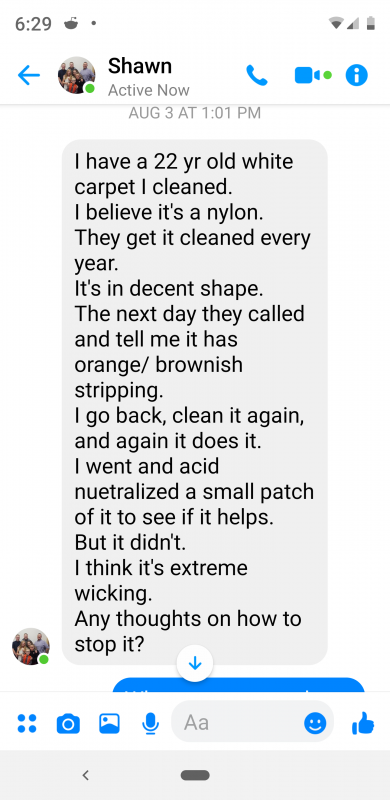

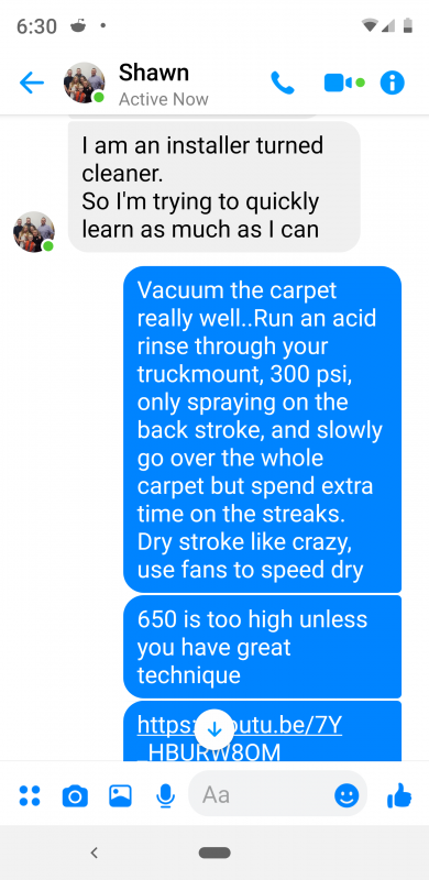

650 psi!? :hopeless:
You don't get paid more for cleaning the padding!
