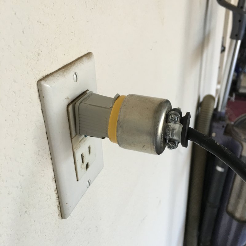

Reversed the black and white on the three prong plug plugged it into a regular outlet worked, plugged it into the gfi plug and it popped the gfi, but not the breaker in the breaker box.

Because they are looking for a ground fault to save your life. It matters how they are wired.

With the adapter you disconnected the ground. Without the adapter the ground is shorting out. The cord is fibered wire could be just a strand of wire touching what it shouldn't be.
