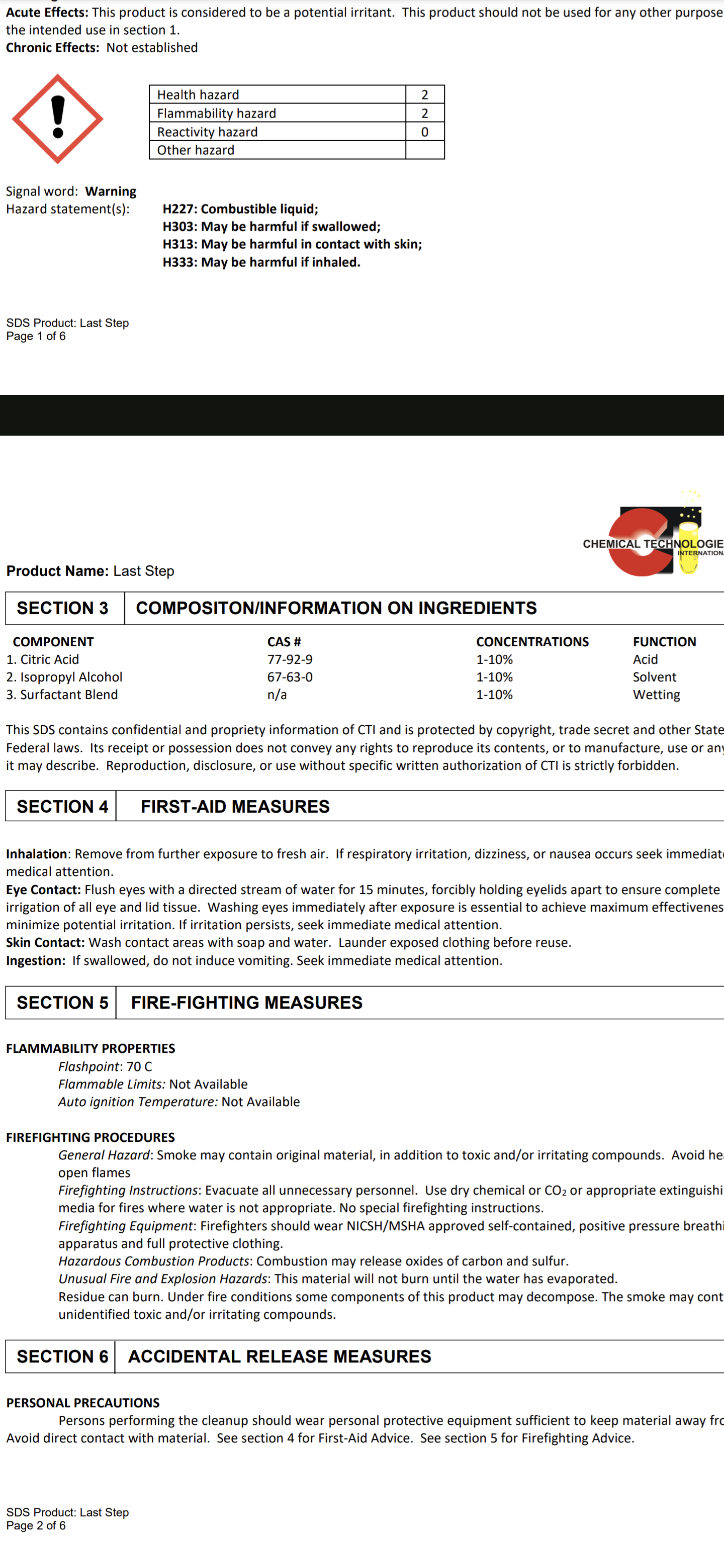

Lea put alcohol in 02 rinse CTI uses it in last step rinse. I believe prochem used it too.
Reactions: Condog

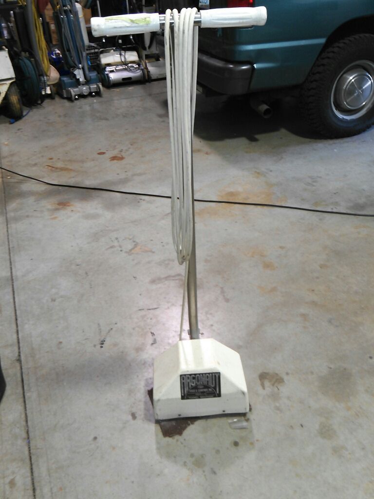

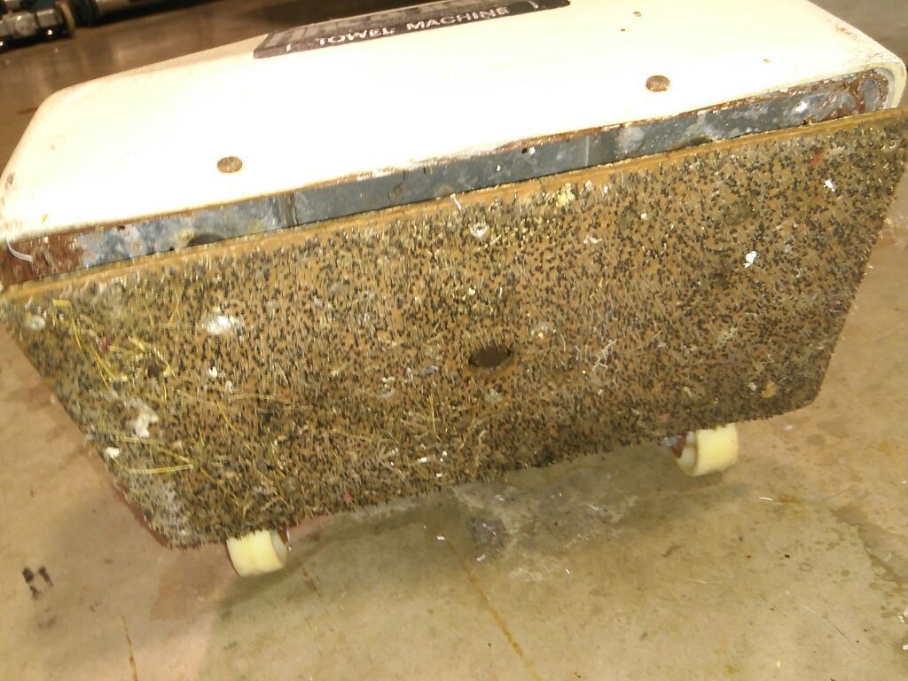

Didn't they have a square pad machine at one time?
Reactions: Jim Pemberton
Yes...argonaut
ARGONAUT PLUS TOWEL MACHINE
Reciprocating motion 16 1/4" x 10" stationary pad holder 15 pounds, 115 volt, 1/8 hp motor, 5 amp , 1700 rpm free. Use with ARGOSHEEN and all cotton pads for removal of soil. Also available with 220 volt motor for Europe.
ARGONAUT SUPER TOWEL MACHINE
Reciprocating motion 10" x 12" or 16 1/4" x 10" stationary pad holder, 35 pounds, 115 volt, 1/4 hp single phase motor, 5.6 amp , 1725 rpm. Use with ARGOSHEEN and all cotton pads for removal of soil. Also available with 220 volt motor for Europe.

Releasit does contain Isopropyl Alcohol. But it's not a "main ingredient".
Reactions: Condog
