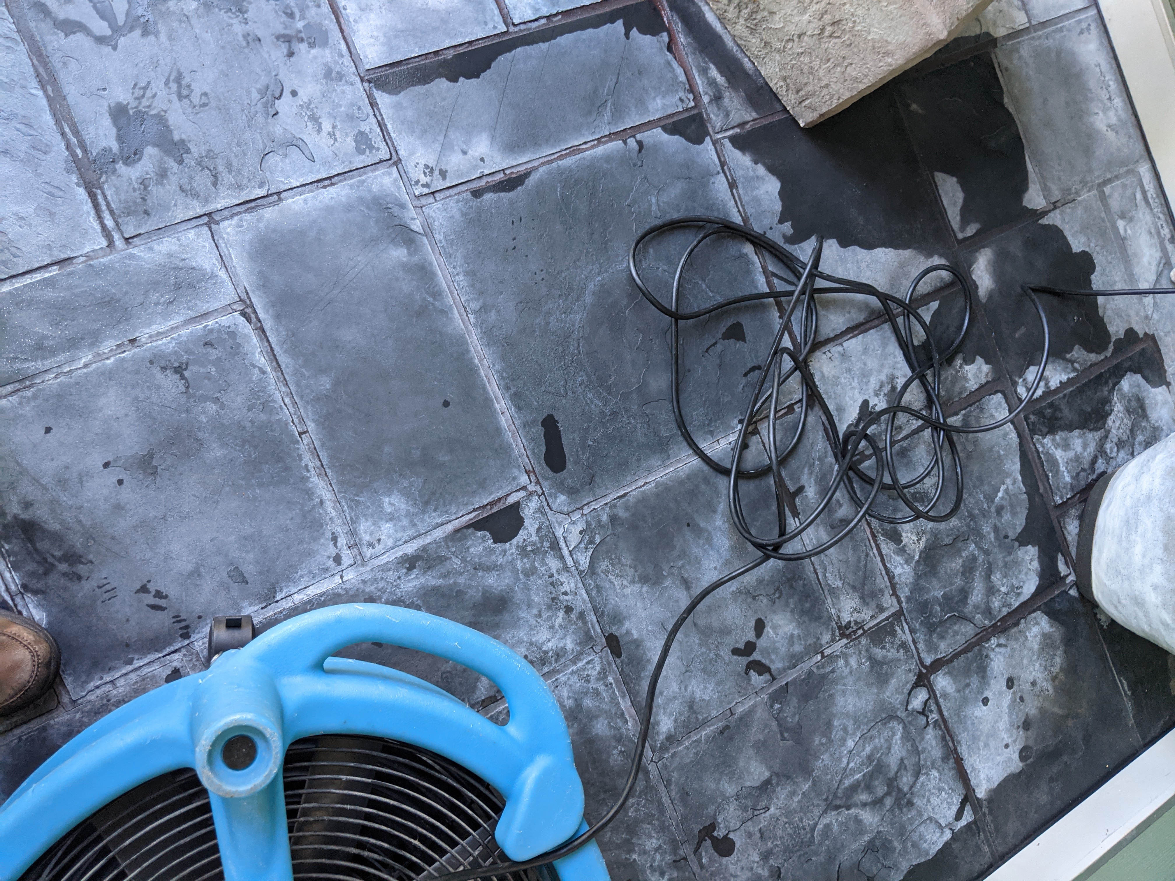

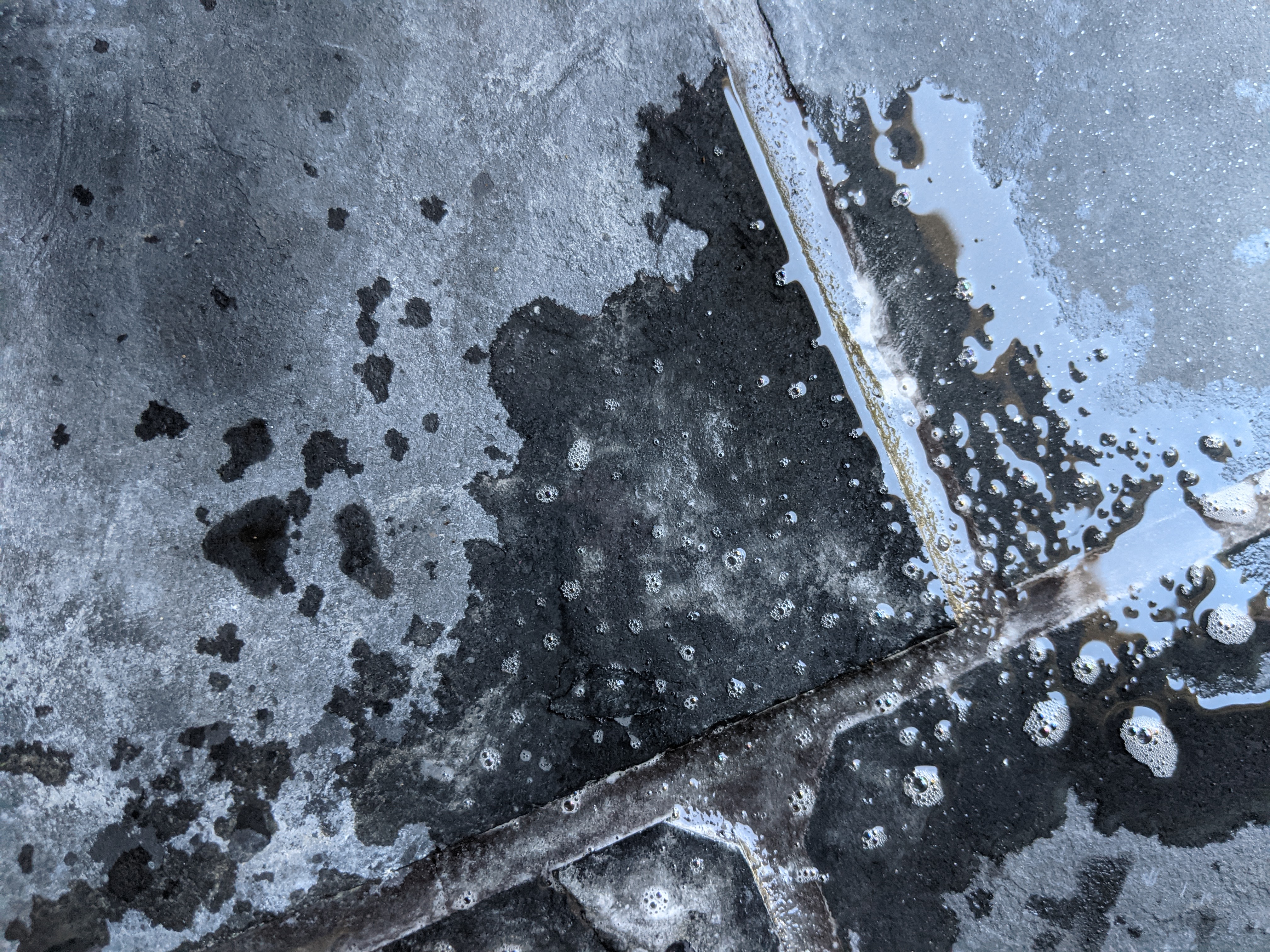

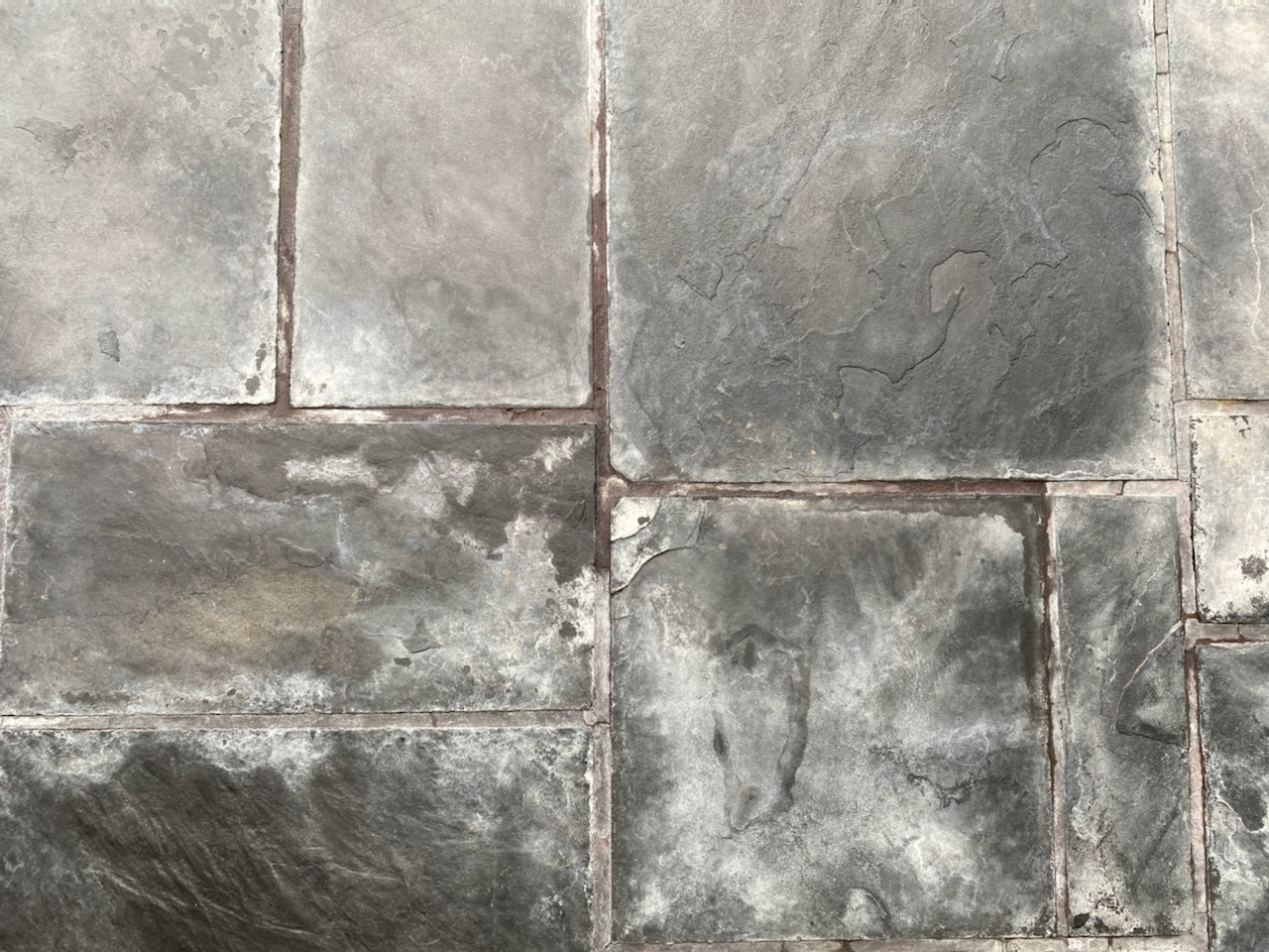

A customer contacted me to remove efflorescence from outdoor slate that was beneath a fountain for years.
On Sep 2, I applied Pro's Choice ProAcid 1:3
Scrubbed with black brush Brush Pro.
Dwell 20'.
Rinsed with Turbo.
Dried with Airpath.
Minor impact.

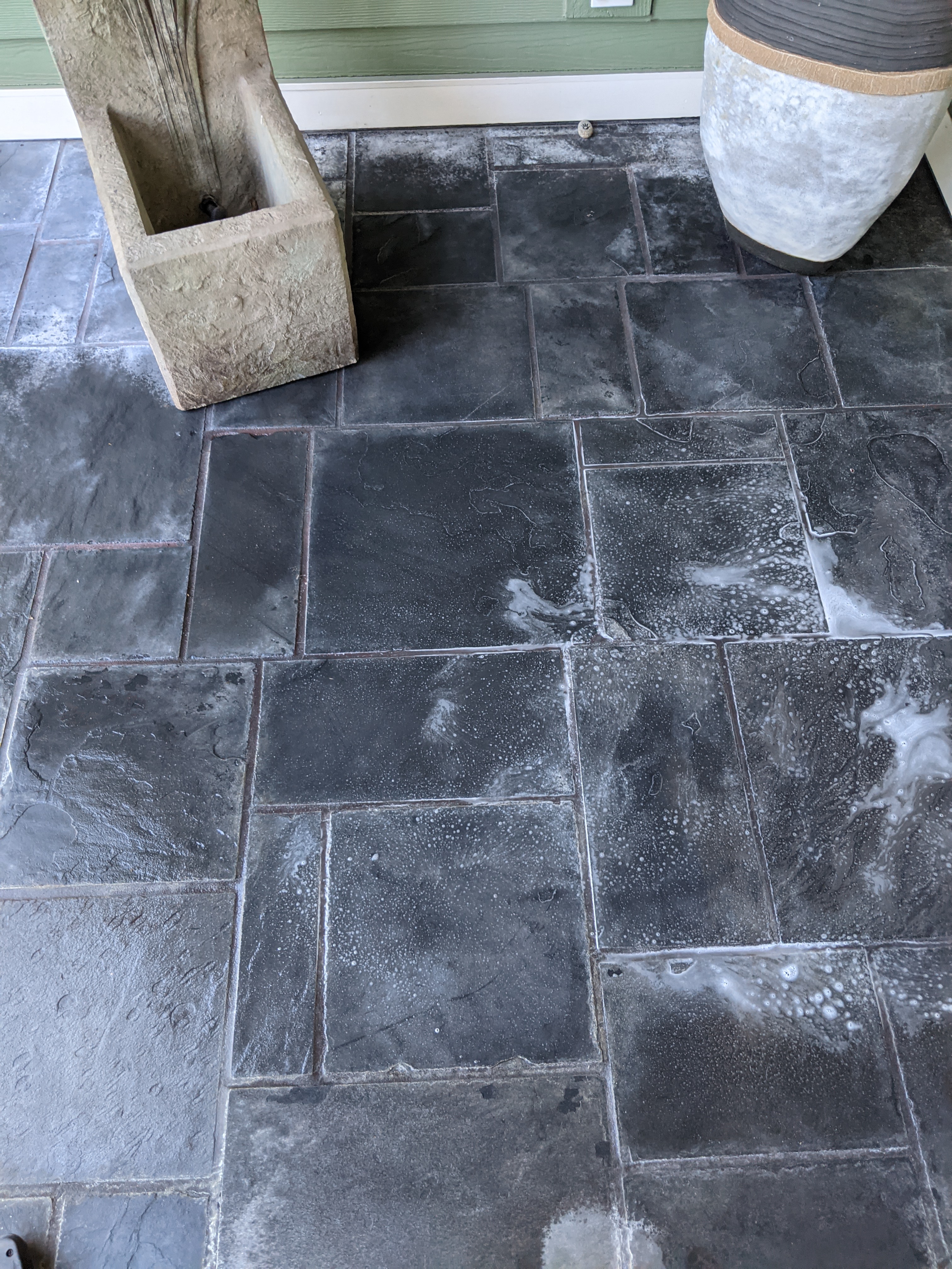

The tile in the best shape is a result of customer pressure washing previously. I put ProAcid straight up in a pool and asked the customer to rinse away when it evaporated. He sent me the result yesterday, Sep 3. No joy! (image no.4)
How do I remove this efflorescence? (I believe it comes from the Thinset, which is white).

There is no fixing that Sarge.
The more you get it wet the worse it's going to make it.
You would have an easier time trying to stop waves at the beach..
and don't listen to our dopey pig peddler who's suggestions are about as stupid as throwing suntan lotion at the waves....
It would work great on those tiles
If only they weren't installed...
I don't know if it will work or not....worth a shot I suppose
I just put the direct link to the product because Marty didn't seem able to

I am determined to win. Gonna order two gallons...Marty...don't know the application rate. Big bucks for shipping so I hope it is potent $330! I can use Airpaths to flash dry to minimize cap effect, Mike. Then impregnate. DryTreat?? I'm not pulling the trigger until ya'll comment.
Holy shit.....I'd have probably just picked up some low fume muriatic acid instead....but I guess there is more room for error here
as far as application rate
also it looks like other places sell it so I'd see if I could get a better shipping rate

How many days of rain per year does that porch see?
Michael Ellis
Oct 8, 2006
113
Michael Ellis
The porch is under cover on the north side - no rain. He had a fountain spilling on it for years. It's gone. The slate on the exposed pathway looks better - I joked it looks better because the rain rinses it. The Thinset is white like the calcium - he had several removed when I took this image.
116,693
Good luck and don't promise anything.
