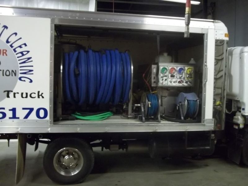

That is one of the joys of modern day carpet cleaning. My electric reel winds up each 50' hose length at ten seconds per. Really nice when your arms are beat to a pulp at the end of a job.

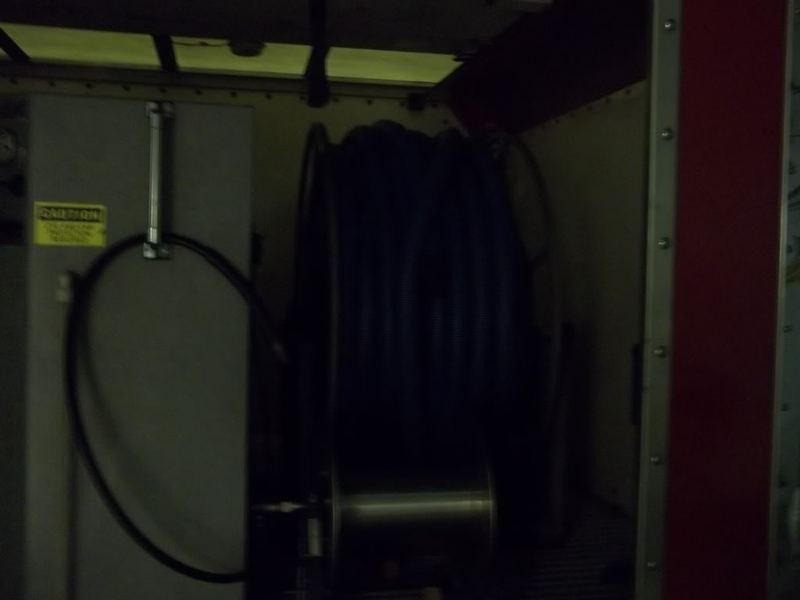

I will time the reel on my 777, i think it's pretty fast. It will definitely pull your feet out from underya! thathurts
Erik
Jun 3, 2007
1,508
Erik
I had 400' on the chain driven hose reel on my Vortex 777 & it pulled in the last 100' in 12.5 seconds, it ran at 66 RPM's.
Also, I had 400' on the gear driven hose reel on my Vortex 6008 & it pulled in the last 100' in 19.5 seconds, it ran at 46 RPM's.
I can measure the sprockets on the chain drive, if you want.
No one was injured from flying cuffs conducting these test. shiteatinggrin
