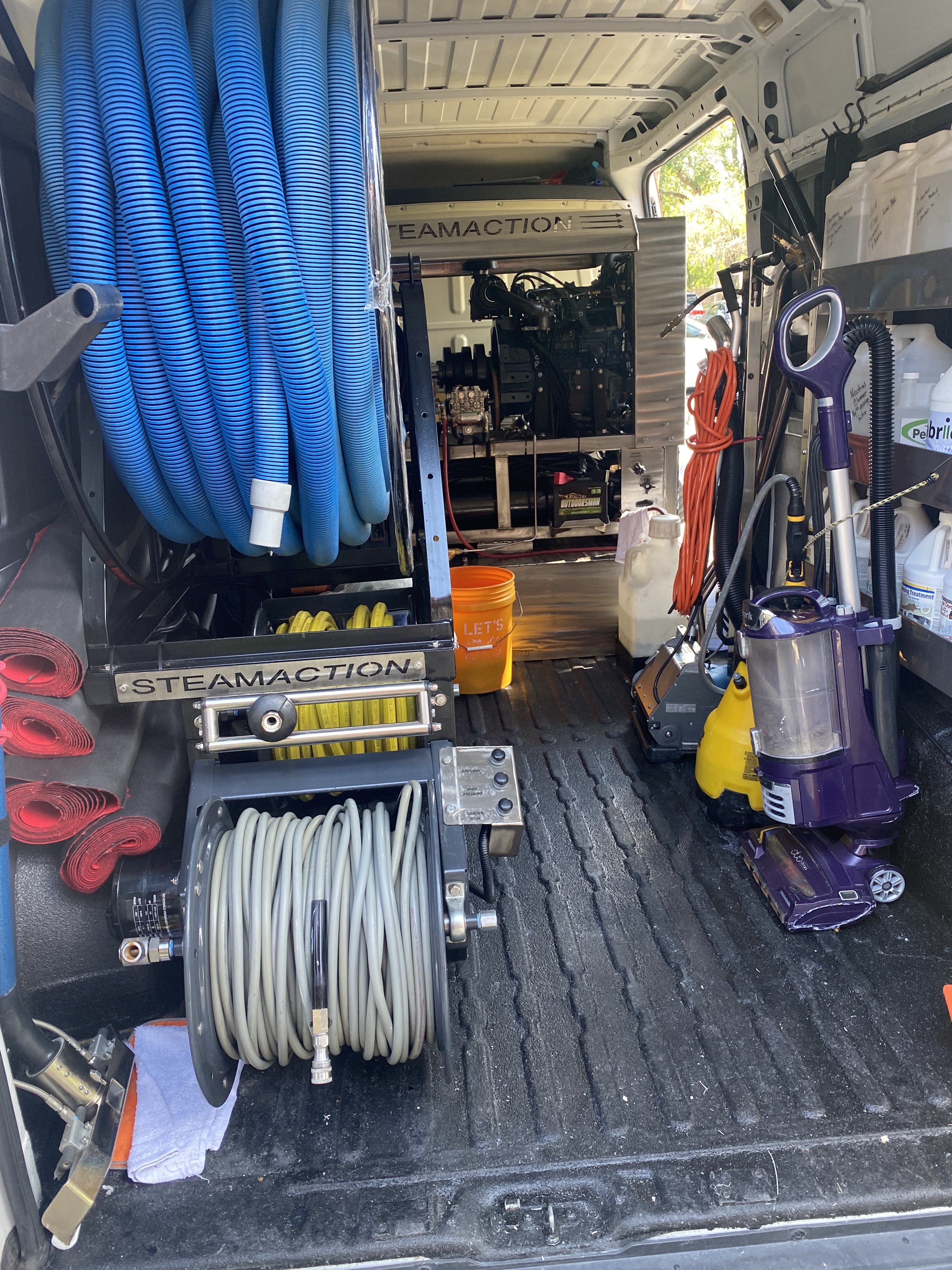

It's a must have for owner ops. You're wanding all day, the last thing you want to do when you're tired is roll up that vac hose. I waited 14years before I bought mine. don't worry about how much it costs. Just get one. The one from steamaction is the most impressive. And there's a dude in Atlanta that makes one similar. I can't remember his name. Someone on here can highlite on that. He made crappy garagemade truck mounts before he switched to hose reels

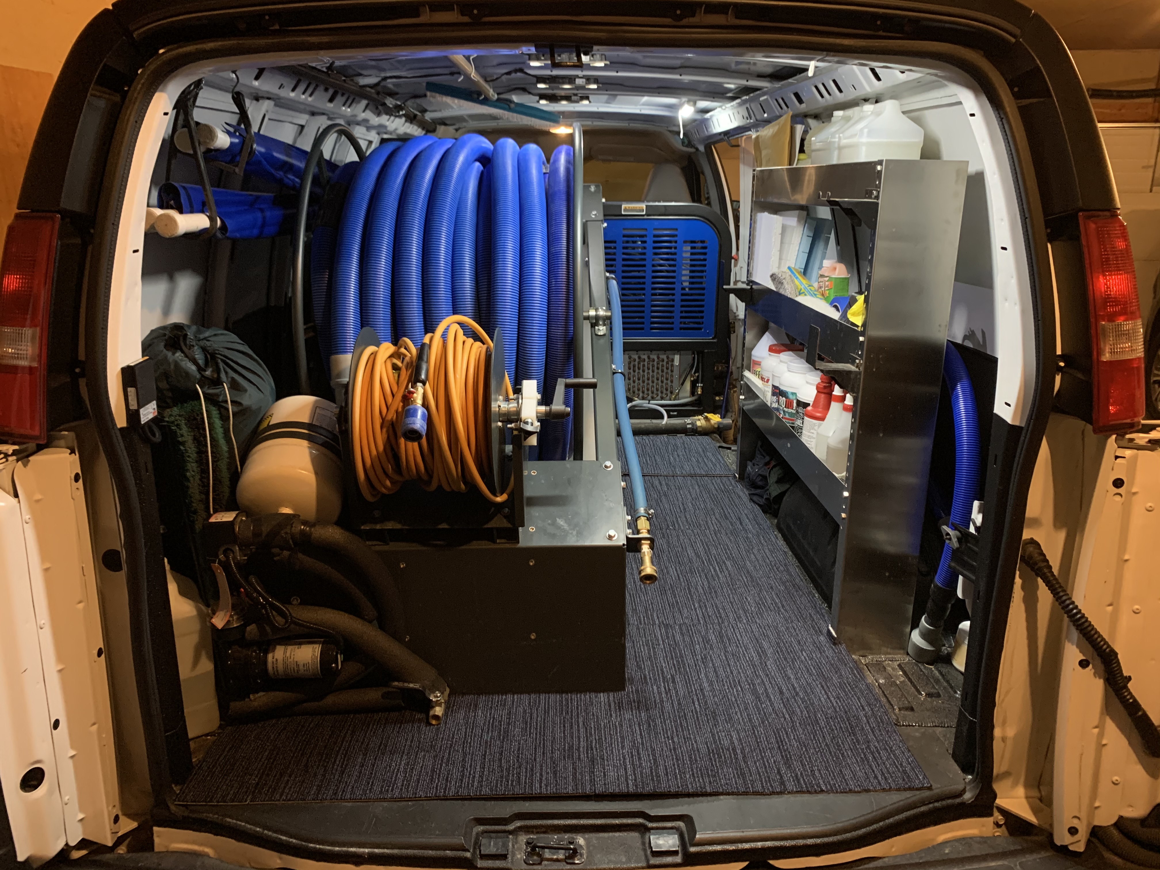

Best electric hose reel is a Water Pond, hands down. Comes with a free water tank! IMG_3868(1).jpg

Best electric hose reel is a Water Pond, hands down. Comes with a free water tank!View attachment 116718

I found a screaming deal on a water pond a while back, like 2k for the 6k unit but could not find a way to make it work in my van without completely ripping everything out and putting it back together. Maybe on the next van.
