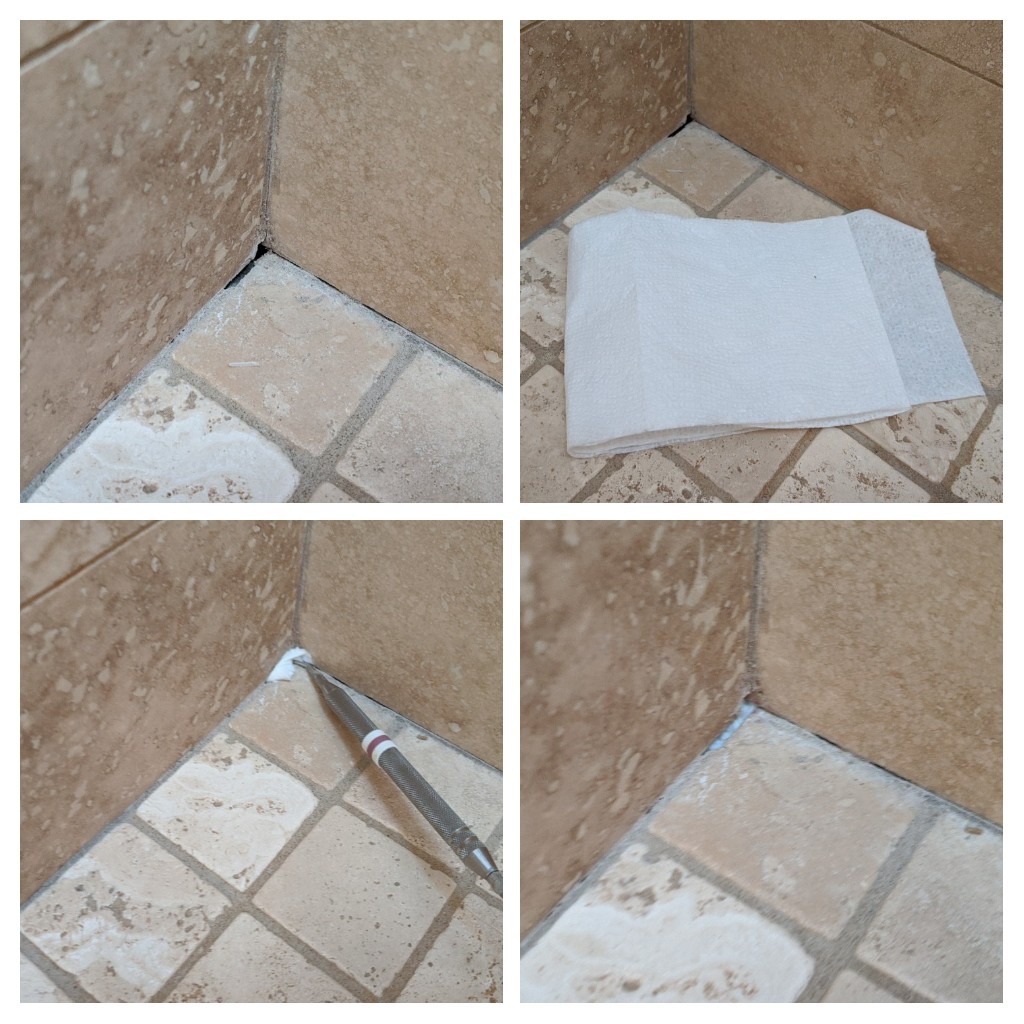

End of the world backer rod.

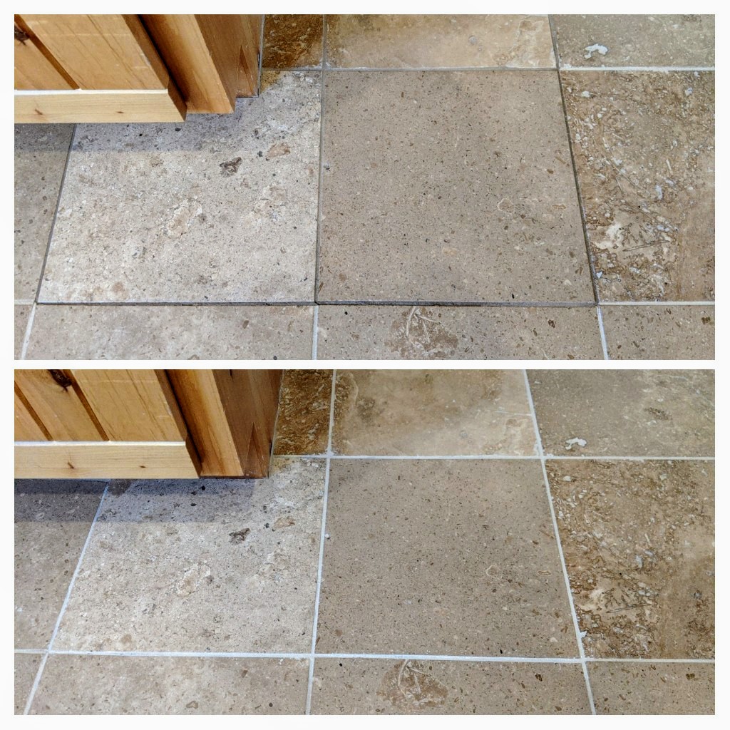

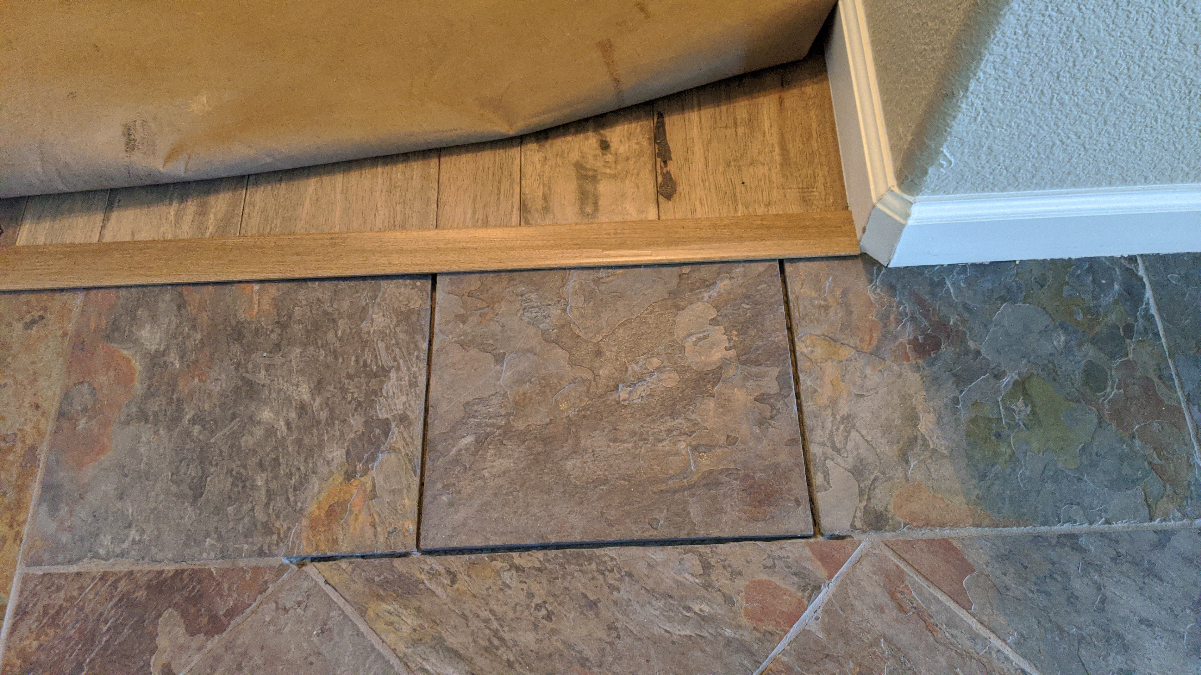

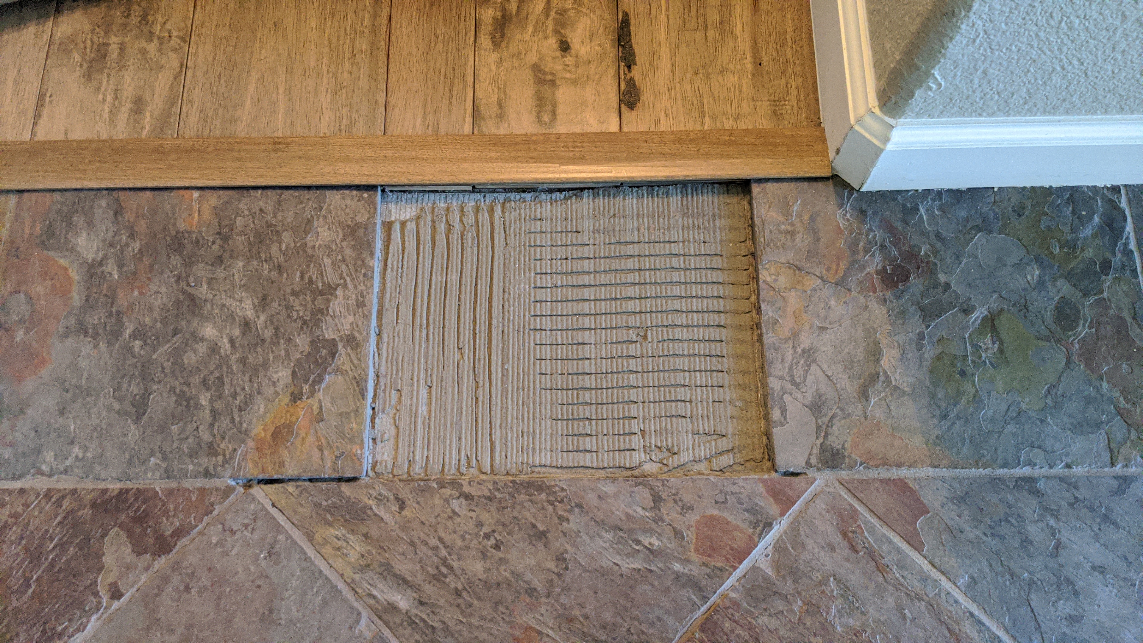

Same house..
handyman replace these two tiles and match the new grout that dirty old grout well guess what happened after I clean the floor...
SGA to the rescue again

so paper towel as a backer rod?
IMHO over complicated the missing grout repair. just use prism grout- done

Same house..
My question is why do you it's necessary to use SGA for that situation? Does it break frequently?
more complicated?
customer has grout in garage.
I have SGA in van.
done.
TP to plug holes so all the SGA doesnt fall into the Bermuda triangle
Prism is a matsa cracker compared to SGA

with prism grout- no grout shading, cures fast, 1/16-1/2 wide.
negs: will scratch polisheds stone, cost more,
