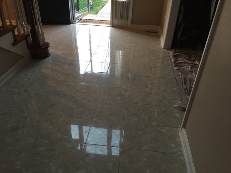

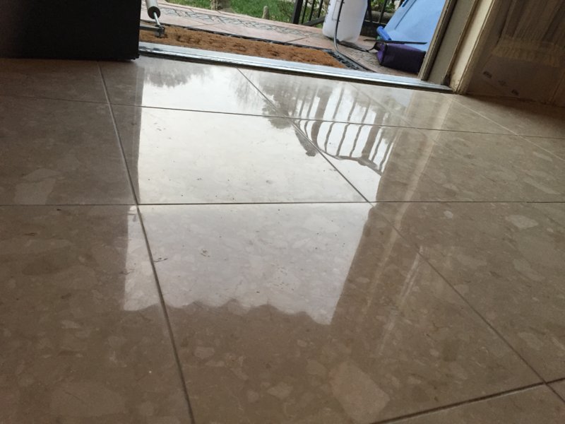

Using Cameron's disks and polish, we tackled our first stone floor today. Deep grooves, lotsa lippage and yet, a happy customer. $10/foot. Too bad I have to put it all towards the credit card debt we spent to learn how, hahahaha!
Old Coastie
Jun 29, 2015
7,504
Heart of Dixie
Stephen
Thanks Cameron, but I know you spotted the broken reflection lines and pillowing. That floor tilts every which way and the poor pads were galloping along like mad. We cut with the metal 120's until we were fed up and couldn't kick edges any more. I mean there were tripping hazards! It could use a whole day of leveling.
The door I remedied by putting heavy 3 1/2" screws into the top hinge.
I think I still want some 3500's from you, as once it was polished we could see very fine swirl marks. Andrew elf thinks they were made by dried, re-crystalized polish that we may have buffed over the floor. Does that happen?

Looks good. Yes compound if allowed to dry may leave fine swirls. Often you can not see it even when you think it's dry, then bamm, where did that come from...
Also if you have wind coming in from door can accelerate
Often shirt water and wet to dry will get it, or use mb12

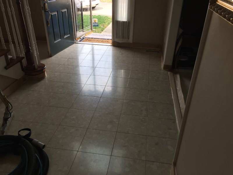

Well, polished with a new white pad, we sucked what we could and triple-mopped it. There was a faint haze left. So, we used a bonnet to buff it up, followed by a new white pad.
What I meant by crystals looked like sea salt where polish had been sitting in the corners and in spots that didn't mop. They sort of popped out of the edges. I'll have to dampen some powder and then let the polish dry to see if it happens again.

when you're polishing you area, check the polish as you go. When you get the shine you want, add more water and do a few really wet passes. This will break up any drying residue and eliminate any swirls that may occur, then vacuum right away and you're good.
The pillowing is normal, every floor that gets refinished with diamonds will have some sort of pillowing, unless it's ground flat. I think you did a good job.

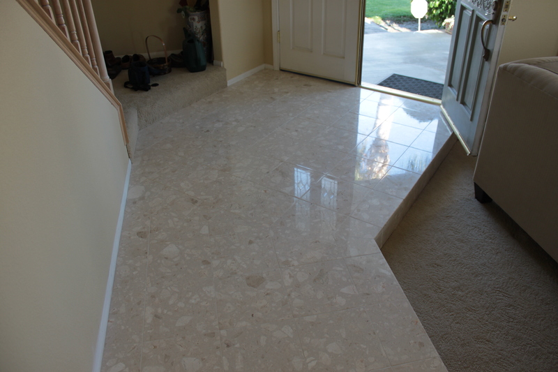

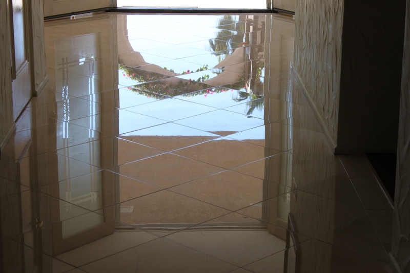

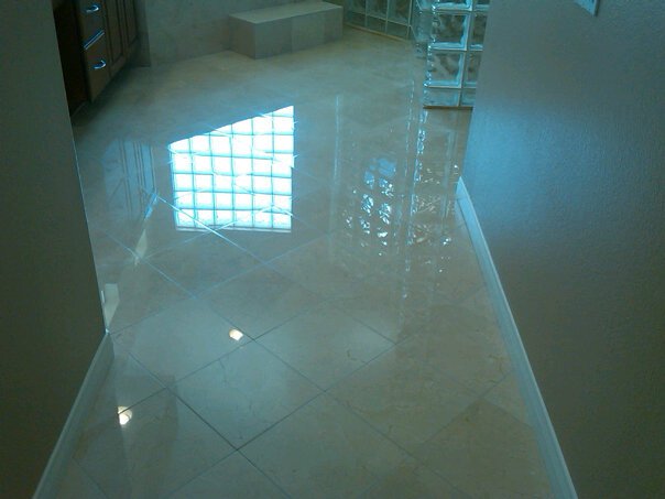

This is a weird agglomerate from Italy. It has a broken polish. Here is a floor I did with the same stuff. We replaced the grout in this one too.
You can see there is a lot of pillowing here too

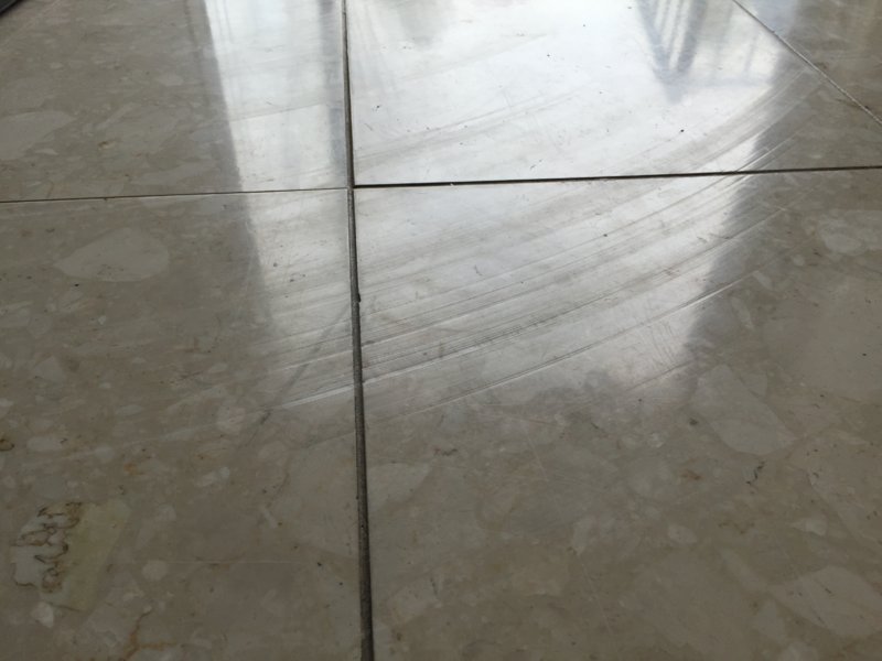

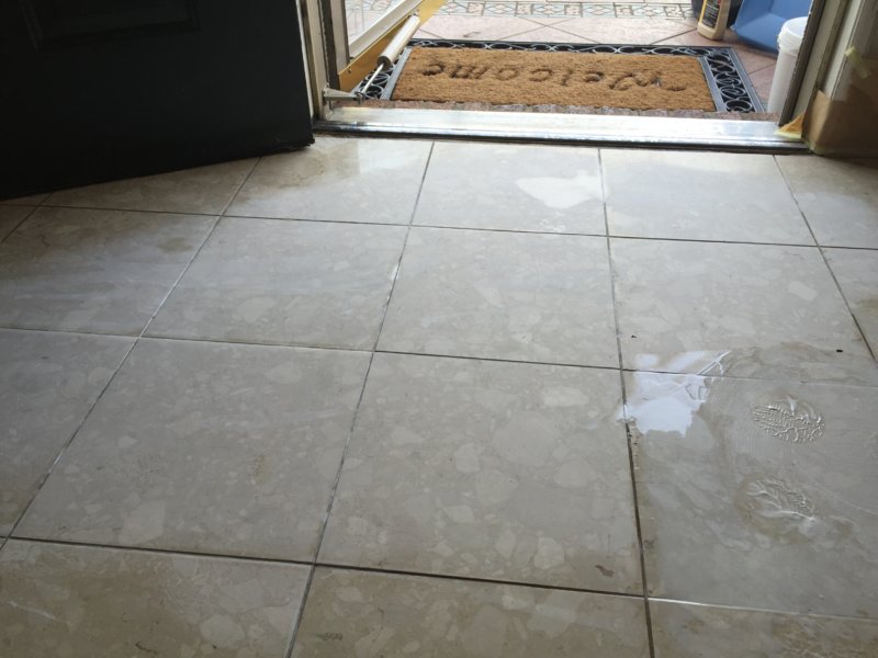

who or what caused those cuts?

Those are drag marks caused by an age-hardened, stiff plastic sweep under the front door. I pulled the door up a little by installing long deck screws in the upper hinges, but also told the owner to get a man to change out the sweep.

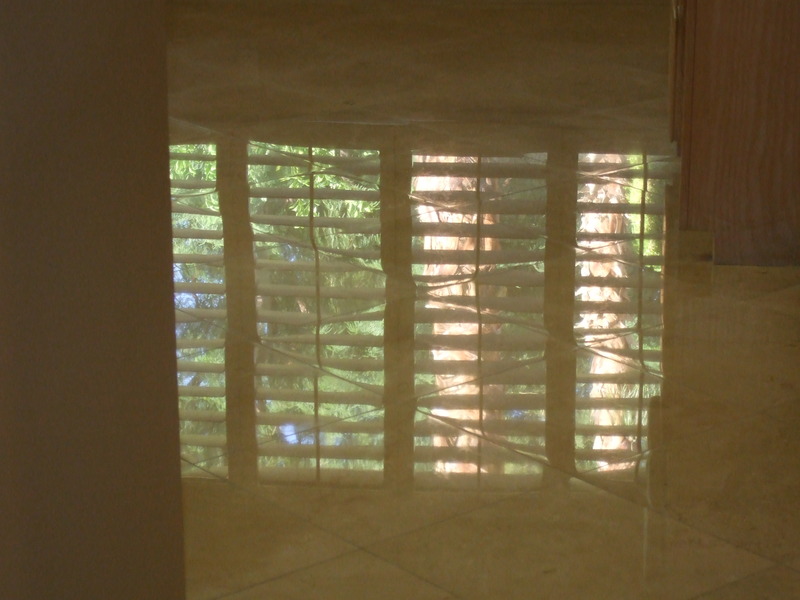

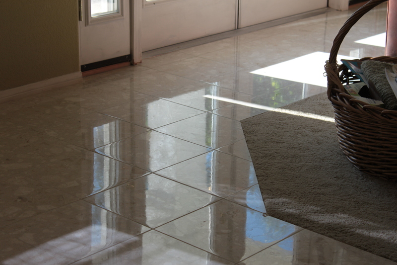

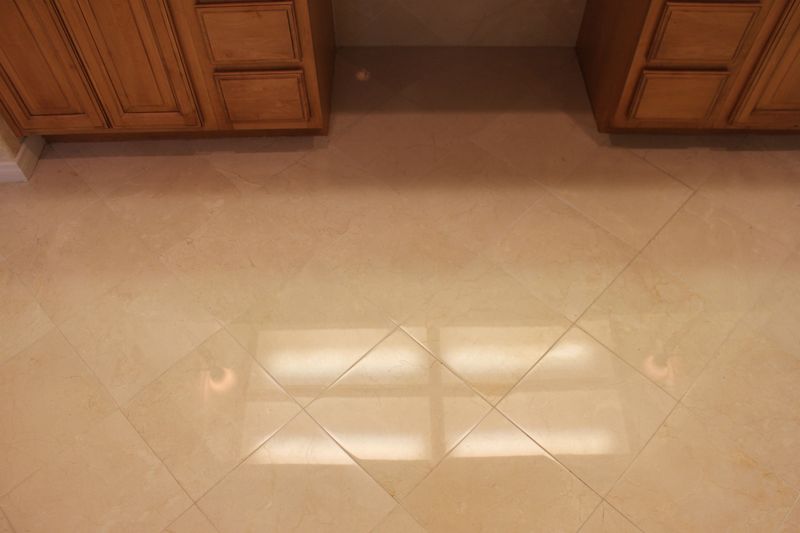

Here is an example of pillowing, notice the edges of the tiles look rounded. This is inevitable when refinishing without grinding. It's not as bad as it looks though, the human eye can detect quite a tiny amount of light deflection. I have never had a single customer mention or complain about it.
This is a severe example
This is another bad one
This is typical
As is this
