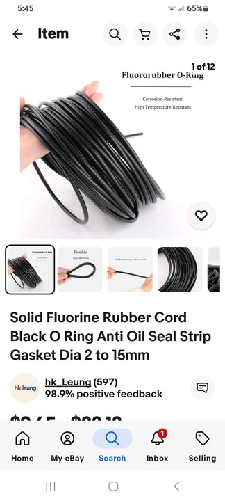

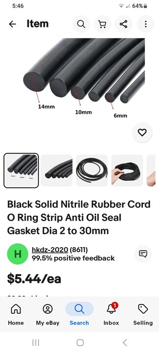

The problem with silicone is youll be gluing them shut and if not impossible it'll be nearly that to open them again. Can you put an oring around the top? If so you can buy oring material and make one to fit. You.order the diameter of material and length then cut to size, glue the 2 ends together and presto you gotta custom oring gasket ( if that'll work in.this situation)
