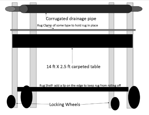

Dan wants a table made up that the guys can wheel in and work on fringe on. Maybe waist high, 2.5 foot depth and 14 ft long with locking wheels. storage shelf on the bottom in case the move the rug around the shop and a clamp of some sort to hold the rug in place while they work on the fringe.
Is there anything like that available? If not what are you using?

I think he wants something like this:

I did get the design wrong Dan wants the table and big wheels but he wants the rug to be folded so they can clean both sides at a time without unrolling the rug. :icon_rolleyes:

He was 4-cart tables, 7-ft long. He wants to be able to lock two of them together for larger rugs and apart for smaller. This way they can roll the carts on each side of the rug, pull an end up and work on one side flip it over to the other table and hit it then drop it and repeat the process with the other end. :oldrolleyes: He's on a mission, he has been back there all morning measuring and fooling around with rugs and asking questions of one of the rugs guys.
