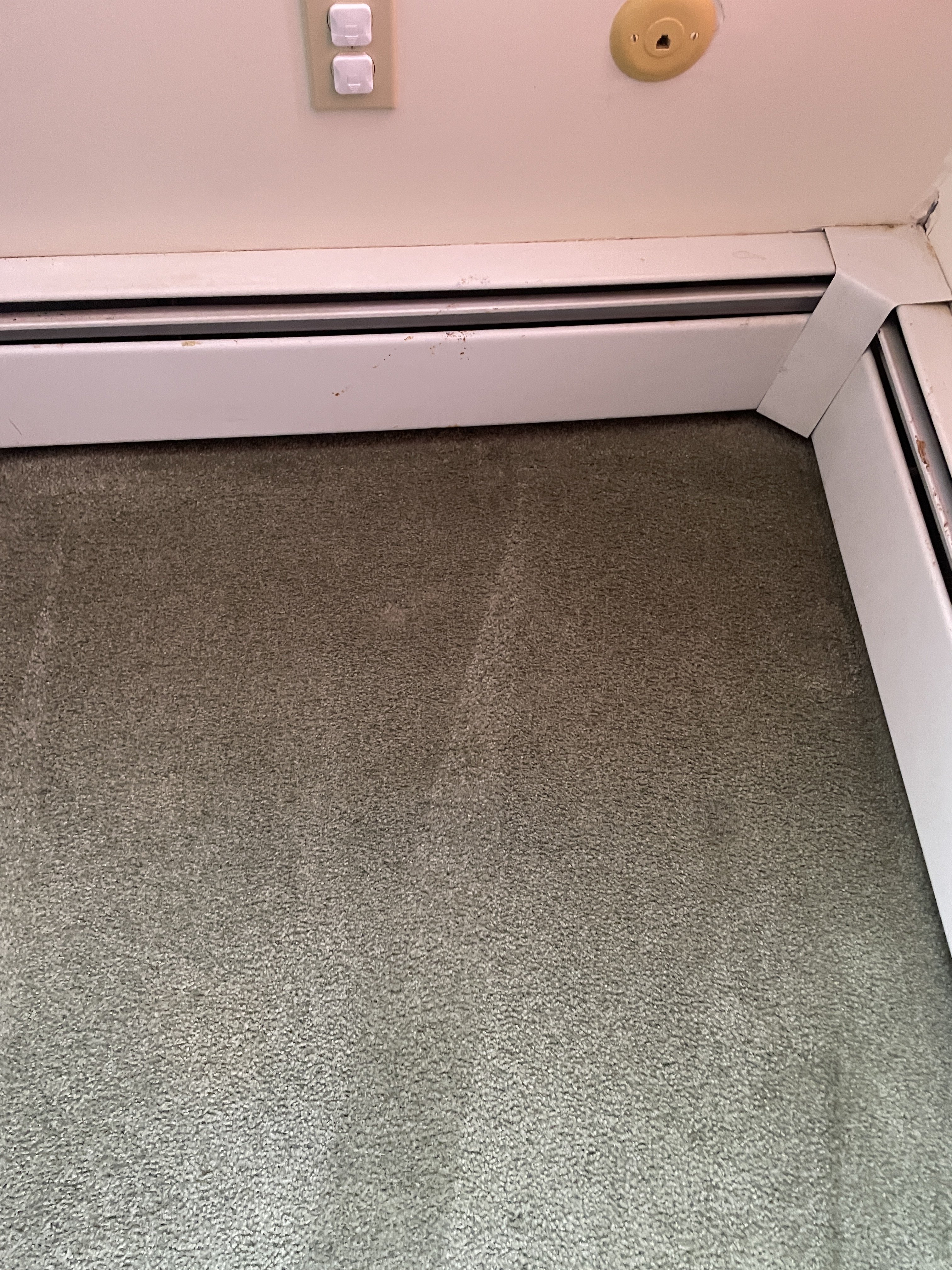

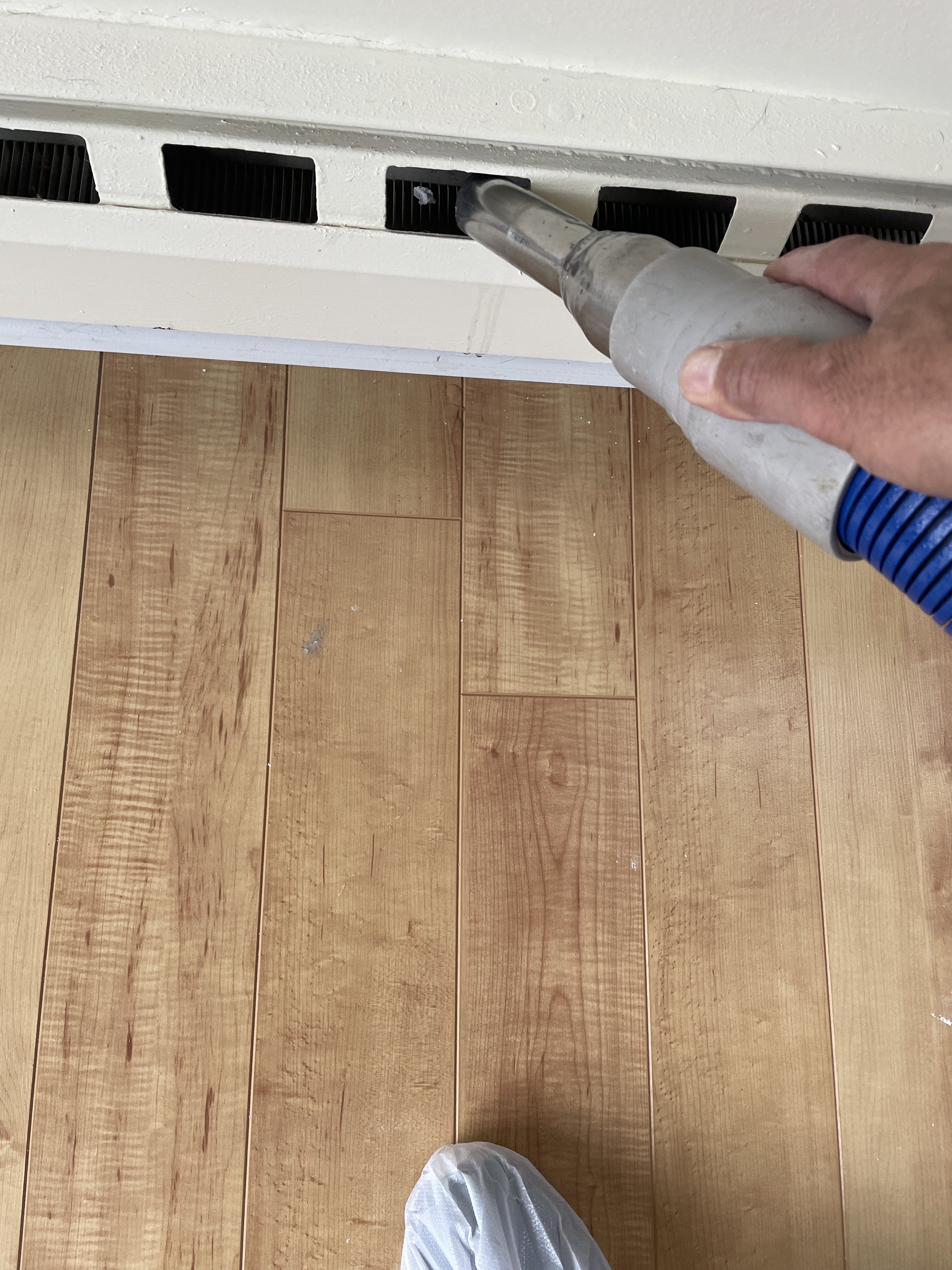

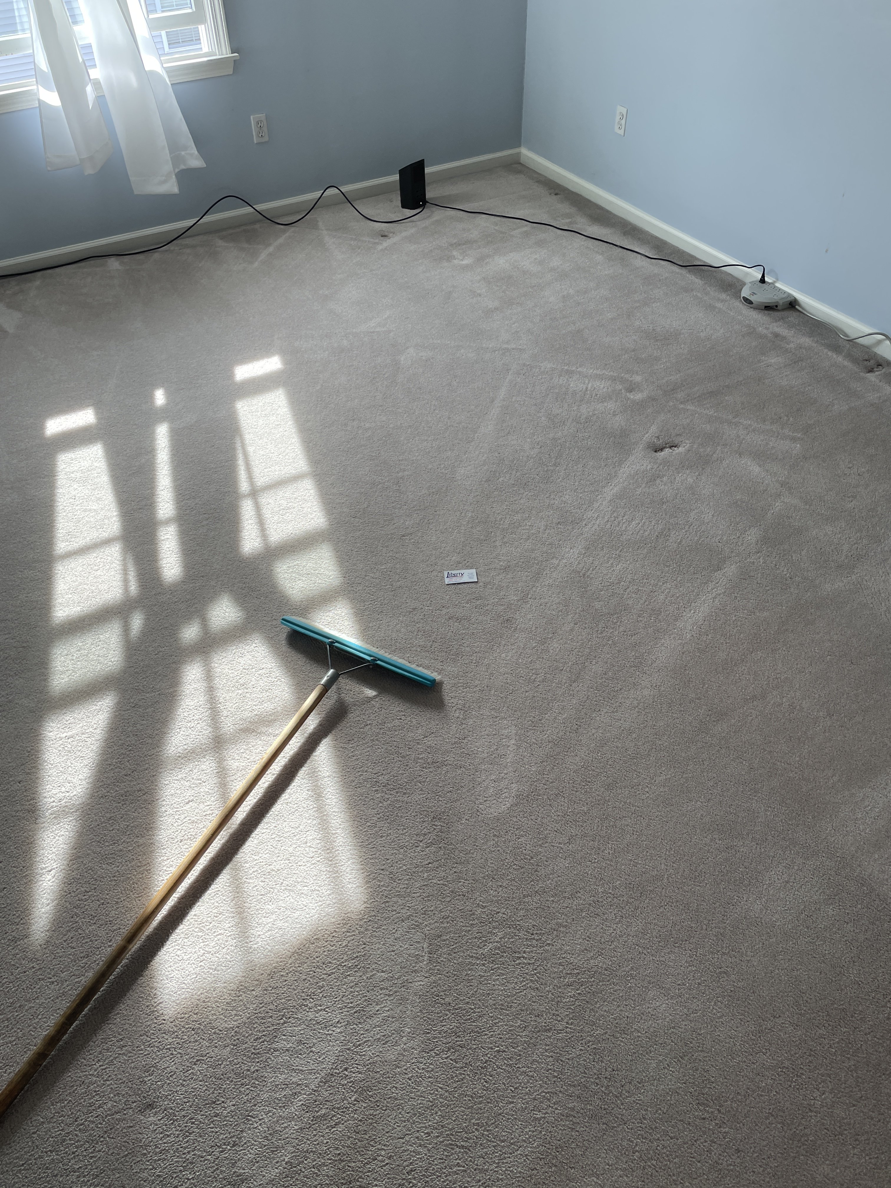

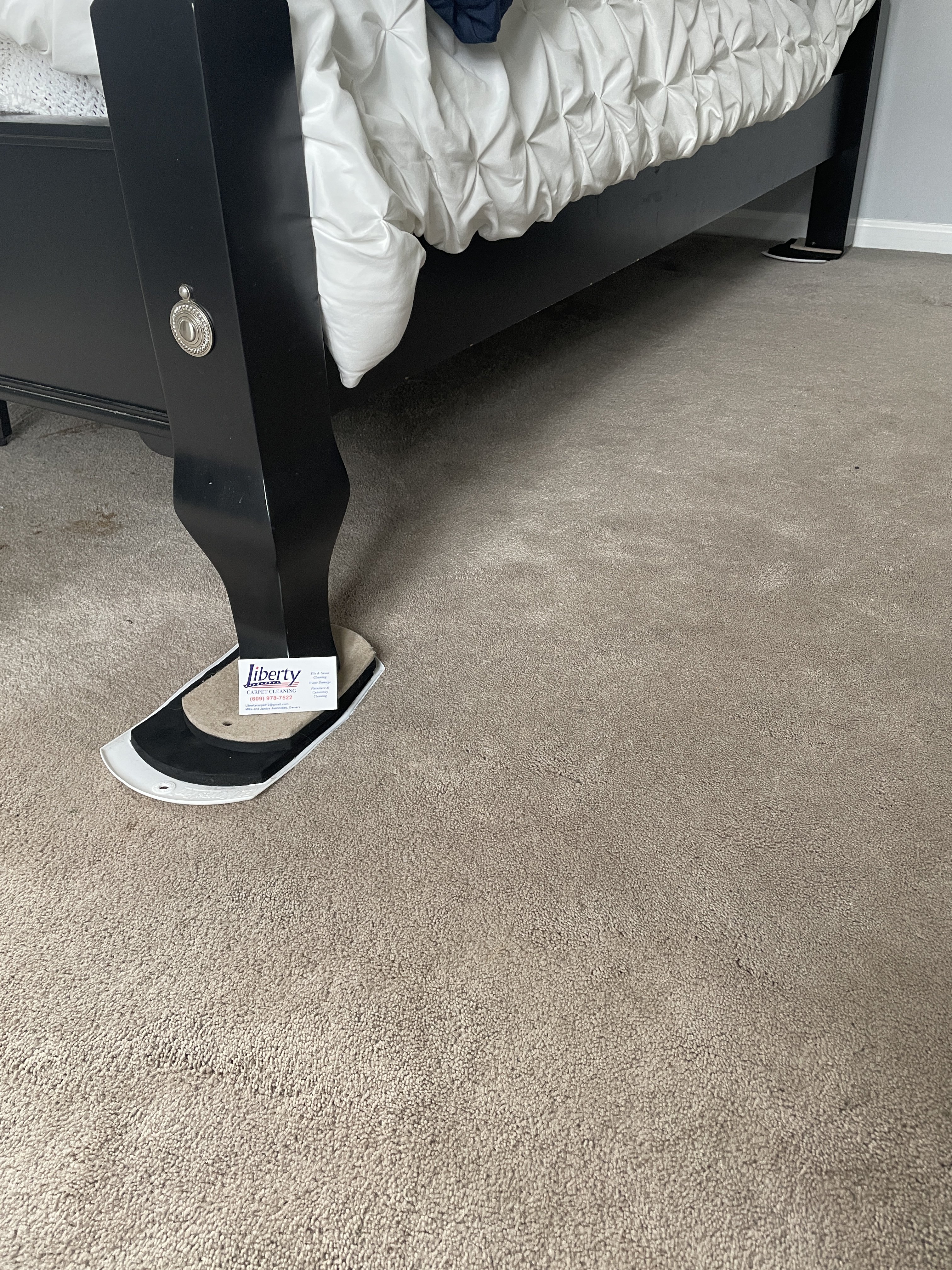

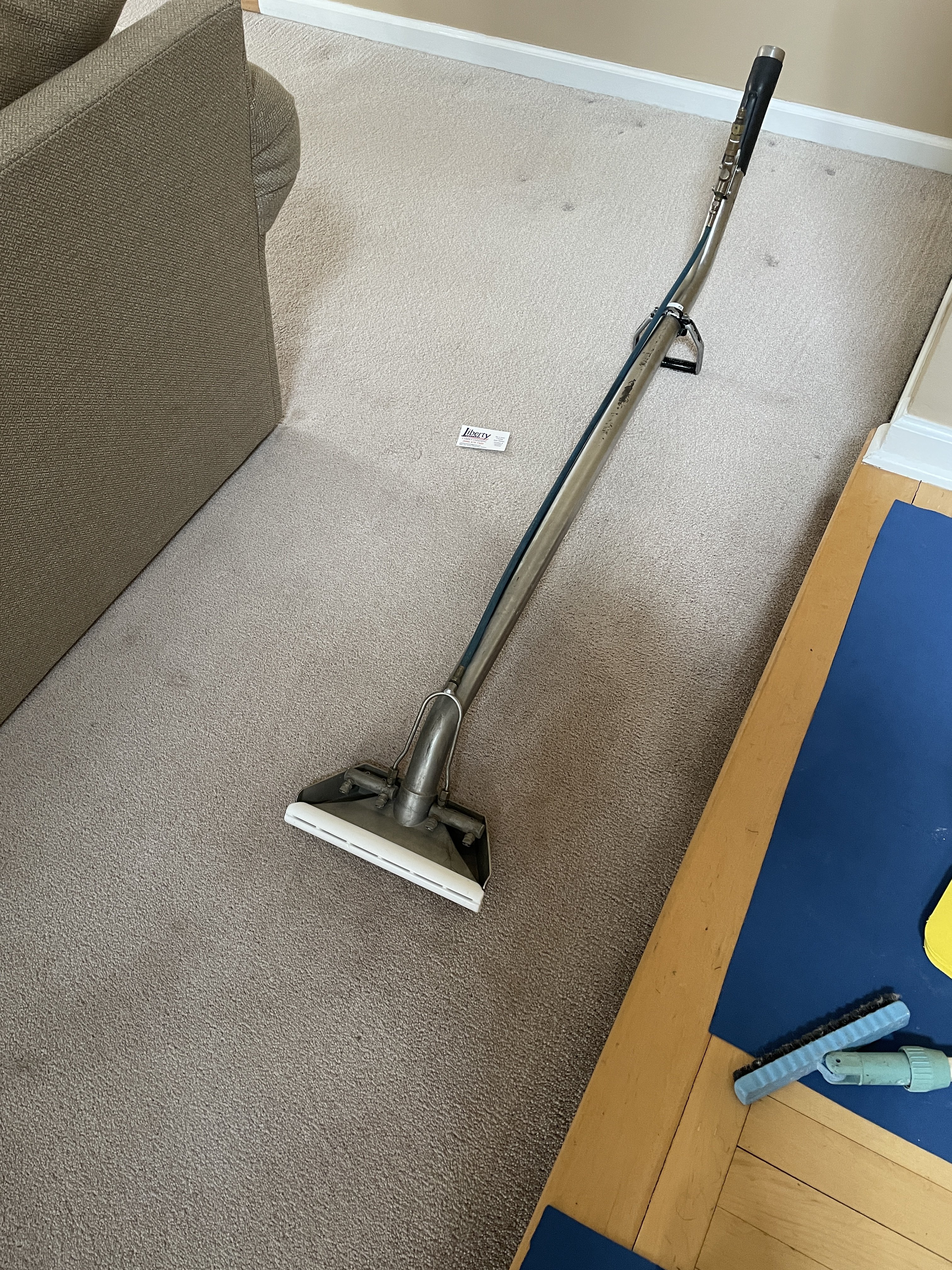

No, that came from the corner hutch that hasn't been moved since 2017. They were on the top shelves. Keep in mind, they were put back in place before I even brought hoses in. There was no water around. This was all to vacuum.
Once I properley vacuum, all those pucks are back exactly where they go. Then I HWE and dont move a dang thing. By the time I set up hoses, Im done with all the moves. I havnt had to disconnect my wand to suck up a bead in months. I vacuum, dust, replace, then clean like an averager good carpet cleaner. Its all in the prep. That is why I pad now too. I vacuum so good, HWE or VLM just makes it look good.
I only do high end now. I am leaning towards a $1000 minimum, because thats pretty nice to just do really good carpet cleaning in one house for the day. Long, short, it will even out. No rushing anymore is the goal. Its not worth it.
One man can do with his brain, what 2 men do with their backs. IMO
This is where the glassware was.... It was safe, but awkward to move. ez.
it was on the very top shelf, not to confuse you, not the best clip, self filming kinda stinks. My vacuumer is gonna have to be camera savvy.....

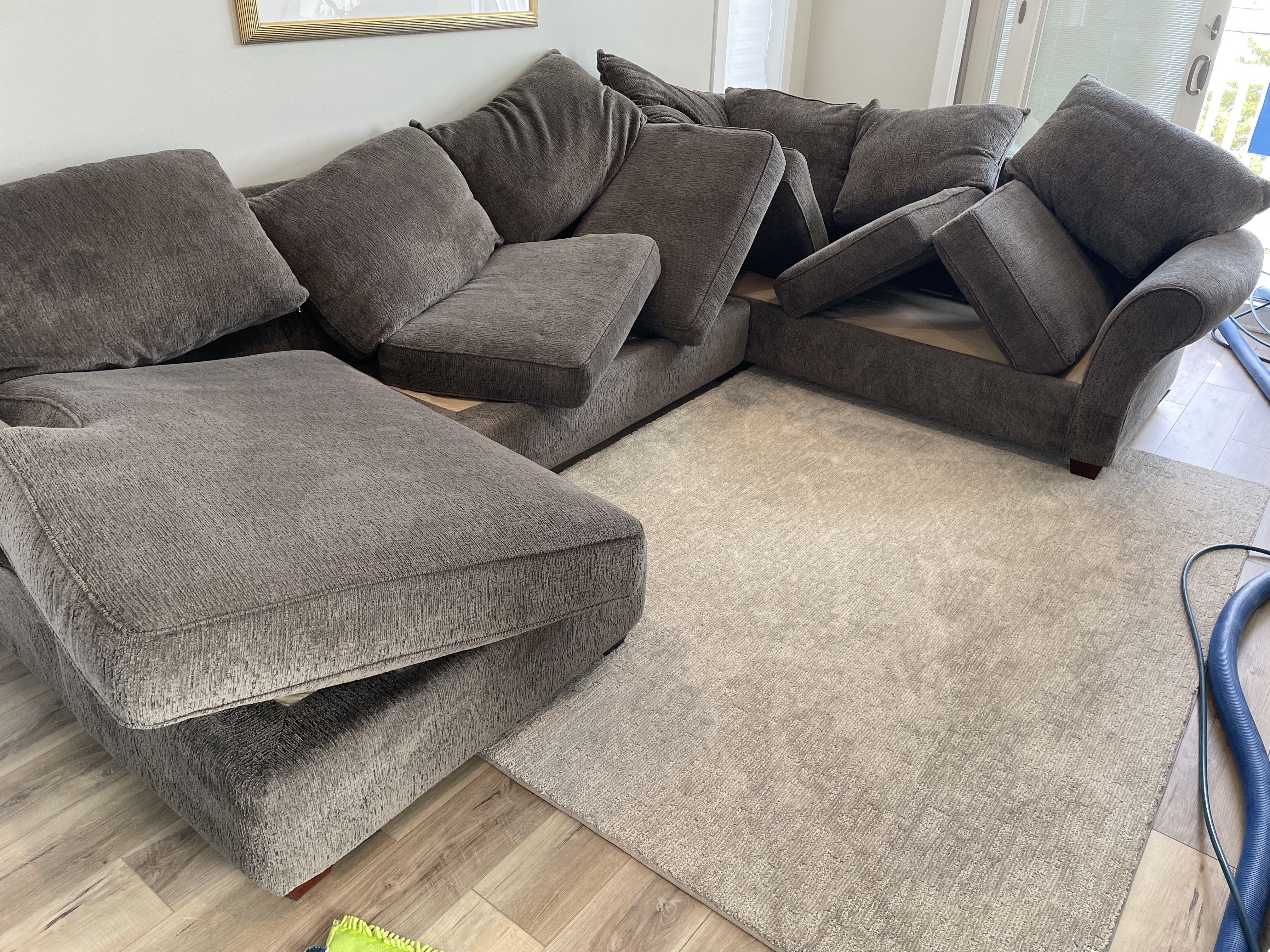

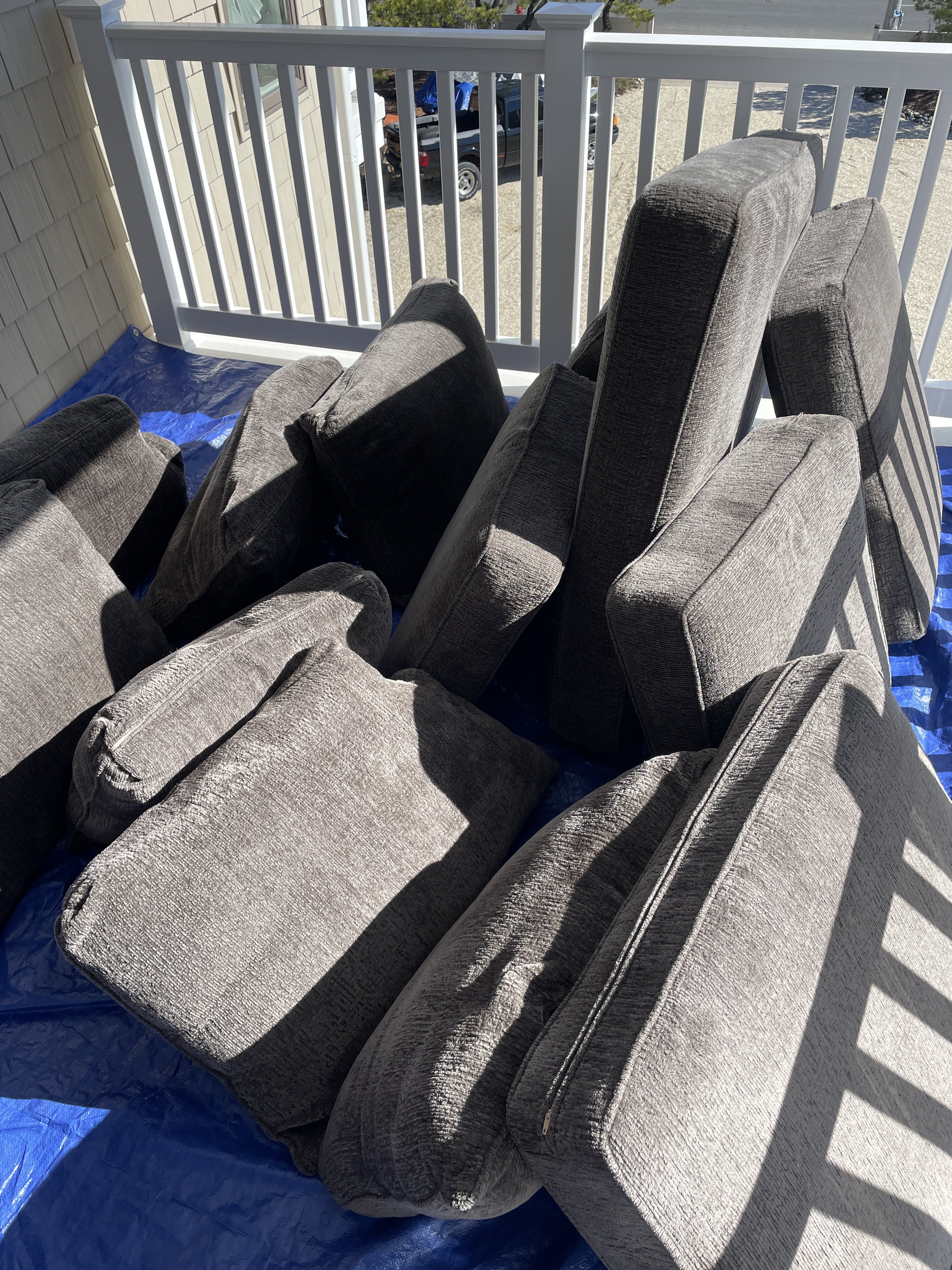

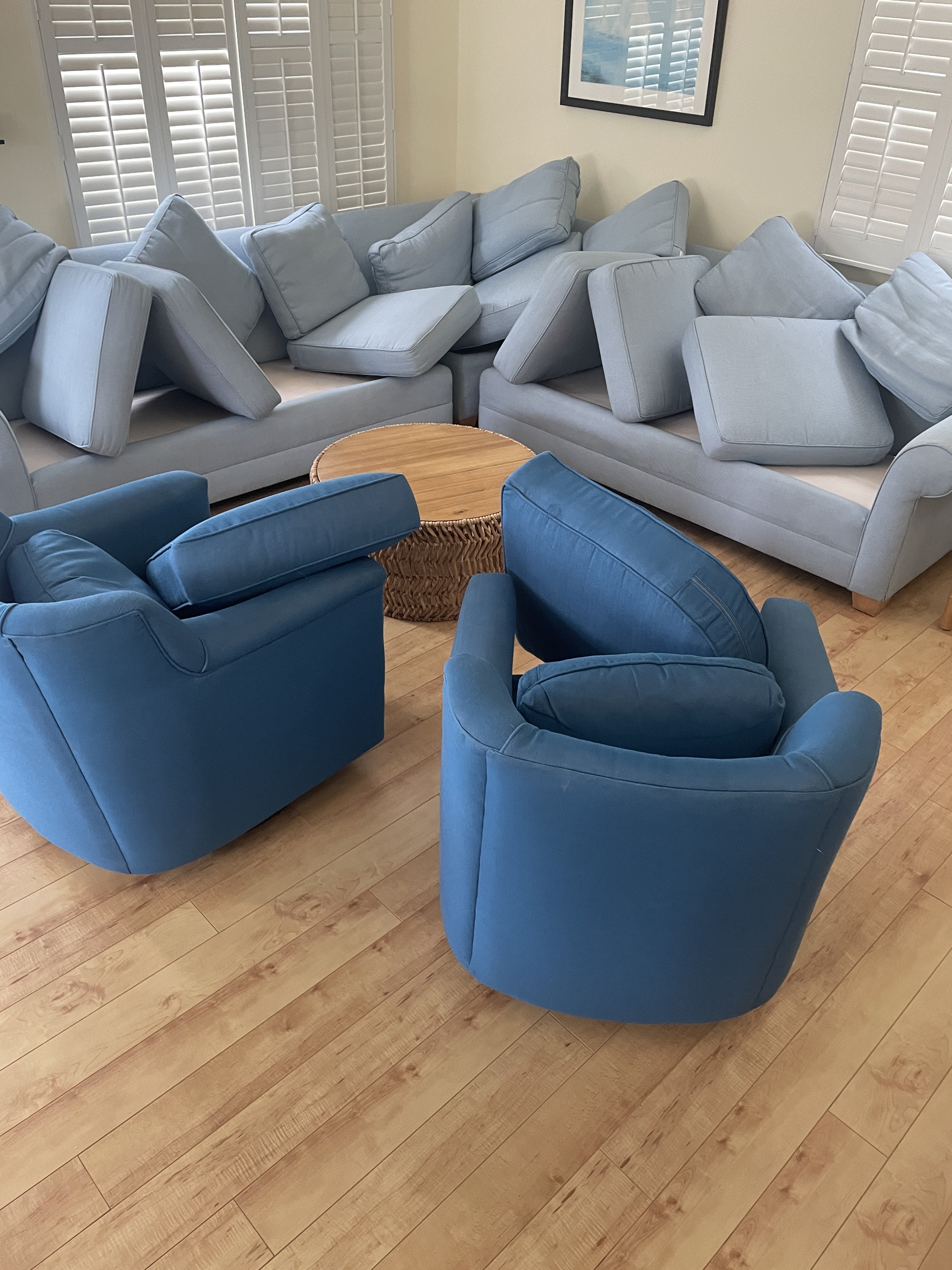

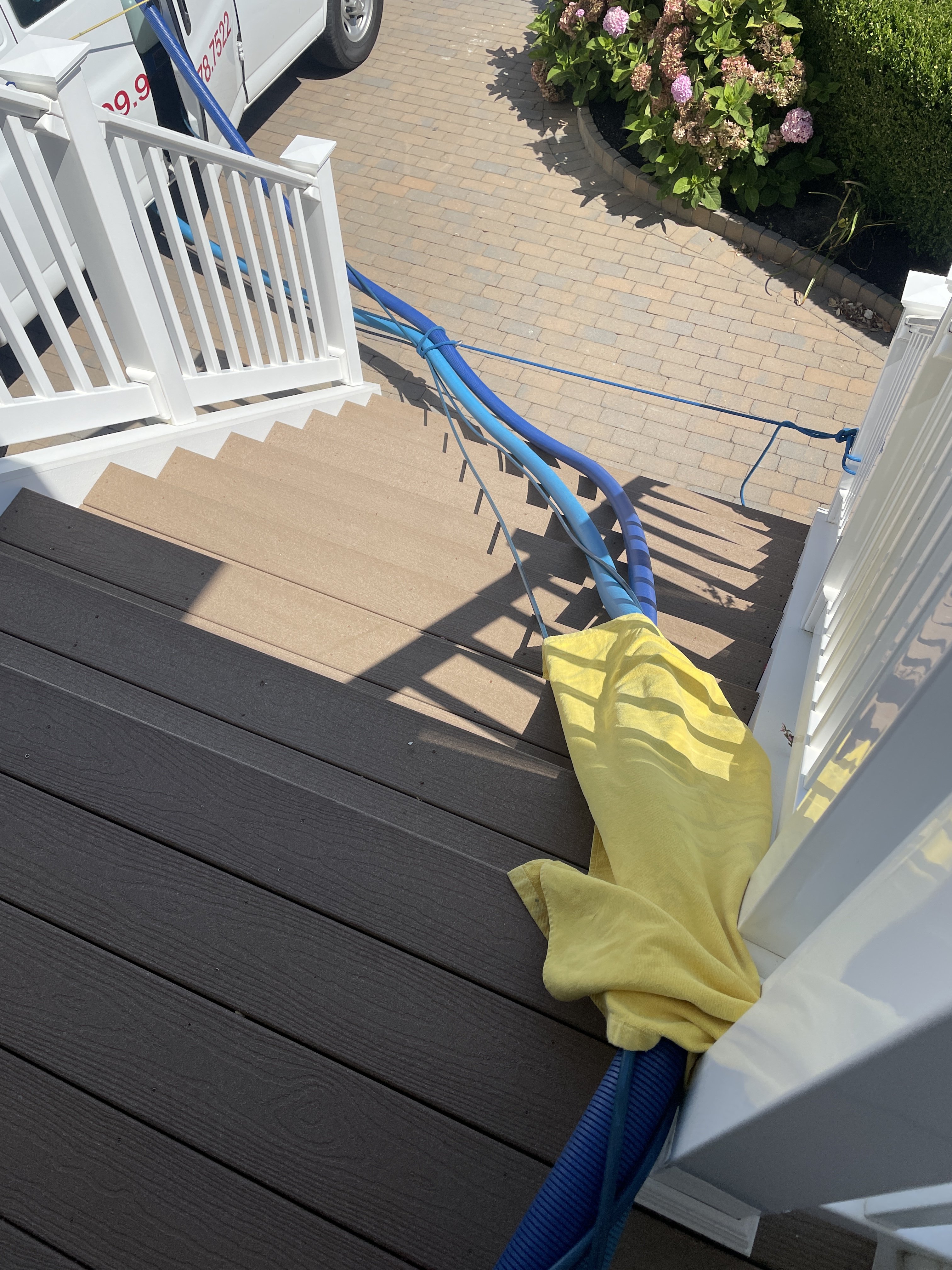

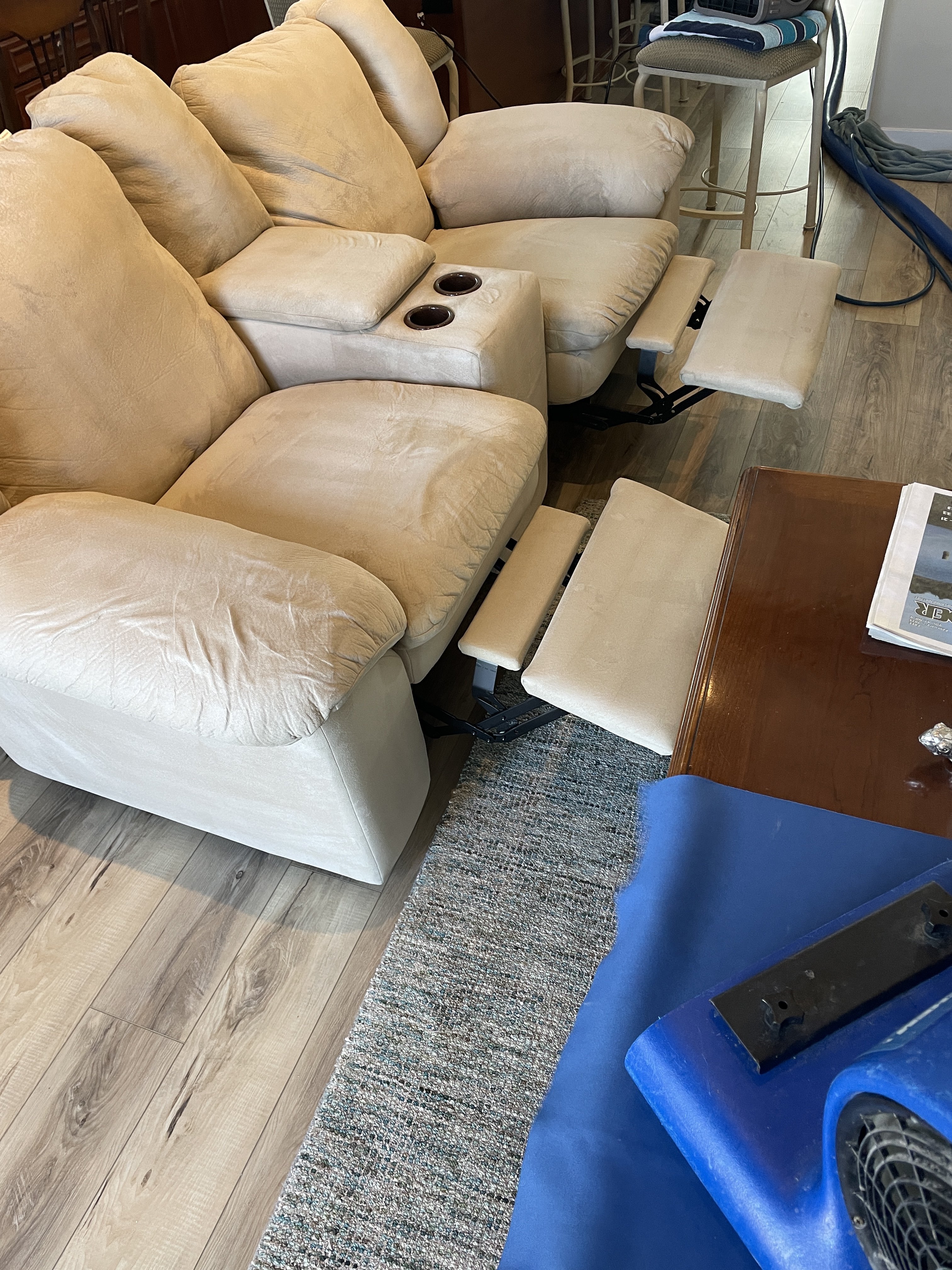

This was hard to figure out the how to slide everything one time only and move on..... Almost did it.
This was that house that I gear tied to the stand and got a ticket, and just roasted. So this time I listened and did not do that.
I'm learning now....
These are not puck sliders, that's for sure. You must have instant gratification by helping customers like they're family members. In my eyes it's honorable thing to do, I'm only hoping that your altruistic approach is not hurting your bottom line.
Im learning now....
you don't ask the homeowner to remove breakables from furniture you're moving???:headscratch:

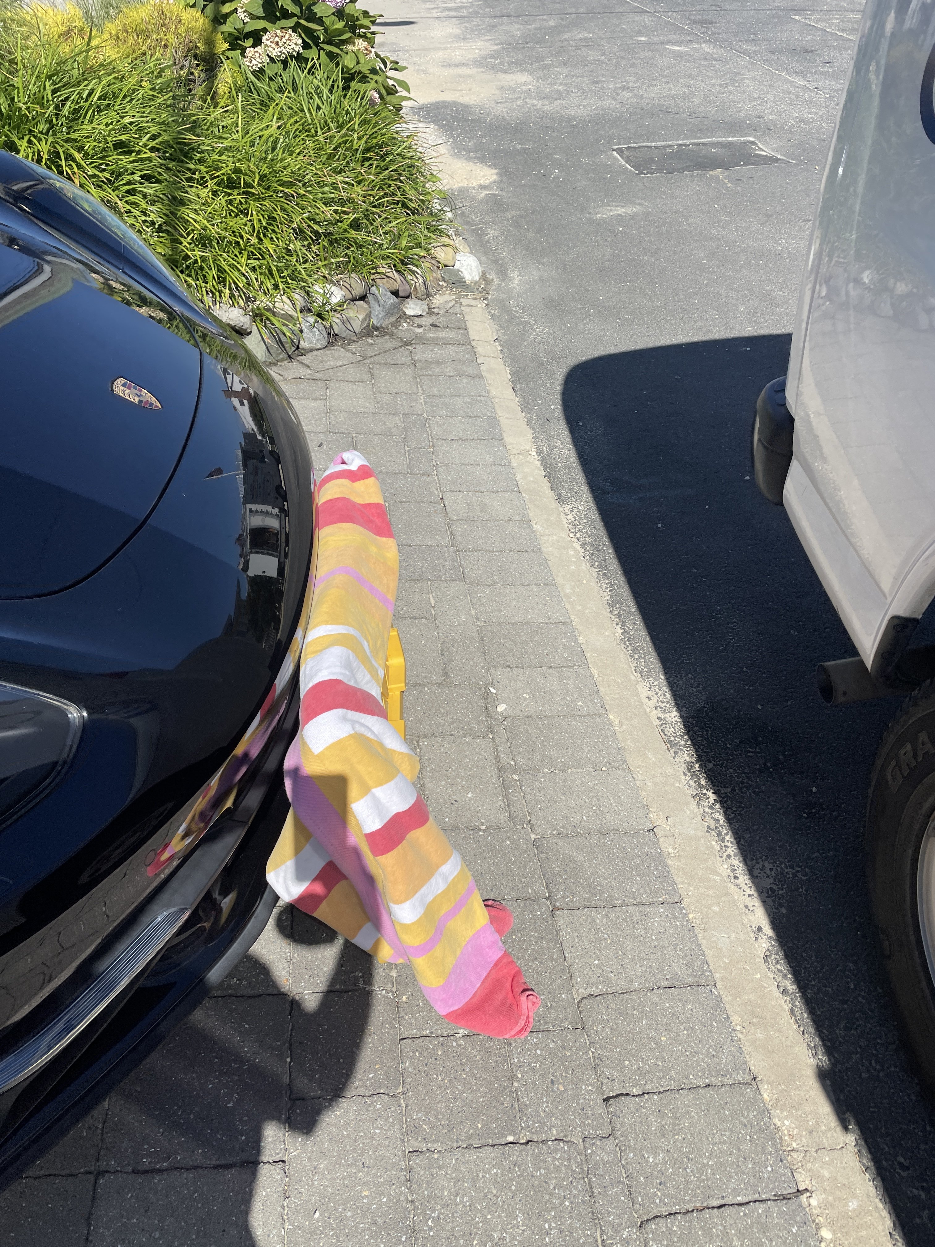

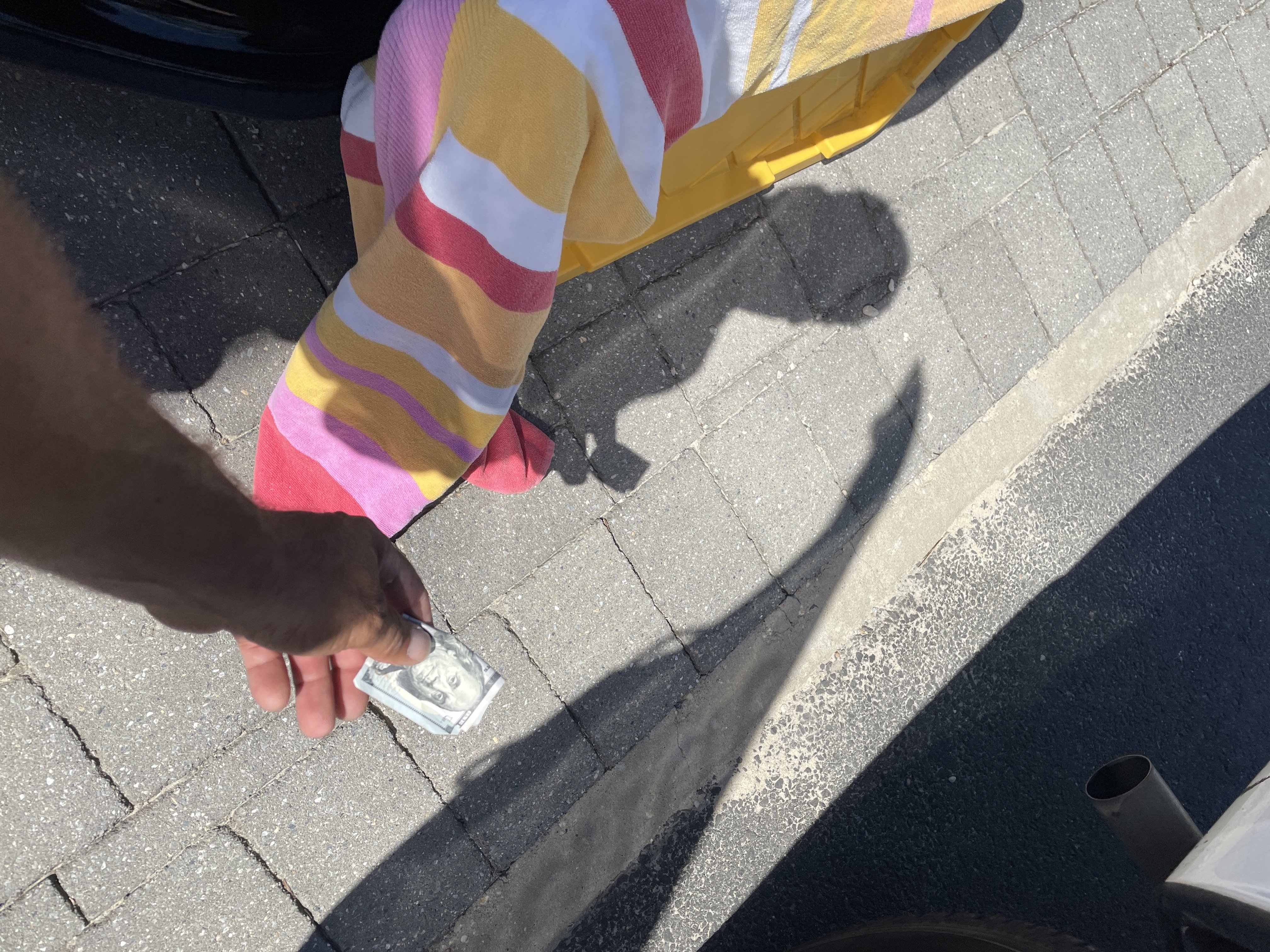

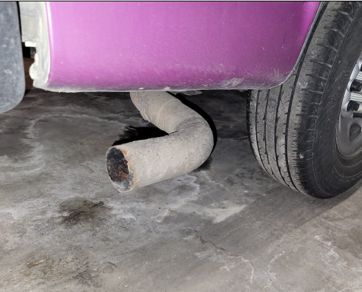

When people see we go the extra mile to take care and respect their nice homes and belongings, they always appreciate it. No other place to park, I felt my exhaust was a little close to the car. put up a plastic shelf with a towel so I didn't cause any problems.
House was treated just as well, and this was the tip.
Super nice people too, not what you would think. People love a step above mediocrity.
I personally like to go 1 mile less. I would have parked as close as possible and smoked that Porsche up with fumes 🤣🤣 jkjk. Nice work man!
