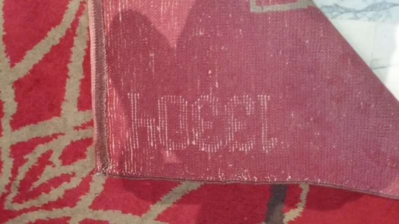

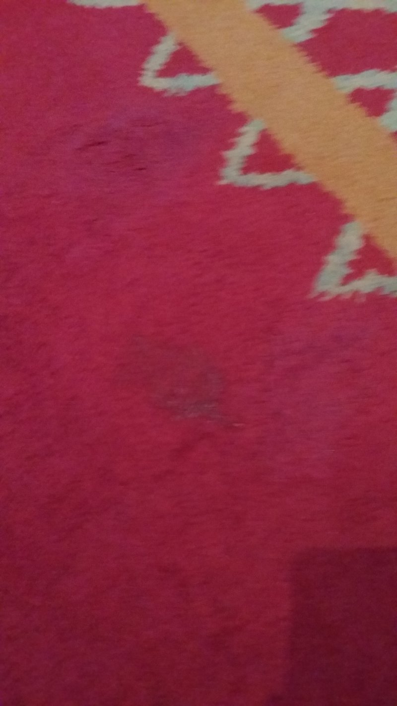

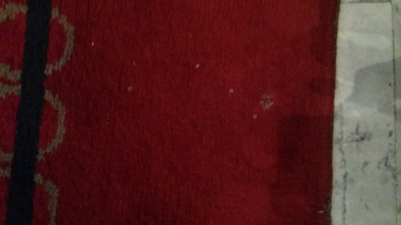

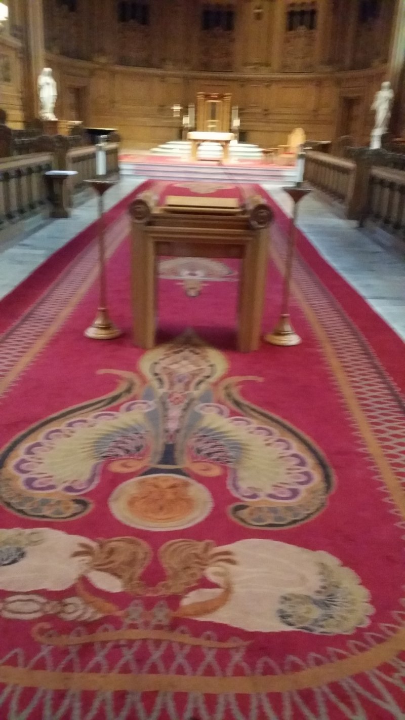

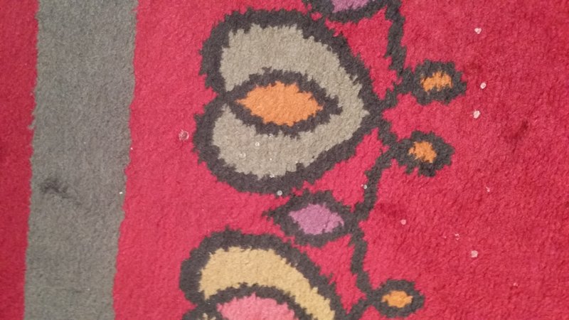

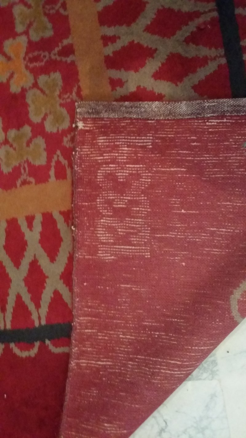

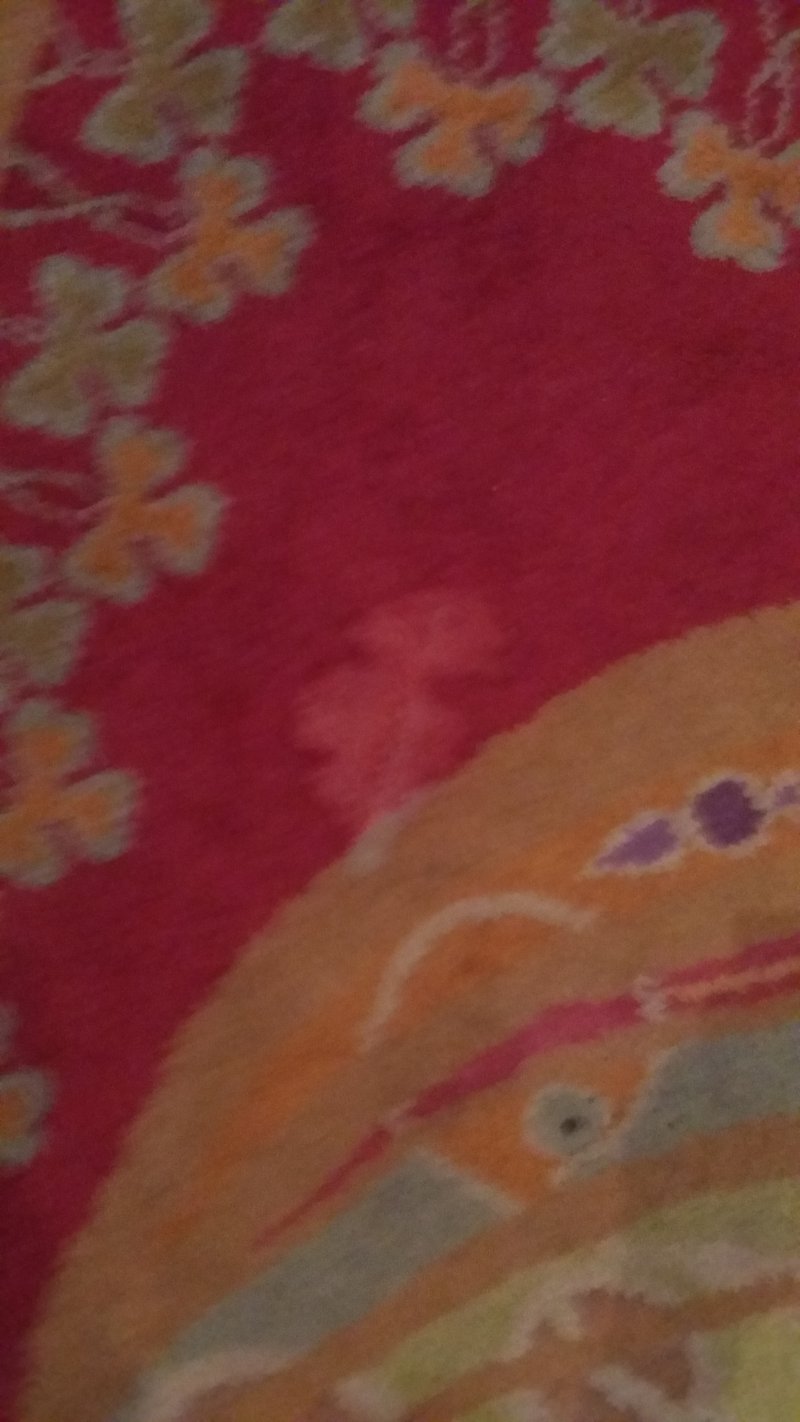

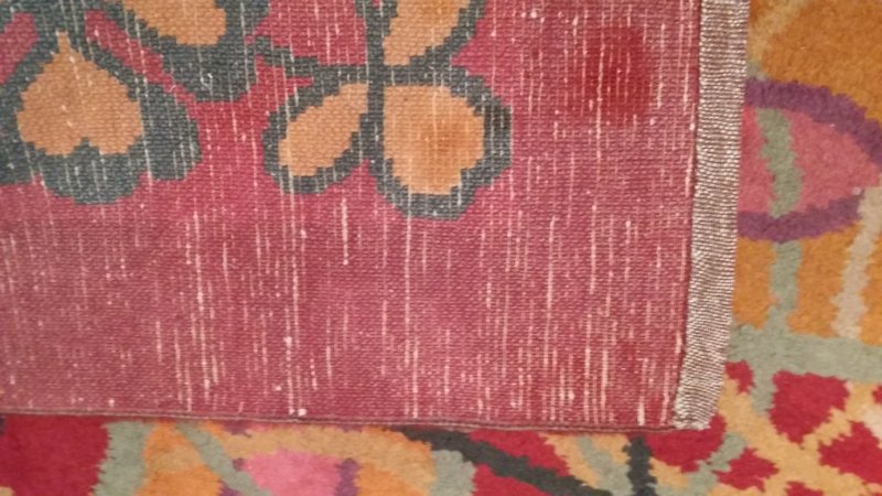

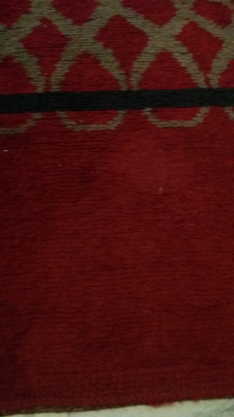

I showed you a hint of this a few weeks ago. Upon seeing it in person and doing some color billed test, which it failed within seconds (red)
I see no other way than a thorough back and front Sanitair'ing and VLM with our 20" brush Pro and Compound agent from Carpet Cleaner America.
100 plus years old and no one alive knows if ti's ever been cleaned before 70 plus feet long so no local shop can handle it.

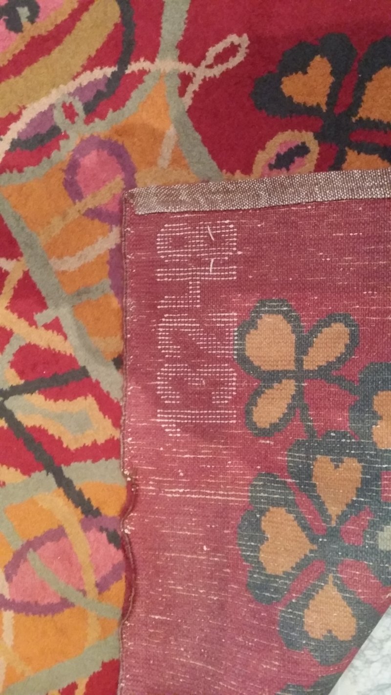

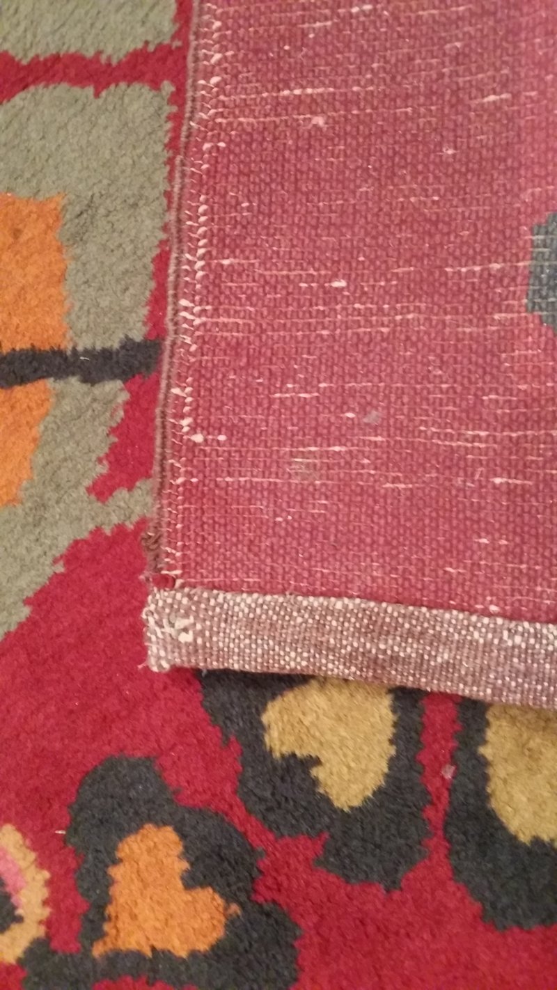

How do they get those numbers to show up on the back but knot the front?

What did you test with for colorfastness? Make sure you test with your vlm compound. I have cleaned similar rugs cold water extraction. I wouldn't want you to do what I would do, that's a sure way to get into trouble but I would spray treat it first with a detergent free acid. (browning treatment or similar) then use cold water extraction with a good quality wool extraction detergent. You could sour that a little to bring the ph down to maybe 6. Any parts that were heavily soiled, could be shampooed with a 175 with solution tank using something like Prochem fine fabric shampoo. You could also sour this a little to prevent bleeding.
116,689
blotted with Chemspec One Earth 210 and Procyon and a white towel placed on top.
Cold water.
if those two cause the red to run that's all I need to know.
Compound and spot clean the obvious by hand

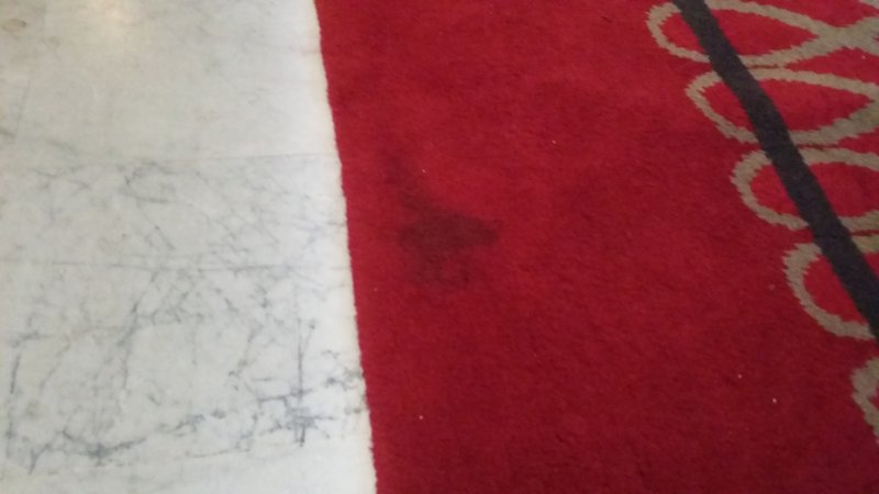

116,689
Talked to my son more about it today
Yellows bled too.
Black was stable but the others bled alomst on contact.

116,689
Hells Kitchen..
Ellen is a huge Host proponant.
this rug cant leave the premisis, in case you missed that fun fact.
