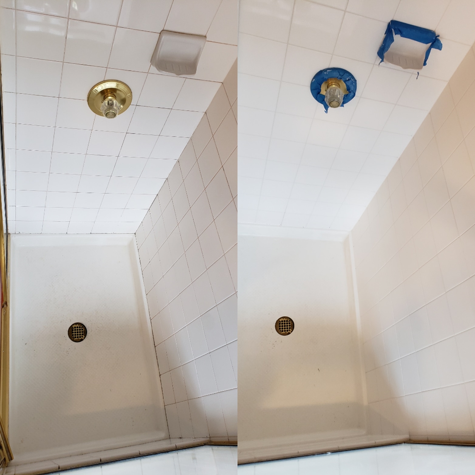

You dont need to wait with Gundlach on fresh grout... but we only use it to seal after cleanings. The grout we install does not need a sealer thats the whole angle we take on our regrouting jobs. We only use Perma pool grout, its 100% waterproof made for underwater in swimming pools. Nothing better out there for showers, this shower will never need sealing again
