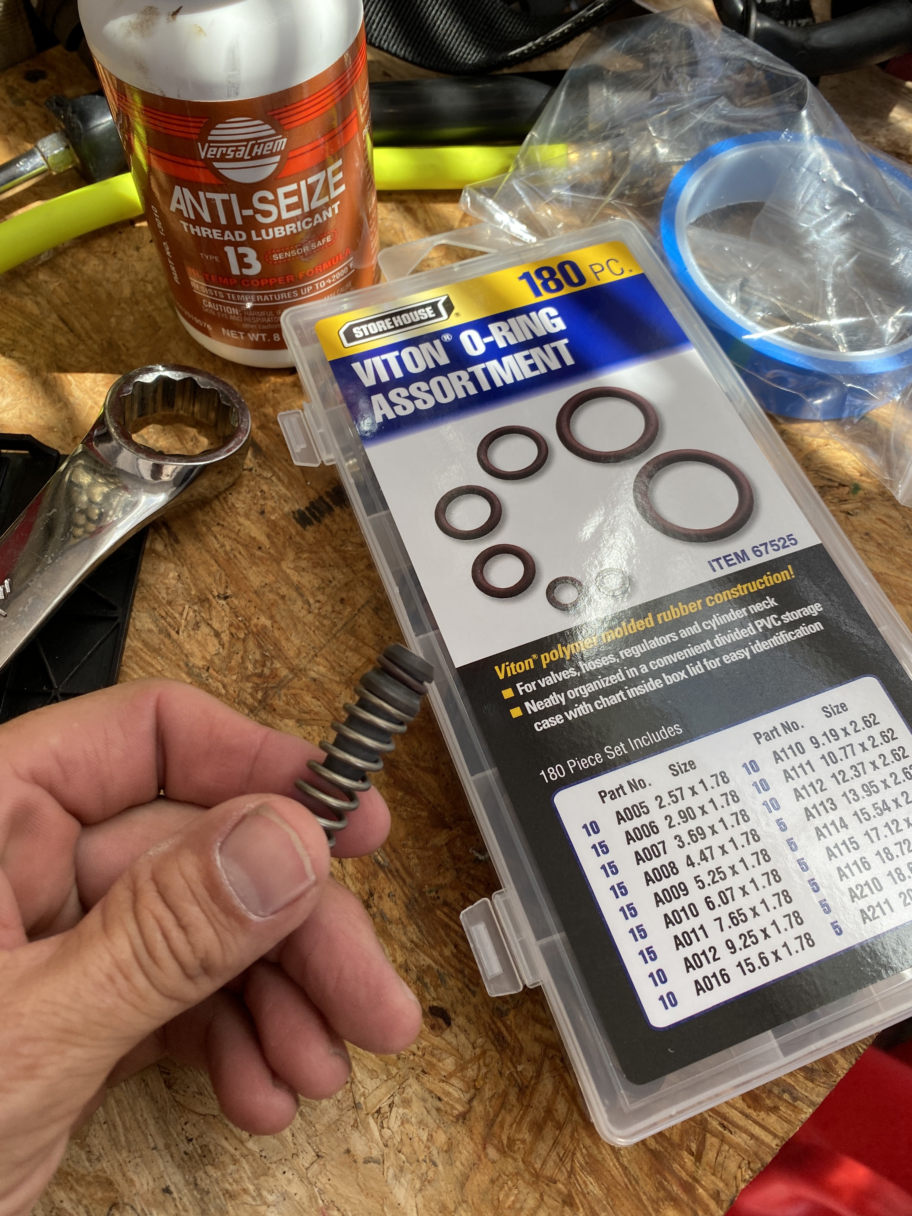

The temperature bypass valve on my 570 water box was pouring water into the waste tank today. Just with the water hose hooked up. Machine wasn’t running. Sounded like a cow pissing on a flat rock. Took the wax pellet out and the O-ring was torn. Got lucky at harbor freight with a replacement. Back to work.

They have the nitrile, viton and another type. Don’t remember. It was a green color.
