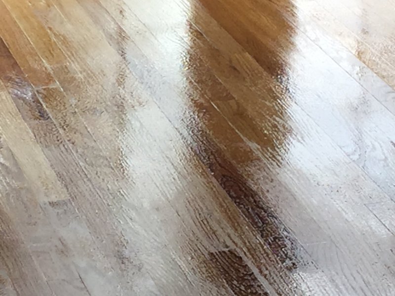

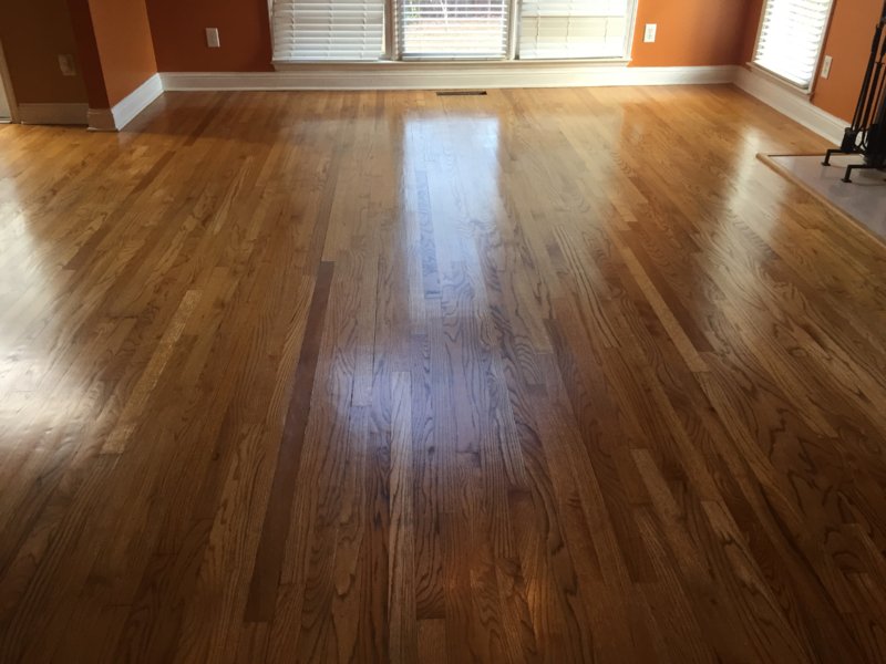

A room with the satin finish applied, looking quite nice. Same protocol as below, strip, rinse, seal and coat.
The sealant, drawing up. This is after stripping and maroon padding twice, with rinse and dry. I was down to the stain on the oak!
It is confined to this breakfast room. So anyhow, I just applied finish coats and it looks fine for a free "Dad job."
